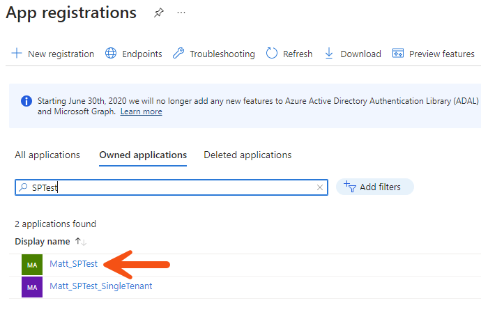

1. Open Your Single-Tenant or Multitenant App Registration in Azure Portal
Login to Azure portal and go to App Registrations.
Click on the app registration tied to your functional FME Form MicrosoftTeamsConnector web connection to access its configuration options.

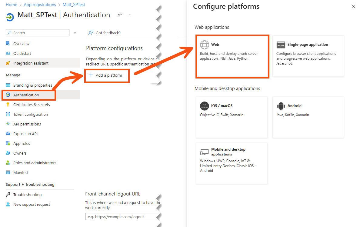

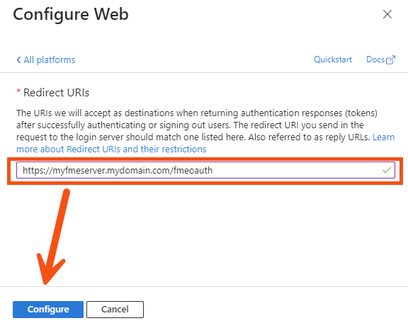

Click the Authentication menu at left, and then select 'Add a platform'. Choose Web.
For the redirect URI, enter your FME Flow URL followed by /fmeoauth. For example, https://myfmeserver.mydomain.com/fmeoauth. Note that your FME Flow instance must be configured to use HTTPS.
Click Configure.

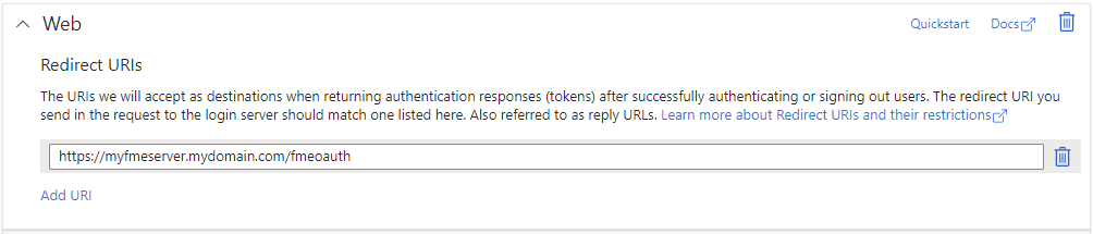

You should now see Web added with the redirect URI. You can add additional redirect URIs for other Instances of FME Flow that you plan to use with your MicrosoftTeamsConnector web connection.

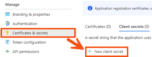

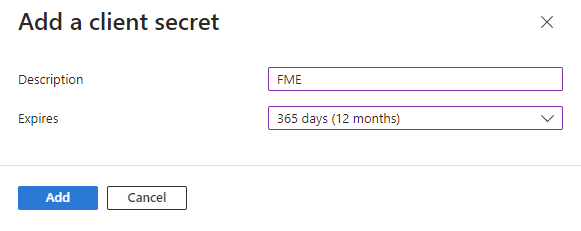

Click Certificates & secrets from the left-side menu, and then select 'New client secret'.
Give your client a description of the secret and its expiration date. Click Add.

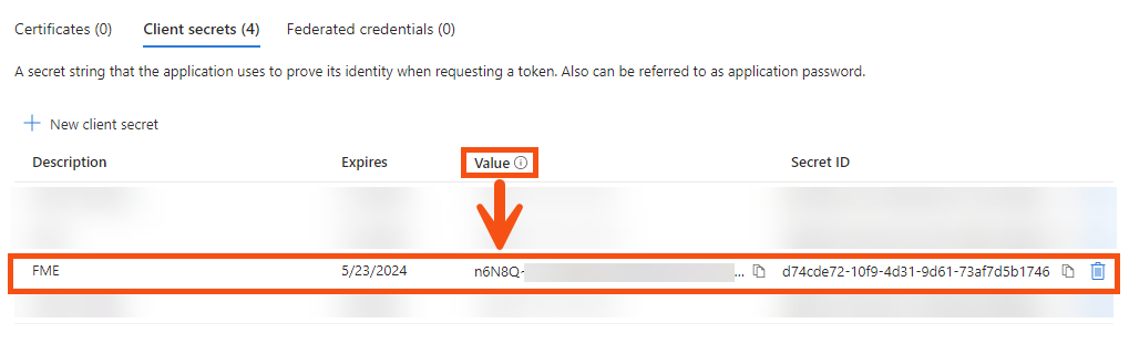

Once your client secret expires, you will need to create a new one and update your FME Flow web service with the new Client Secret value to continue connecting to Microsoft Teams.
After clicking Add, make sure to copy the secret value (not the Secret ID) and store it in a safe place, like a password manager. You will only get one chance to save the secret value! You can create another secret if needed.

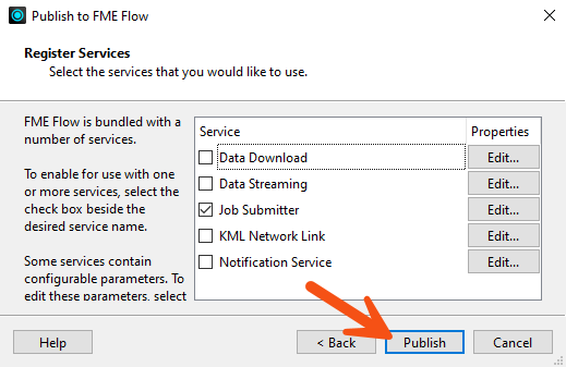

With confirmation that the web connection in use in the workspace is tied to the modified Azure app registration, connect to FME Flow and click the Publish button in the FME Workbench ribbon.

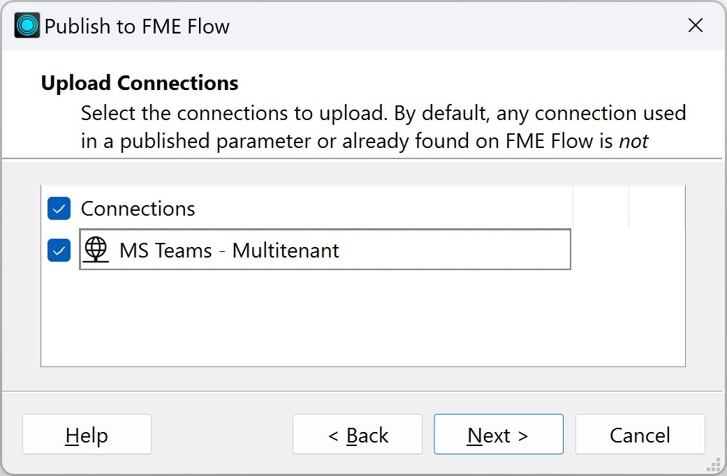

Proceed through the publish wizard. On the Upload Connections step, make sure to select the check box next to the MicrosoftTeamsConnector web connection you use in your workspace. This action will upload both the web connection and its underlying web service to FME Flow.
Click Next, and then click Publish to publish the workspace with the web connection to FME Flow.

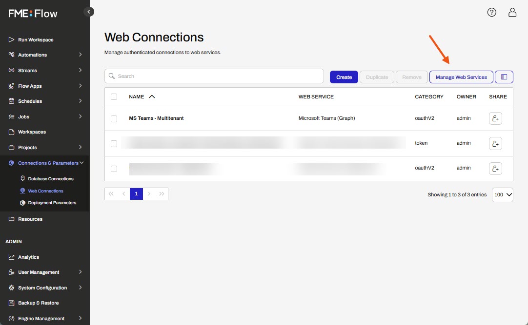

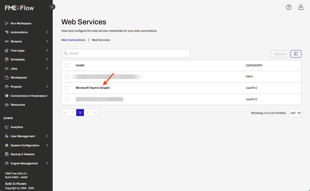

Once the workspace and connection are published successfully, log in to the Web UI of the FME Flow instance you published to in Step 1. From the side menu, click Connections & Parameters > Web Connections. If you’re using a version of FME Flow prior to 2023, click Files & Connections. You should see the connection(s) you published from FME Workbench and their associated web services. Click Manage Web Services.
Click on the web service you want to edit (i.e, the web service that was published along with your MicrosoftTeamsConnector web connection).

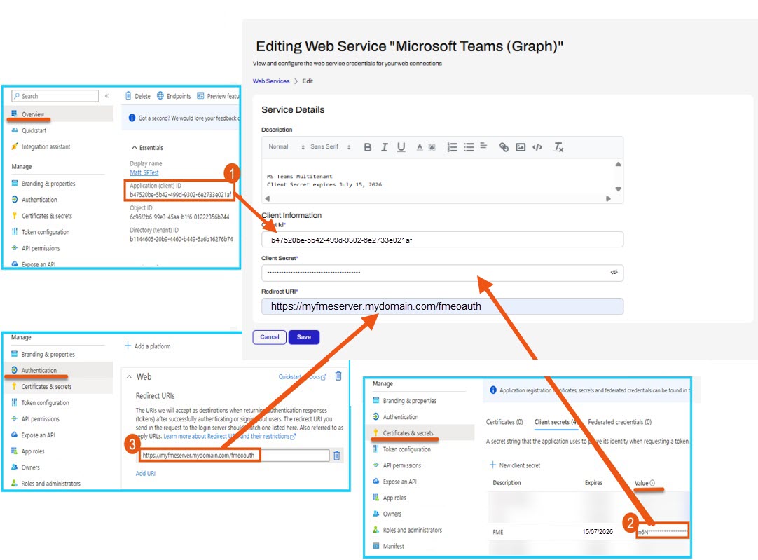

Fill in the details for your web service:
- Description (optional): It’s recommended to update the description so that it reflects at minimum the name of the Azure app registration used by this web service
- Client ID: This value should already be present and match the Application (client) ID from the Azure app registration that you modified in Part 1, above
- Client Secret: The client secret value from your Azure app registration is found in Certificates & Secrets. If you did not save the value when you first created the secret, you will need to create another in Azure.
- Redirect URI (or Authorization URL): the Redirect URI, ending in fmeoauth, for your FME Flow instance. This was added to the web platform in your Azure app under Authentication in Part 1 - Step above. For example, https://myfmeserver.mydomain.com/fmeoauth
Click OK to save the changes.

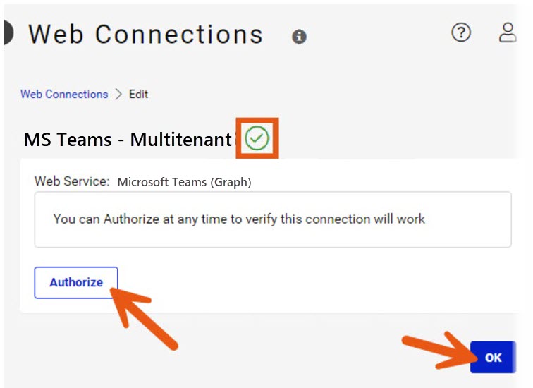

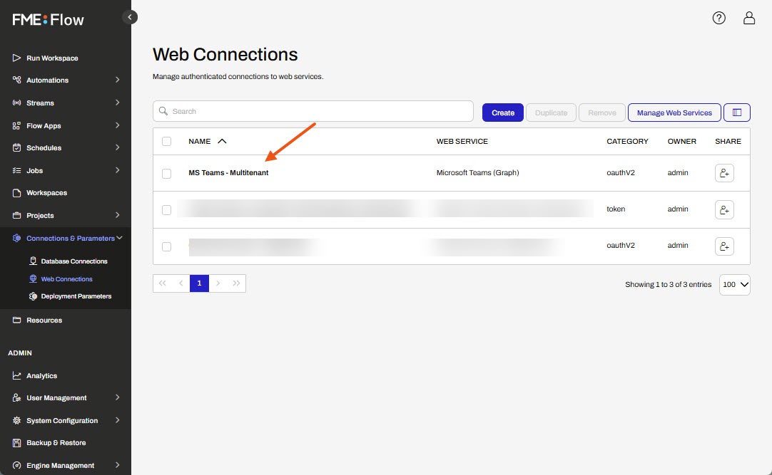

Return to the Web Connections page. Click on the web connection associated with the web service.
Click Authorize. You will be prompted to log in with your Microsoft credentials and may be prompted to grant consent to the Azure app registration. Once authorized successfully, the web connection will have a green checkmark. Click OK to close the web connection.
The MicrosoftTeamsConnector web connection is now ready for use on FME Flow.
