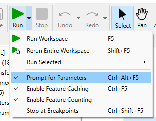

When using the benchmarking workspace, the first thing you’ll need to do is ensure that Prompt for Parameters is enabled. This can be done via the drop-down arrow next to the Run button.

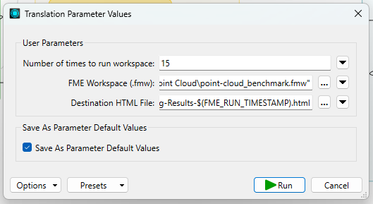

Now, when the workspace is run, the User Parameters window will pop up. Here’s where you can configure the settings for the run.
The “Number of times to run the workspace” number specifies how many times the test workspace will be run. The higher the number, the more accurate the results will be but keep in mind that this will take longer and use more resources. 15 is the default.
The other parameters are where you select your test workspace as well as a location and name for the HTML report. By default, the HTML report will be saved in the same location as your benchmarking workspace, and be named “Benchmarking-Results-<runtime>.html”.

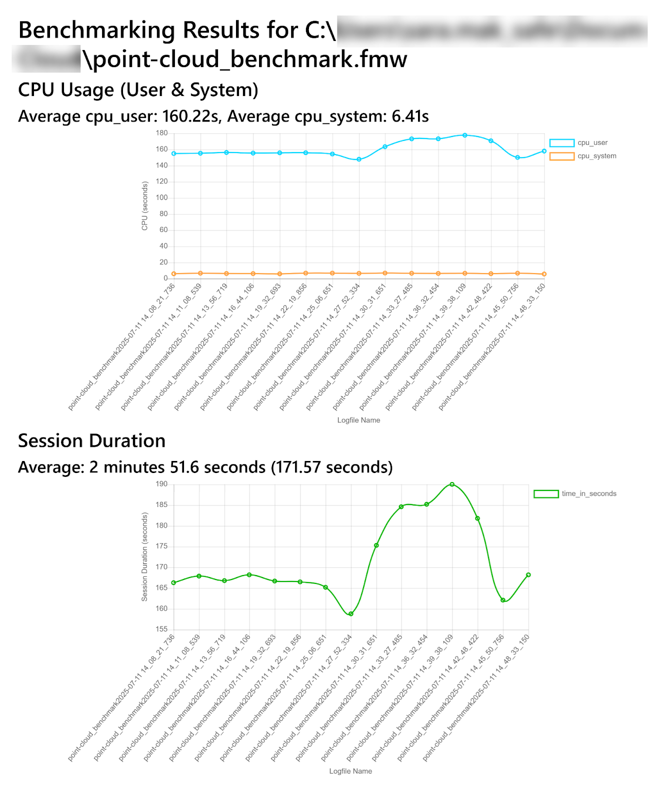

Click the Run button on the User Parameters window to initiate the translation. When it's finished, view the output HTML report. Below is an example:
