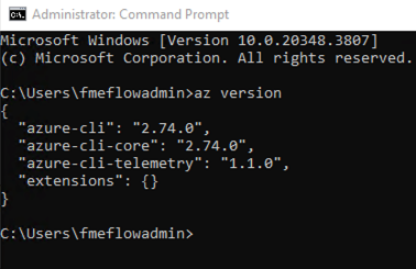

  1. Azure CLI is installed on the Flow VM.
    1. Go to the official download page. Download and run AzureCLI.msi.
    2. After installation, open Command Prompt or PowerShell, and run:
az version
The version and component list will be returned if the CLI is installed correctly.

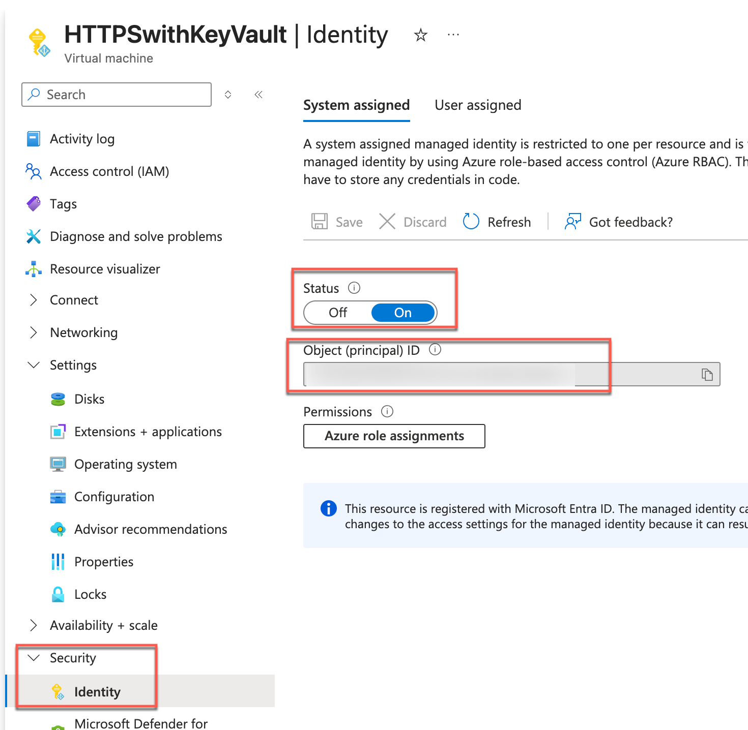

2. Enable System Assigned Managed Identity on the Azure VM hosting the FME Flow
In Azure Portal, go to your Azure VM >Security >Identity > System assigned and set Status: On. Take a note of the Object (principal) ID for the next step.

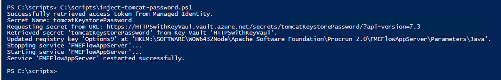

Save the following as C:\scripts\inject-tomcat-password.ps1 on FME Flow machine:
 # Authenticate using Managed Identity
try {
    $tokenResponse = Invoke-RestMethod -Headers @{Metadata="true"} -Method GET -Uri "http://169.254.169.254/metadata/identity/oauth2/token?resource=https://vault.azure.net&api-version=2018-02-01"
    $accessToken = $tokenResponse.access_token
    Write-Host "Successfully retrieved access token from Managed Identity."
} catch {
    Write-Error "Failed to retrieve access token from Managed Identity: $_"
    exit 1
# Define Key Vault and secret name
$vaultName = "HTTPSwithKeyVaul"
$secretName = "tomcatKeystorePassword"
# Validate and confirm secret name
if ([string]::IsNullOrWhiteSpace($secretName)) {
    Write-Error "Secret name variable is empty or undefined."
    exit 1
Write-Host "Secret Name: $secretName"
# Build the full secret URI
$secretUri = "https://$vaultName.vault.azure.net/secrets/$secretName/?api-version=7.3"
Write-Host "Requesting secret from URL: $secretUri"
# Retrieve the secret from Azure Key Vault
try {
    $response = Invoke-RestMethod -Headers @{Authorization = "Bearer $accessToken"} -Uri $secretUri -Method GET
    $plainPassword = $response.value
    Write-Host "Retrieved secret '$secretName' from Key Vault '$vaultName'."
} catch {
    Write-Error "Failed to retrieve secret from Azure Key Vault: $_"
    exit 1
# Define registry path and key for Tomcat options
$regPath = "HKLM:\SOFTWARE\WOW6432Node\Apache Software Foundation\Procrun 2.0\FMEFlowAppServer\Parameters\Java"
$regValue = "Options9"
# Read and update the registry value
try {
    $current = Get-ItemProperty -Path $regPath -Name $regValue -ErrorAction Stop | Select-Object -ExpandProperty $regValue
    if ($current -isnot [System.Array]) {
        $current = @($current)
} catch {
    Write-Warning "'$regValue' not found. Initializing new array."
    $current = @()
# Remove old keystore password entry
$filtered = $current | Where-Object { $_ -notmatch "^-Djavax.net.ssl.keyStorePassword=" }
# Append new keystore password option
$updated = $filtered + "-Djavax.net.ssl.keyStorePassword=$plainPassword"
# Write to registry
try {
    Set-ItemProperty -Path $regPath -Name $regValue -Value $updated
    Write-Host "Updated registry key '$regValue' at '$regPath'."
} catch {
    Write-Error "Failed to write to registry: $_"
    exit 1
# Restart the FME Flow Tomcat service
$serviceName = "FMEFlowAppServer"
try {
    $service = Get-Service -Name $serviceName -ErrorAction Stop
    if ($service.Status -ne "Stopped") {
        Write-Host "Stopping service '$serviceName'..."
        Stop-Service -Name $serviceName -Force -ErrorAction Stop
        Start-Sleep -Seconds 5
    Write-Host "Starting service '$serviceName'..."
    Start-Service -Name $serviceName -ErrorAction Stop
    Write-Host "Service '$serviceName' restarted successfully."
} catch {
    Write-Error "Failed to restart service '$serviceName': $_"
    exit 1

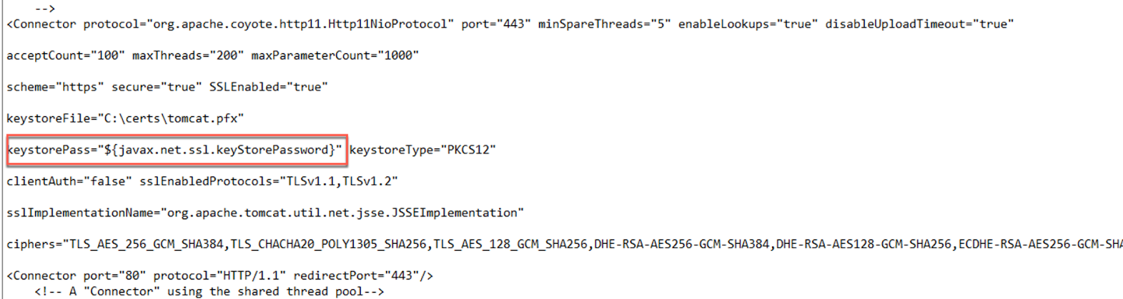

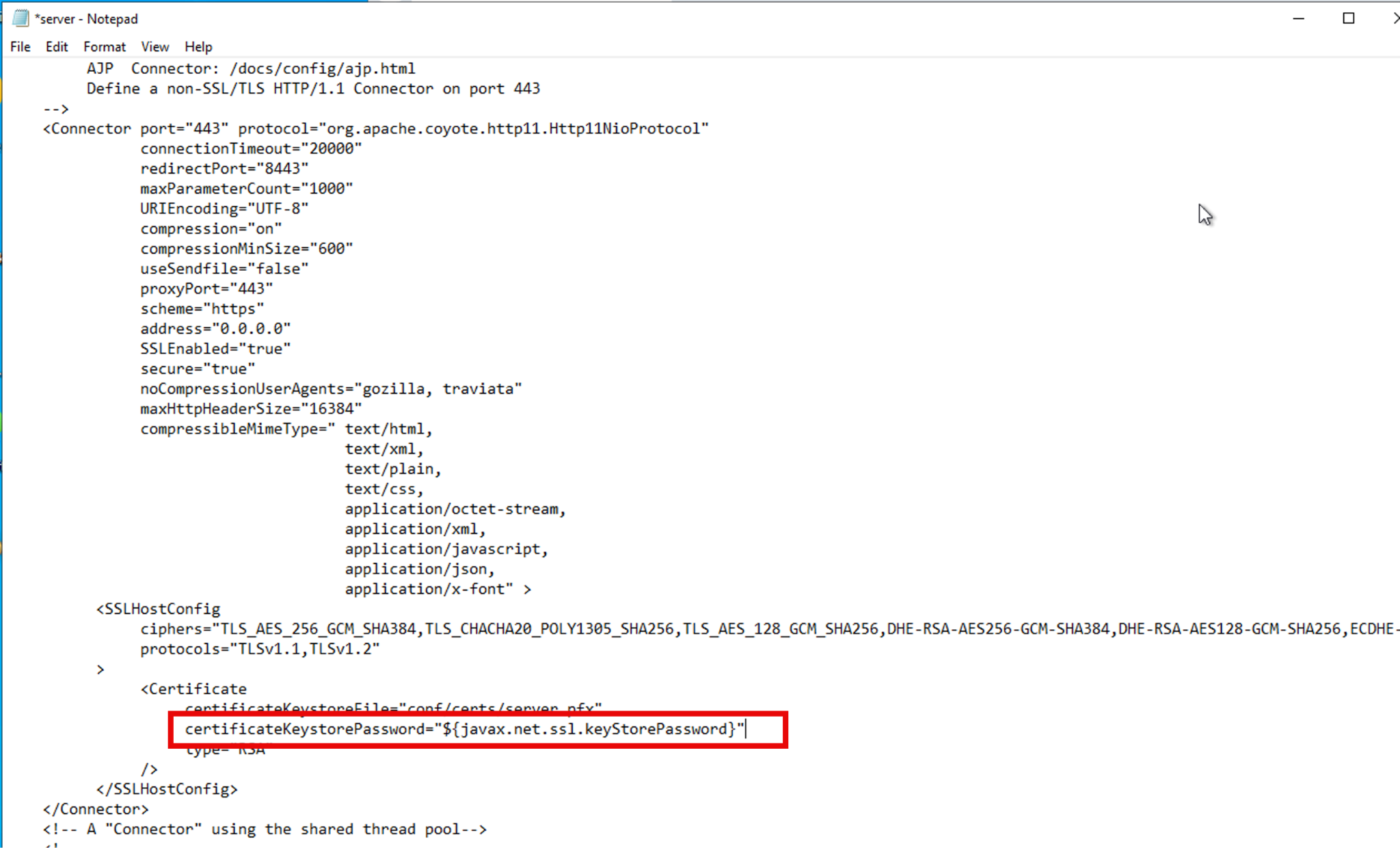

4. Set keyStorePassword Reference in server.xml
In server.xml, update the HTTPS connector: keystorePass="${javax.net.ssl.keyStorePassword}"
Tomcat will read the injected system property at runtime.
5. Run the Script
It should auto-restart Flow web app service

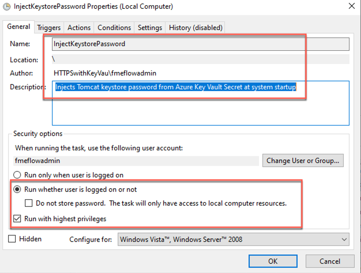

6. Automate Script Execution at Boot (Optional)
To ensure the password is injected before Tomcat starts:
  1. Open Task Scheduler
  2. Create a new task:

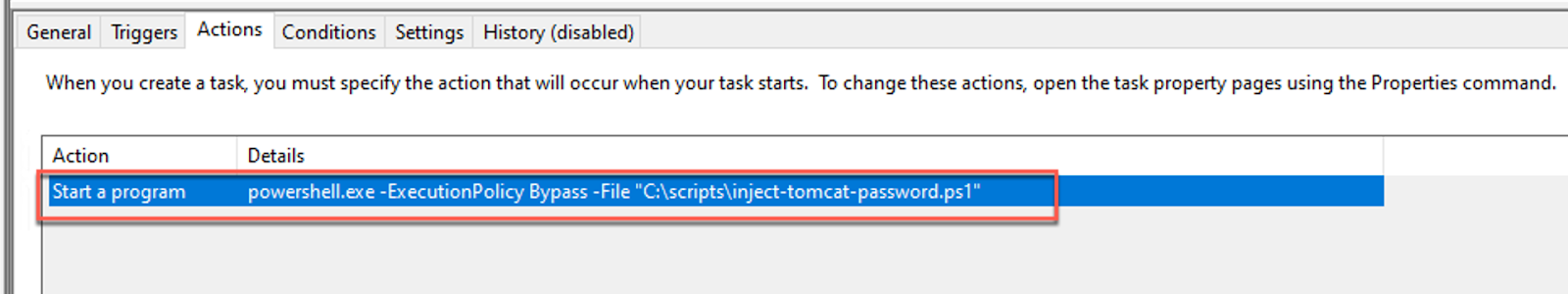

    • Trigger: At system startup
    • Action: Run powershell.exe
    • Arguments:-ExecutionPolicy Bypass -File "C:\scripts\inject-tomcat-password.ps1"
  • Run with the highest privileges
