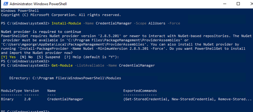

1. Install CredentialManager PowerShell Module
Run this in PowerShell as Administrator:
Install-Module -Name CredentialManager -Scope AllUsers -Force
If prompted to allow PowerShellGet to install, enter Y.

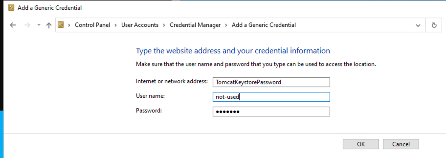

2. Store the Keystore Password in Windows Credential Manager Manually via GUI
Open Control Panel → Credential Manager
Click Windows Credentials → Add a generic credential and fill in the following fields:
  • Internet/Network Address: TomcatKeystorePassword
  • Username: not-used
  • Password: <YourKeystorePassword>
Click OK to save and exit

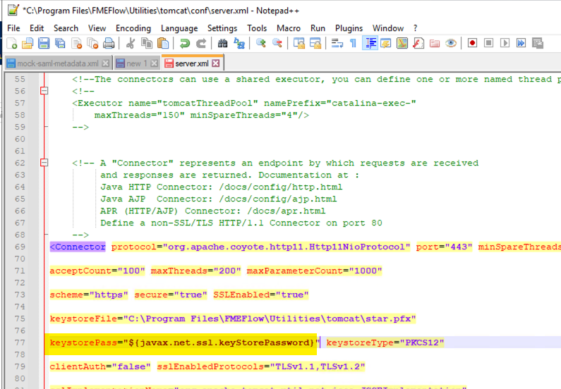

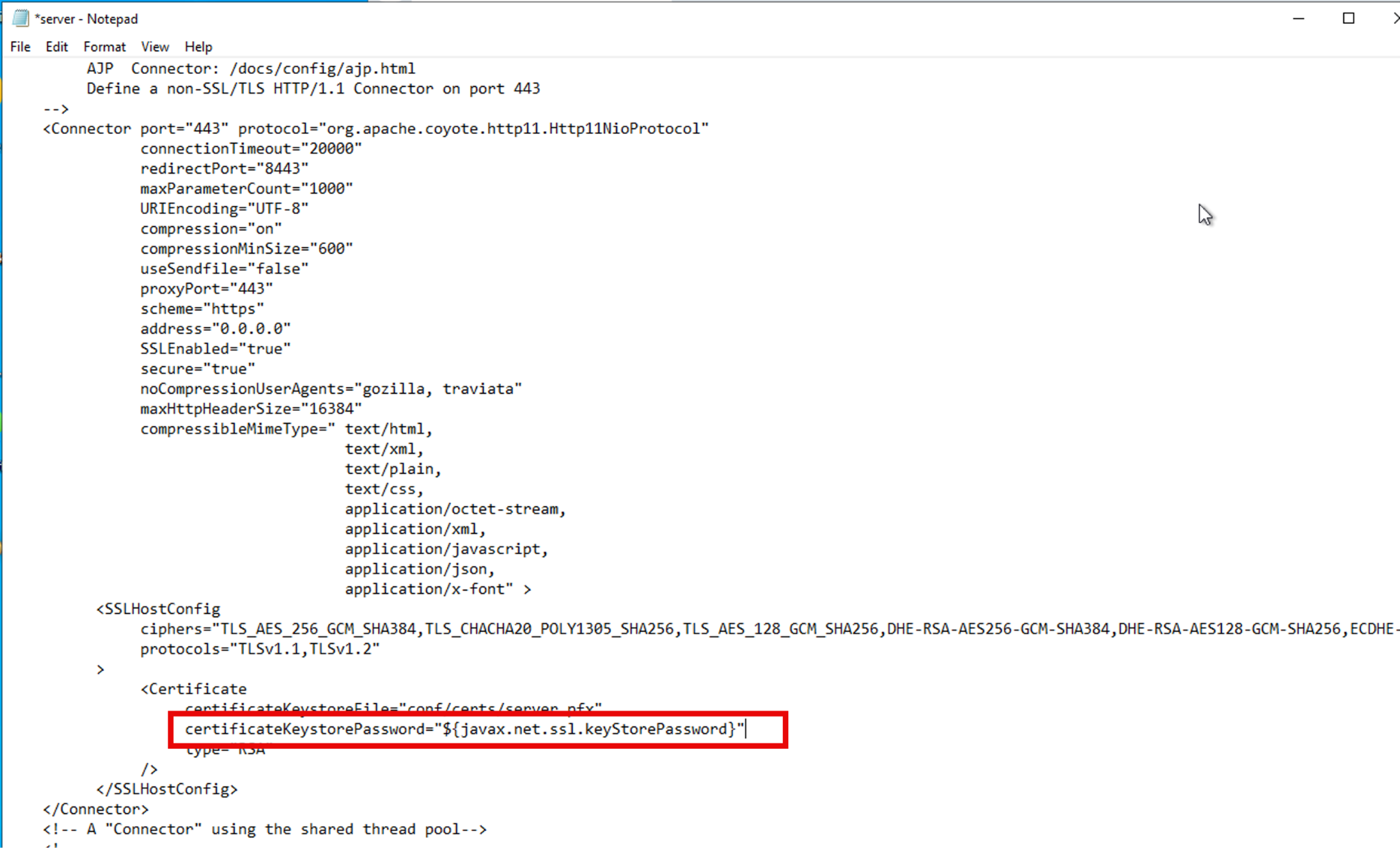

4. Set keyStorePassword reference in server.xml
In server.xml, update the HTTPS connector: keystorePass="${javax.net.ssl.keyStorePassword}"
Tomcat will read the injected system property at runtime.

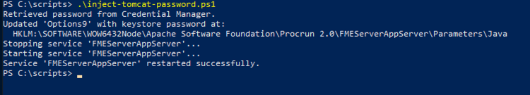

5. Run the script
It should auto-restart the Flow web app service

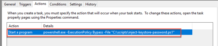

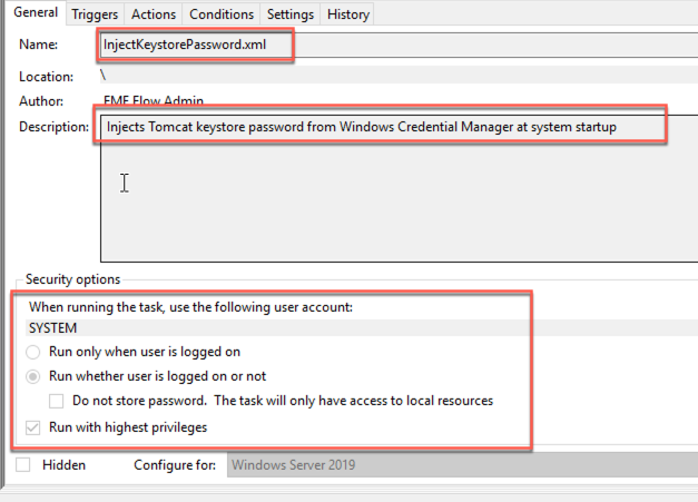

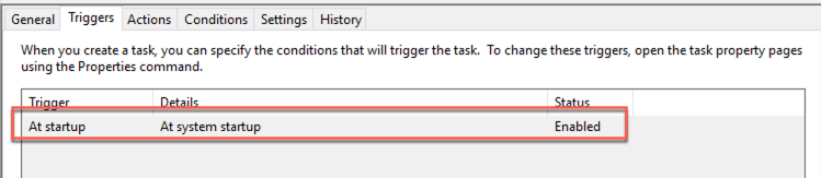

6. Automate Script Execution at Boot (Optional)
To ensure the password is injected before Tomcat starts, open Task Scheduler and create a new task with the following parameters:
  • Trigger: At system startup
  • Action: Run powershell.exe
  • Arguments: -ExecutionPolicy Bypass -File "C:\scripts\inject-tomcat-password.ps1"
Run with the highest privileges
