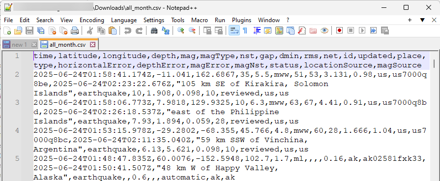

The data for this tutorial is a CSV file of all the earthquakes recorded in a one-month time frame from the USGS Earthquake Hazard Program.

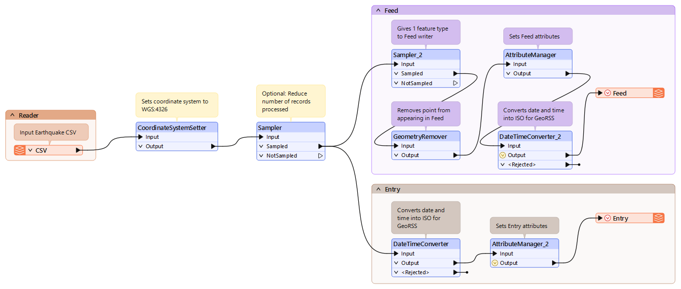

1. Open FME Workbench
Open FME Workbench and start a new workspace, or open CSVtoGeoRSS.fmwt to follow along in the finished workspace.

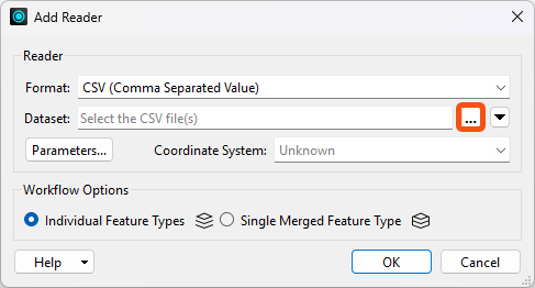

2. Add a CSV Reader
Add a new reader and select CSV as the Format
  • Format: CSV (Comma Separated Value)
  • Dataset: all_month.csv
    • Click the ellipsis to navigate to the location of the file on your computer
Click OK

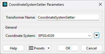

3. Add a CoordinateSystemSetter Transformer
Simple geometry only supports EPSG:4326. Since our output is GeoRSS-Simple, we will set the coordinate system to EPSG:4326 here. Connect the CSV reader to the input port and double-click the transformer to open the parameters window to set the following fields:
  • Coordinate System: EPSG:4326
Click OK

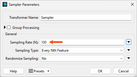

4. Optional: Add a Sampler Transformer
If you are working with a large dataset and would like to test that the output is correct before processing the entire dataset, add a Sampler transformer. For this example, the Sampler transformer retained 1 out of 100 records by changing the following parameter:
  • Sampling Rate (N): 100
Click OK

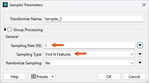

5. Add a Second Sampler Transformer
Only the first feed type feature is passed onto the GeoRSS writer; all others will be ignored. Connect the Sampled port of your first Sampler to the input of this transformer. Let's set up this Sampler with the following parameters:
  • Sampling Type: First N Features
Click OK.

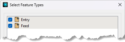

9. Add a GeoRSS/RSS Feed Writer
Click the Add Writer button, start typing GeoRSS, and select the GeoRSS/RSS Feed Writer. Name the GeoRSS Feed file. We will keep the default Writer Parameters but enable Pretty Print for better readability. Select both Feed and Entry.
Click OK.

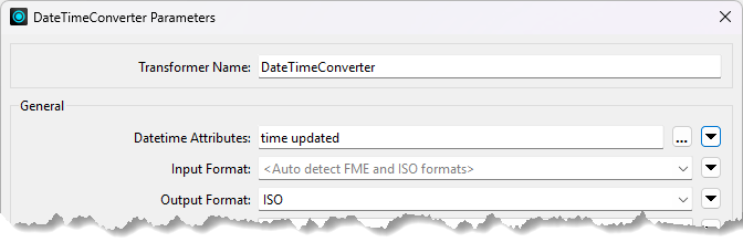

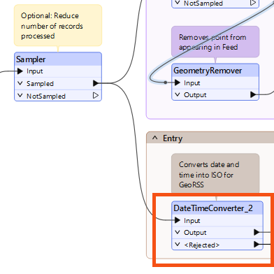

10. Add a Second DateTimeConverter Transformer
From the Sampled port of our first Sampler, add a connection to our newly added DateTimeConverter’s Input port. This time, we are converting the “time” and “updated” attributes from our input CSV.
  • Datetime Attributes: time, updated
  • Output Format: ISO
Click OK.

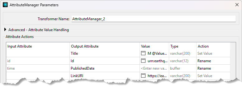

11. Add a second AttributeManager Transformer
This transformer will help us set the attributes for our Entry feature type writer. Connect AttributeManager_2 to the output port of the DateTimeConverter_2 transformer.
  • Add Attribute:
    • Output Attribute: Title
      • Value: M @Value(mag) - @Value(place)
    • Output Attribute: LinkURI
      • Value: https://earthquake.usgs.gov/earthquakes/eventpage/@Left(@Value(Id),2)@Right(@Value(Id),8)
  • Update Attribute:
    • Input Attribute: id
      • Output Attribute: ID
      • Action: Rename
    • Input Attribute: time
      • Output Attribute: Published Date
      • Action: Rename
Click OK.
The title will include the entry's magnitude and location. Since the GeoRSS entry's ID has a particular format, we must use string functions to generate the proper format.

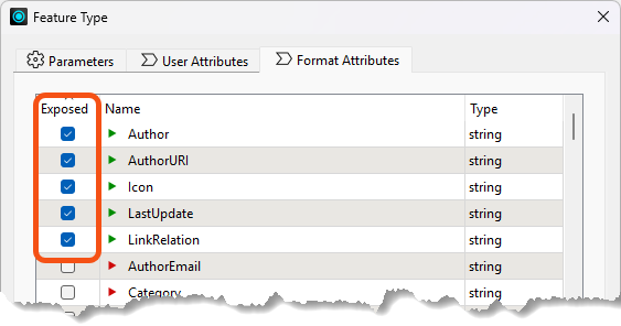

1. Expose Additional Format Attributes from the Feed Writer
Double-click on the Feed writer to open the Feature Types, and navigate to the Format Attributes tab to expose additional attributes. Beyond the attributes we set from the previous part, we also need to expose five additional format attributes. Find the following and click the checkbox to expose them:
  • AuthorURI
  • Icon
  • LastUpdate
  • LinkRelation
Click OK.

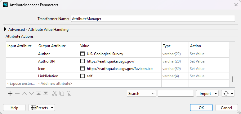

Let’s add on the attributes that we just exposed. Open the parameters for the AttributeManager and set the following:
  • Add Attribute:
    • Output Attribute: Author
      • Value: U.S. Geological Survey
    • Output Attribute: AuthorURI
    • Output Attribute: Icon
      • Value: https://earthquake.usgs.gov/favicon.ico
    • Output Attribute: LinkRelation
      • Value: self
Click OK.

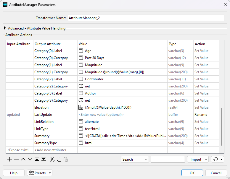

4. Add Exposed Attributes
Let’s set the values of the attributes we just exposed to the AttributeManager_2 transformer.
The Category{}.Label and Category{}.Category attributes are list attributes. If you would like multiple Category attributes, start with Category{0}.Label and Category{0}.Category. Then, use {1} as the list element number and keep going up by an integer for any additional Category attributes.
  • Add Attribute:
    • Output Attribute: Category{0}.Label
      • Value: Age
    • Output Attribute: Category{0}.Category
      • Value:3 0 Days
    • Output Attribute: Category{1}.Label
      • Value: Magnitude
    • Output Attribute: Category{1}.Category
      • Value: Magnitude @round(@Value(mag),[0])
    • Output Attribute: Category{2}.Label
      • Value: Contributor
    • Output Attribute: Category{2}.Category
      • Value: net
    • Output Attribute: Category{3}.Label
      • Value: Author
    • Output Attribute: Category{3}.Category
      • Value: net
    • Output Attribute: Elevation
      • Value: @Evaluate(@mult(@Value(depth),[1000]))
      • Value: alternate
    • Output Attribute: LinkType
      • Value: text/html
    • Output Attribute: Summary
      • Value: <![CDATA[<Insert valid HTML>]]>
    • Output Attribute: SummaryType
      • Value: HTML
  • Update Attribute:
    • Input Attribute: updated
      • Output Attribute: LastUpdated
        • Action: Rename
Click OK.

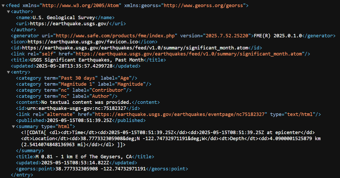

5. Run the Workspace
Run the workspace and view the output. You will have one XML output file containing the Feed and Entry feature types. View the file with any XML editor to see your newly created GeoRSS output! Here we can see the feed and the first entry:

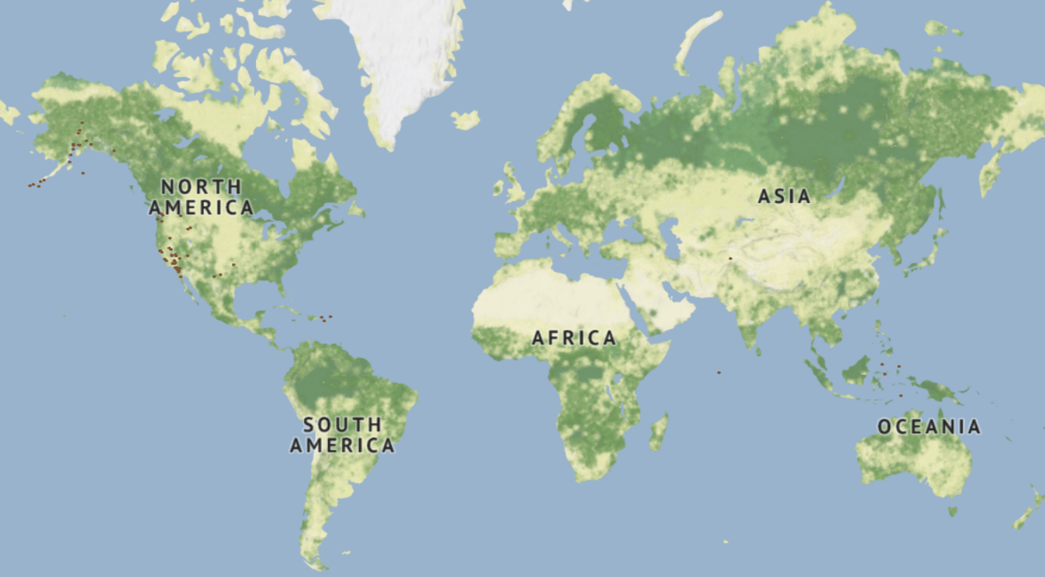

Here is a preview of the GeoRSS feed in Data Inspector, where the earthquake events can be seen as points on a map:
