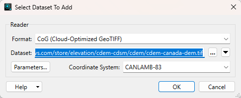

1. Open FME Data Inspector and Open a Dataset
In FME Data Inspector, click on the Open button, which will add the dataset to a new view directly. You could also use the Add button, which will add the dataset to the list at the bottom. From there, you can open the dataset in a new view.
Continue to Step 2 before clicking OK.
Copy and paste the path in the Dataset field. Do NOT open in a browser - The file is a 31GB COG dataset. If you accidentally click the link, cancel the download.

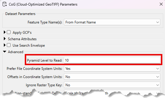

Click the “Parameters..” button to set additional parameters. To view the entire COG dataset:
  • Use Search Envelope: Unchecked
  • Pyramid Level to Read: 10
Then click OK.
Using pyramid level 10, which is the lowest resolution of 16 km x 16 km, will ensure the lowest resolution for this large dataset and render the image faster.

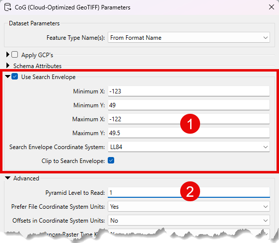

To view a certain area of the DEM at the highest resolution of 30m, reduce the extent of the raster by enabling Use Search Envelope.
  • Use Search Envelope: Checked
    • Minimum X: -123
    • Minimum Y: 49
    • Maximum X: -122
    • Maximum Y: 49.5
  • Search Envelope Coordinate System: LL84
  • Clip to Search Envelope: Checked
Then click OK.
Level 1 is a 30 m resolution.

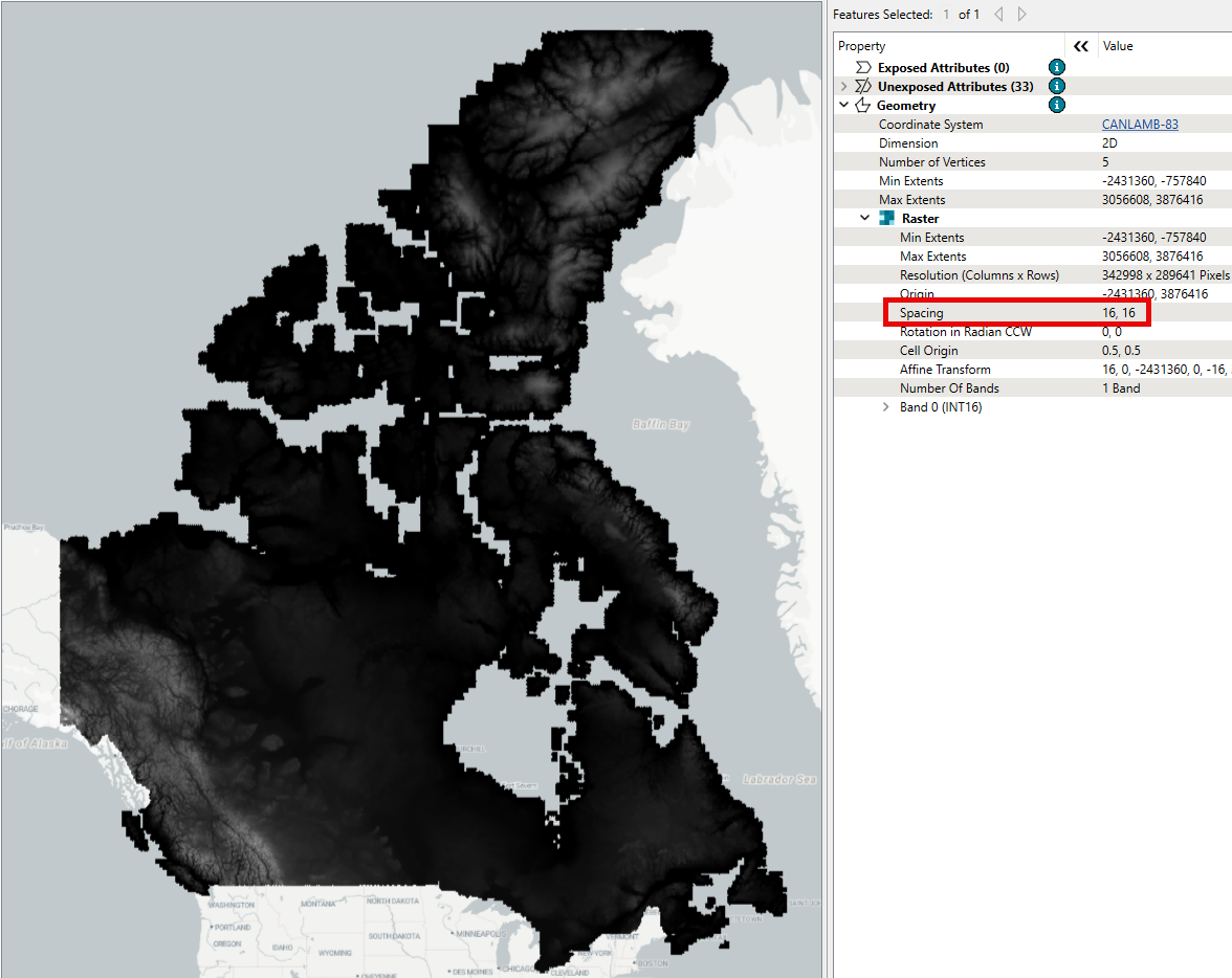

Below is a screenshot of the full dataset. This is the DEM of Canada without the search envelope and at the lowest-level resolution of 16km x 16km.

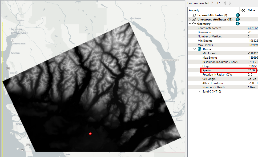

And below is the screenshot of the subset of the same DEM. Pyramid Level = 1 displays the highest resolution of 30m x 30m.
