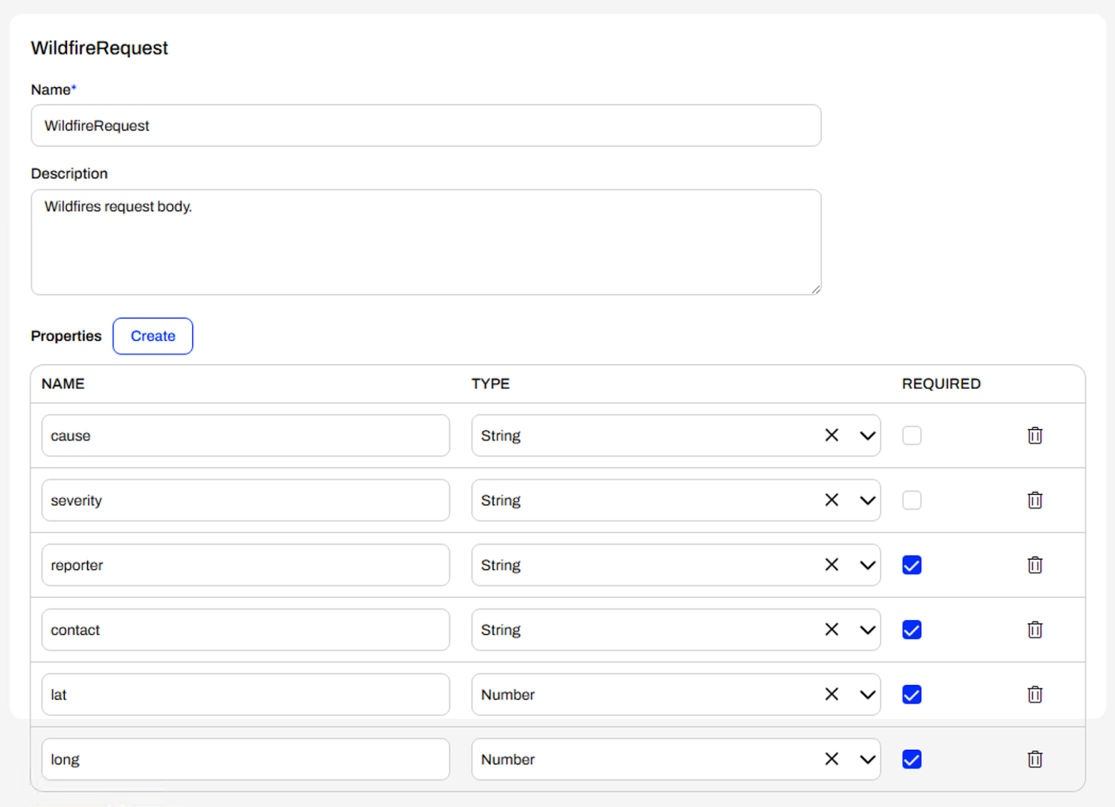

1. Create a Schema
Navigate the Data Virtualization Environmental Impact and Response API in FME Flow. Open the Schemas tab.
Select Create to define a new schema.
  • Name: WildfireRequest
  • Description: Wildfires request body
  • Properties:
    • Click Create next to Properties. Enter the following values, after each property, click Create again to create another property.
Name Type Required
cause String No
severity  String No
reporter String Yes
contact String Yes
lat Number Yes
long Number Yes
The Required flag is more significant when creating a schema for a request body. When flagged as Required, the end user understands that this value is mandatory for a successful POST request.
The WildfireRequest schema is different from the WildfireResponse schema because each serves a different purpose. Request schemas include only the data sent by the client, while response schemas add server-generated info like IDs, timestamps, or status. These extra fields aren't needed in the request.
Also, the request uses "lat" and "long" instead of the "location" field from the response. This lets the reporting app collect simple point data, and the workspace can then figure out the location. This avoids relying on users to describe it correctly.
Because of these differences, it's best to use separate schemas for requests and responses to keep client input and server output clear and organized.
When complete, save.

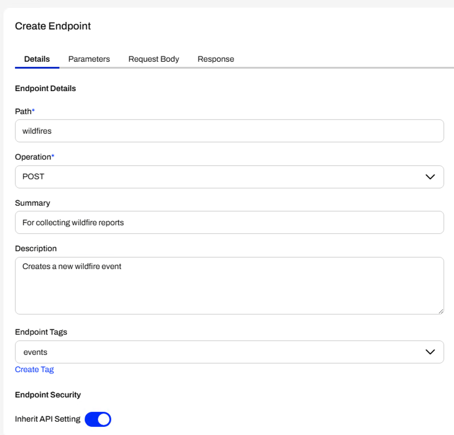

2. Create an Endpoint
Navigate to the Endpoints tab. Select Create to begin the POST request.
In the Endpoint Details, enter the following parameters:
  • Path: wildfires
  • Operation: POST
  • Summary: For collecting wildfire reports
  • Description: Creates a new wildfire event
  • Tags: events
  • Security: Inherit

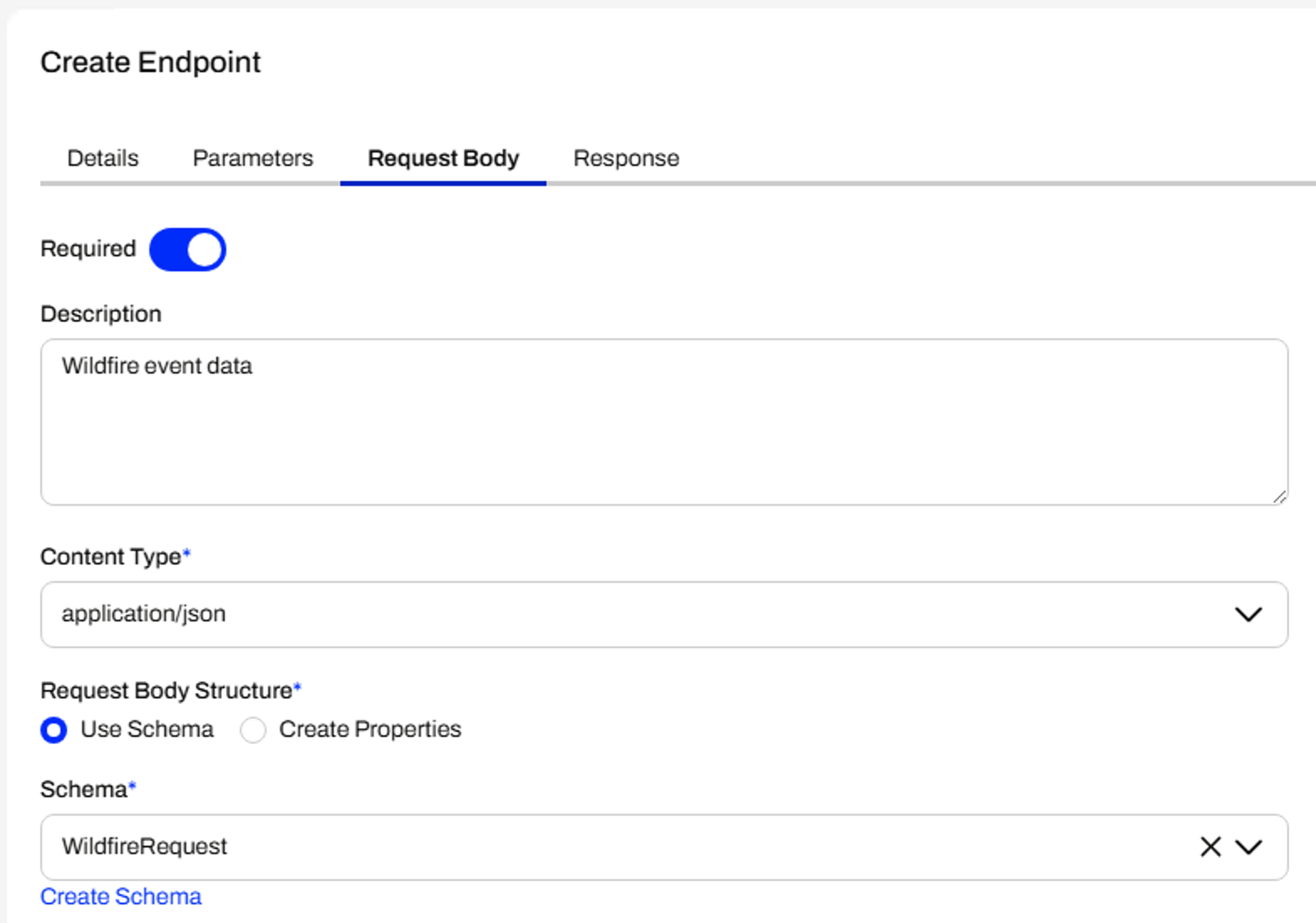

3. Configure Request Body
Since this endpoint is configured to use the POST method, a new tab is available: Request Body. Navigate to the Request Body tab.
A request body in a POST operation contains the data the client sends to the server, typically in JSON or XML format. This data is used by the server to create, update, or process a resource.
Make sure the Required option is enabled. While some POST requests may not require a body (for example, if they simply trigger an action, use query parameters instead, return a static response, or the server generates all required data), those scenarios are rarer. In this case, the client must provide wildfire data for the request to be valid and processed correctly.
Finally, configure the remaining request body settings, and select the WildfireRequest schema as the input template.
  • Required: Yes
  • Description: Wildfire event data
  • Content-Type: application/json
  • Input Type: Use Schema
  • Schema: WildfireRequest

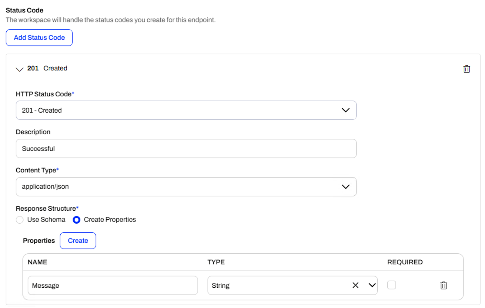

4. Configure the Response
Navigate to the Response tab.
For Response Type, select Workspace. Leave Inherit API Job Queue and Inherit API Job Expiry Time as enabled.
To define a new status code, click on Add Status Code.
We'll first define a 201 Created status code, which will be used when a request to the POST /fires endpoint successfully creates a new record in the SQLite fires table.
  • HTTP Status Code: 201 - Created
  • Description: Successful
  • Content Type: application/json
  • Input Type: Create Properties
  • Properties:
    • Name: Message
    • Type: String

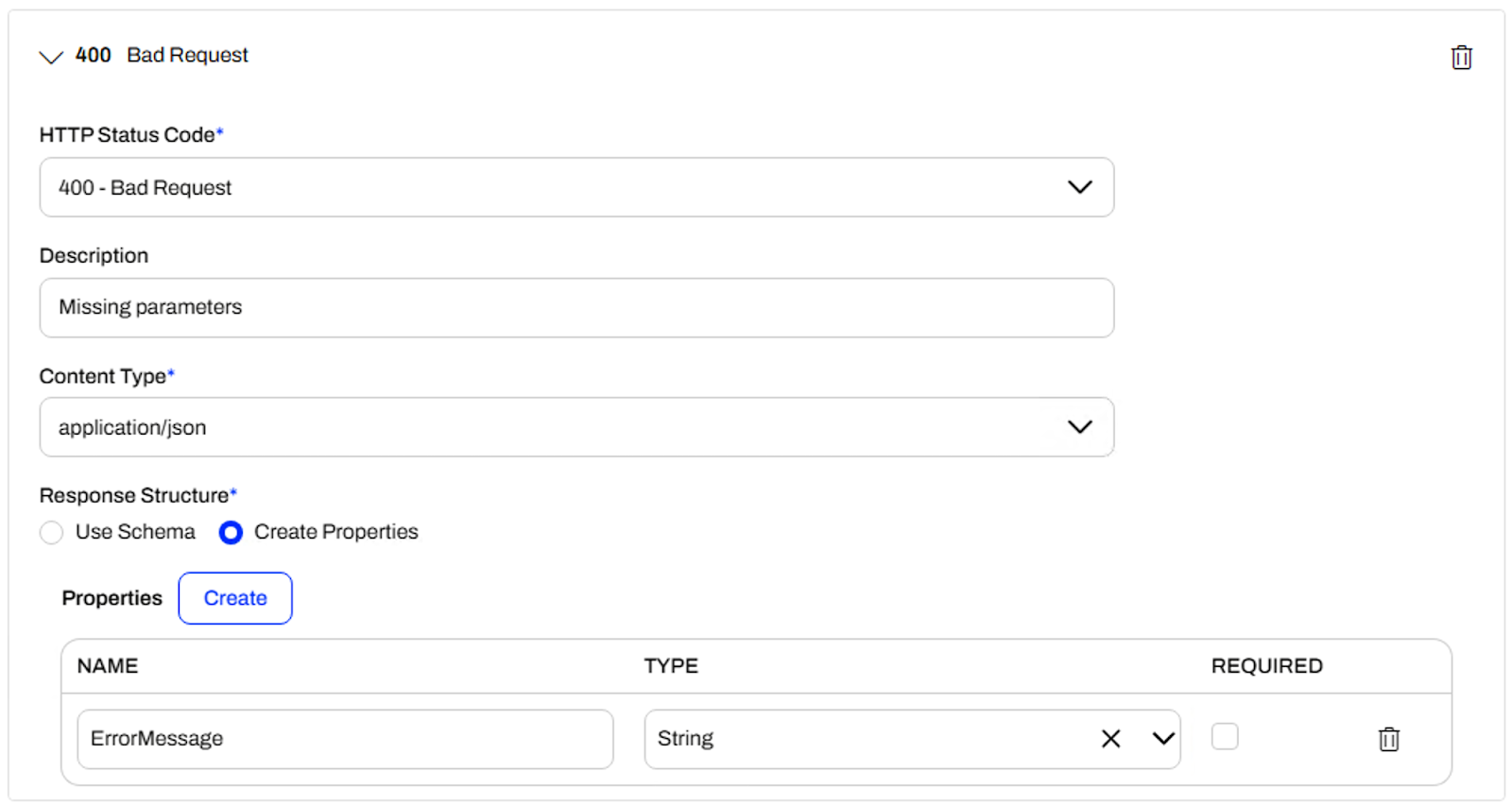

Add another status code, this time a 400- Bad Request status code, which will be used when a request to the POST /fires endpoint is missing required properties.
  • HTTP Status Code: 400 - Bad request
  • Description: Missing parameters
  • Input Type: Create properties
  • Properties:
    • Name: Error Message
    • Type: String
Leave Asynchronous Processing as enabled.
Once configured, select Create to save the endpoint.

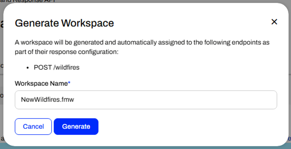

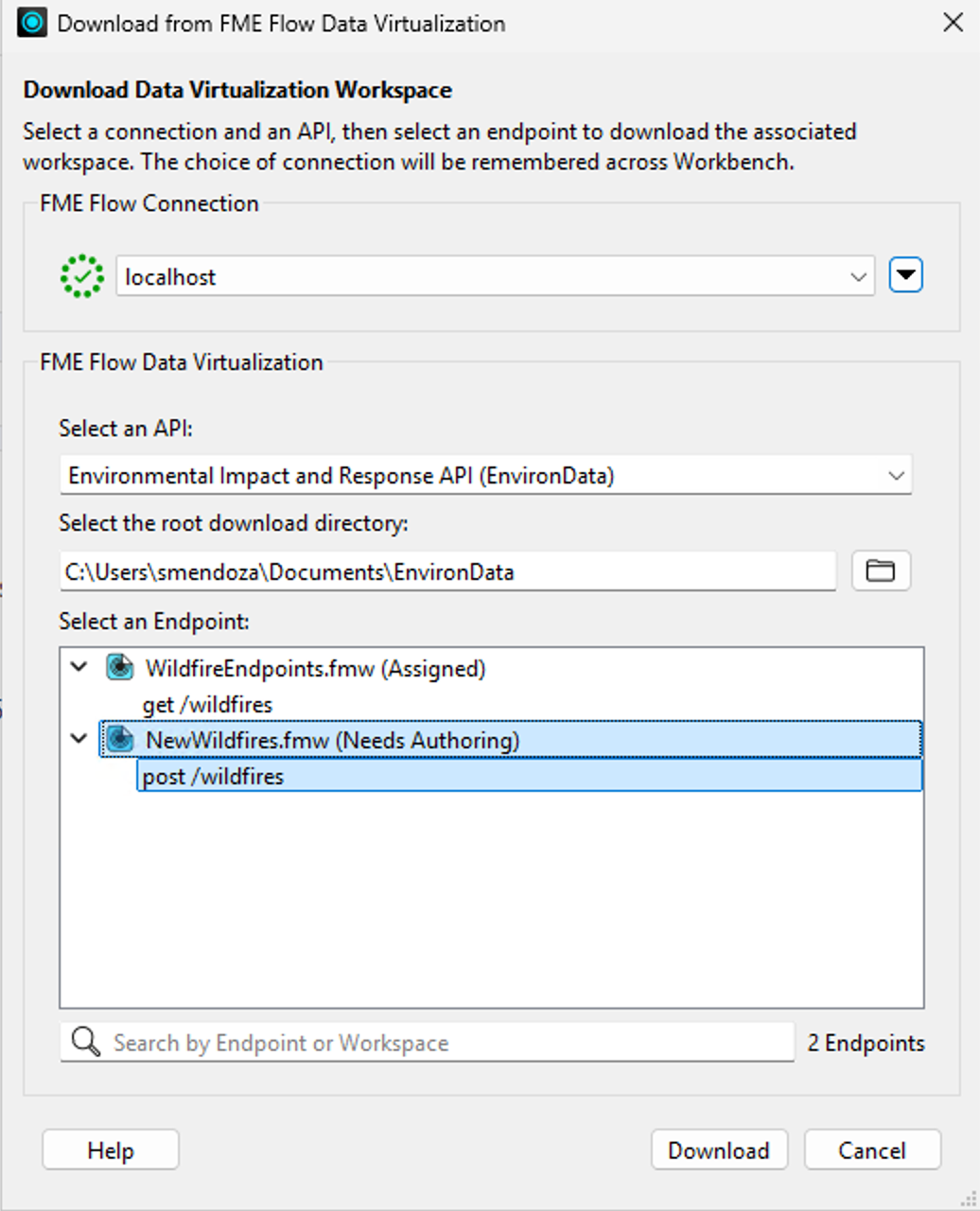

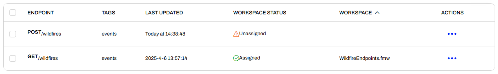

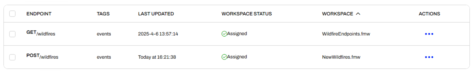

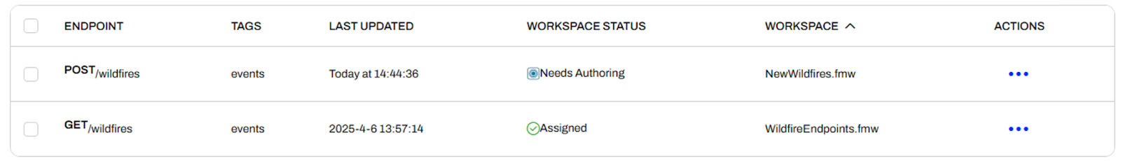

5. Assign a Workspace
Navigate to the Workspaces tab. The new POST endpoint is listed, with the Workspace Status as Unassigned.
Select the POST /wildfires endpoint and expand the Endpoint Actions menu. Select Generate Workspace:
  • Workspace Name: NewWildfires.fmw
Once assigned, the POST /wildfires Workspace Status will be Needs Authoring
6. Download Workspace

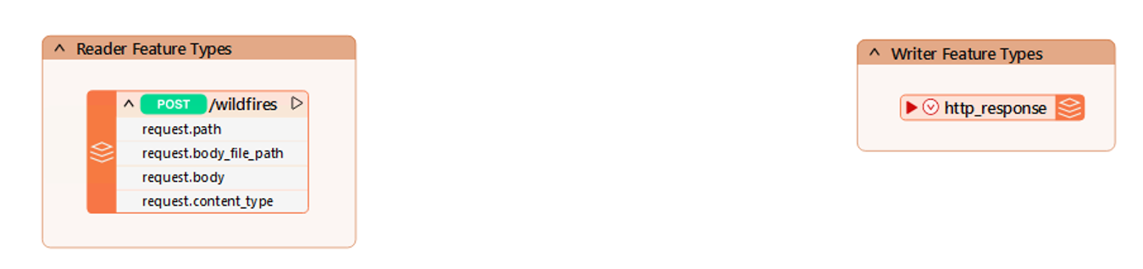

In FME Form, open the Data Virtualization menu and select the POST /wildfires workspace.
The workspace will open with a new Data Virtualization Reader Type, POST /wildfires.
A POST request introduces additional attributes to the Data Virtualization reader:
  • request.body_file_path: The full path to any files uploaded by the client, available for use during the request translation.
  • request.body: The raw data sent from the client to the server in the request body.
  • request.content_type: Specifies the format of the request body (e.g. application/json), allowing the FME to correctly parse and handle the incoming data.

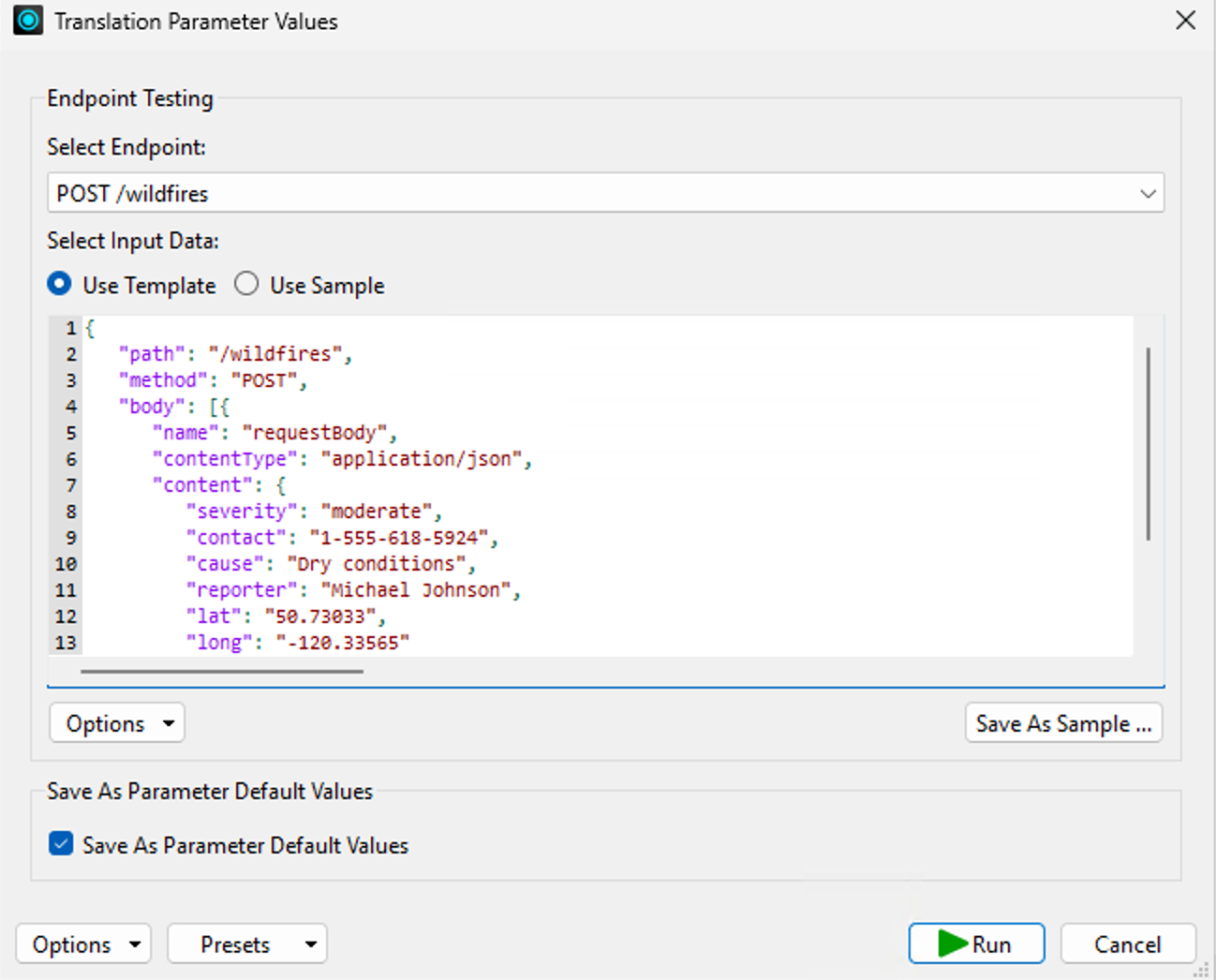

7. Use a POST Template

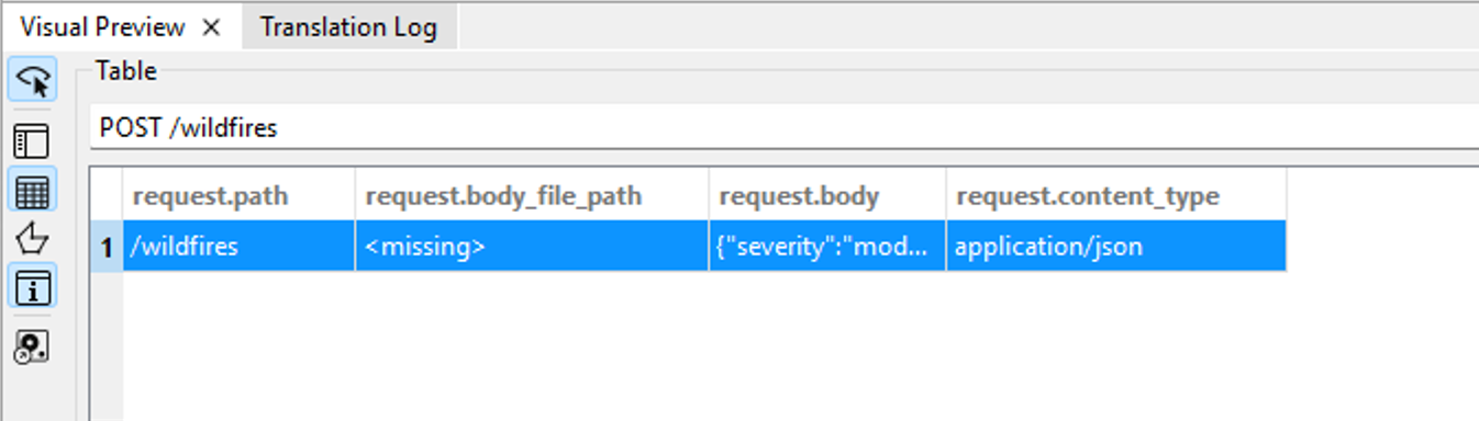

On the POST /wildfires Reader, select Run Just This.
In the Translation Parameter Values window, update the template with sample data:
   "path": "/wildfires",
   "method": "POST",
   "body": [{
      "name": "requestBody",
      "contentType": "application/json",
      "content": {
         "severity": "moderate",
         "contact": "1-555-618-5924",
         "cause": "Dry conditions",
         "reporter": "Michael Johnson",
         "lat": "50.73033",
         "long": "-120.33565"
Inspect the results to review the sample data.

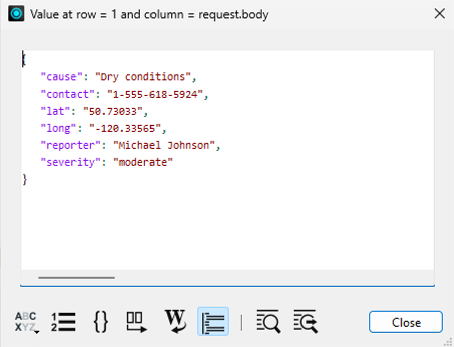

The request.body attribute contains our sample values.

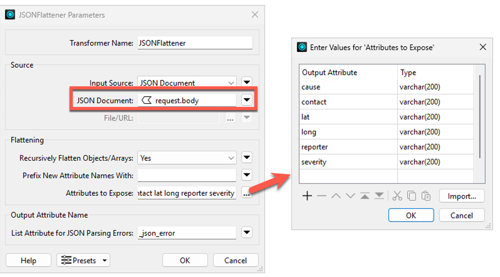

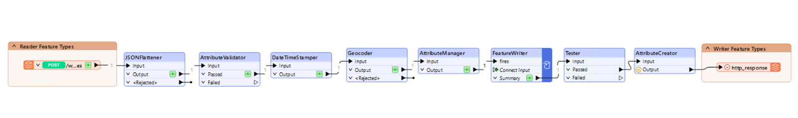

8. Parse the Body Contents
To turn the sample data into attributes, the request.body must be parsed.

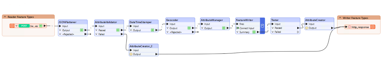

Add a JSONFlattener to the workspace and connect it to the POST /wildfires feature type. Open the JSONFlattener to configure the parameters.
  • JSON Document: request.body
  • Attributes to Expose:
    • cause
    • contact
    • lat
    • long
    • reporter
    • severity
      • Click the ellipsis to add attributes
Click OK to close.

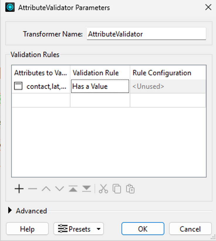

9. Check for Required Parameters
In FME Flow, a few properties in the WildfireRequest schema were marked as required: reporter, contact, lat, and long. The workflow should verify the client has sent values for these parameters before proceeding.
Add an AttributeValidator to the canvas and connect it to the JSONFlattener.
Open the AttributeValidator to configure its attributes.
  • Attributes to Validate: contact, lat, long, reporter
  • Validation Rule: Has a Value
Click OK to close.

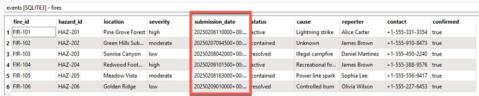

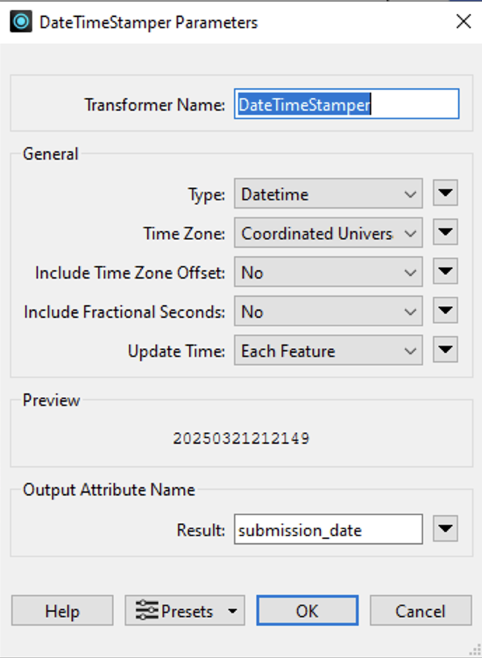

10. Add a Datetime Attribute
Some data attributes, such as unique IDs or timestamps, are often generated automatically by the target system or another downstream component in the data pipeline. In this example, the fires SQLite table includes a submission_date column, which records when a wildfire event is created, as well as identifier fields like fire_id and hazard_id.
To keep the workflow flexible and avoid conflicts with system-assigned values, we will leave the fire_id and hazard_id fields unpopulated, assuming they will be generated later by another system. We’ll also leave the confirmed column, assuming that is a manual process.
However, for the submission_date column, we will use FME to generate a timestamp during the workflow execution. This ensures that each submitted wildfire event is tagged with a consistent and accurate creation time.
Add a DateTimeStamper to the workspace and connect it to the Passed port of the AttributeValidator.
Open the DateTimeStamper. In the parameters:
  • Fractional Seconds: No
  • Result: submission_date
Click OK to close.

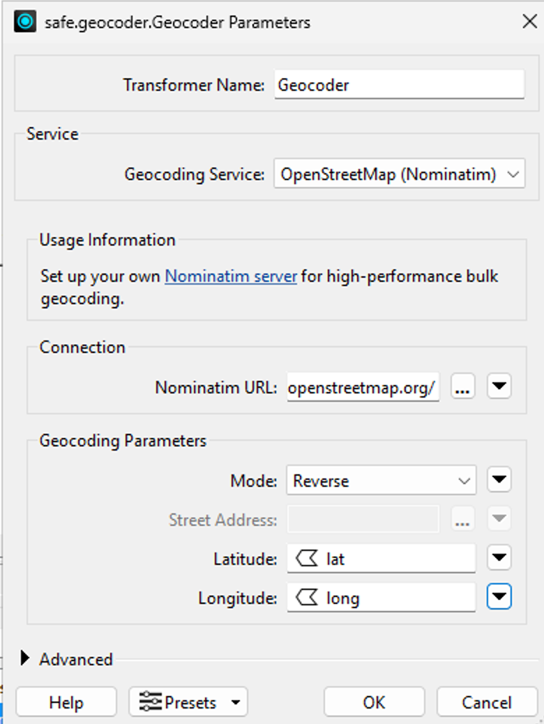

11. Geocode the Coordinates (Optional)
We can turn the collected coordinates into a location using the Geocoder. Add a Geocoder to the workspace and connect it to the DateTimeStamper.
Use a Geocoder Service of your choice, or use the free OpenStreetMap service for this example (review limitations before using any geocoding service).
  • Geocoding Service: OpenStreetMap (Nominatim)
  • Mode: Reverse
  • Latitude: lat
  • Longitude: long
Click OK to close.
The Geocoder creates a new attribute, _address, that can be used as the SQLite fires table’s location column.

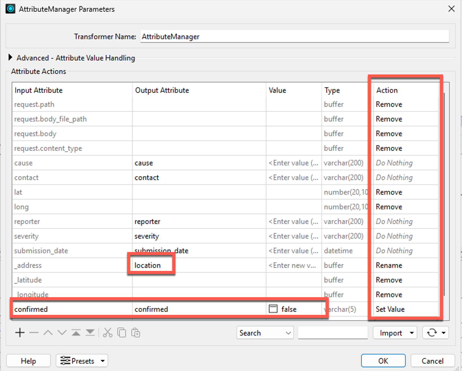

12. Filter the Attributes
At this point, our sample wildfire data submission can be prepared for database updates and the final API response.
Add an AttributeManager to the canvas and connect it to the Geocoder. Open the AttributeManager and configure the following Actions:
  • Remove all Data Virtualization Reader attributes: request.path, request.body_file_path, request.body, request.content_type.
  • Remove attributes incompatible with the database: _latitude, _longitude, lat, long.
  • Rename the _address attribute as “location”
  • Create a new attribute, “confirmed”. Set its value to “false”
Click OK to close.

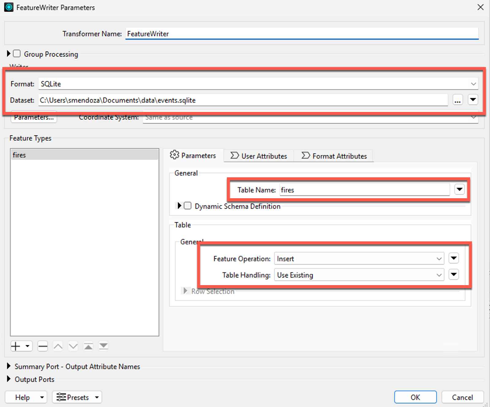

13. Write to the Database
Finally, the client data and generated attributes can be inserted into the database.
Add a FeatureWriter to the canvas and connect it to the AttributeManager (or DateTimeStamper if you skipped the Geocoder).
  • Format: SQLite
  • Dataset: .\events.sqlite
  • Table Name: fires
  • Feature Operation: Insert
  • Table Handling: Use Existing
Click OK to close.

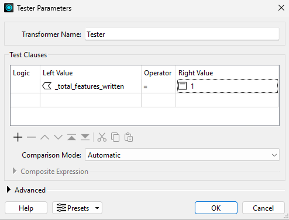

14. Test for Successful Insert
Before returning a response, the workflow should verify that the event has been successfully written to the database.
Add a Tester to the canvas and connect it to the Summary port. Open to configure its attributes.
  • Left Value: _total_features_written
  • Operator: =
  • Right Value: 1
Click OK to close.

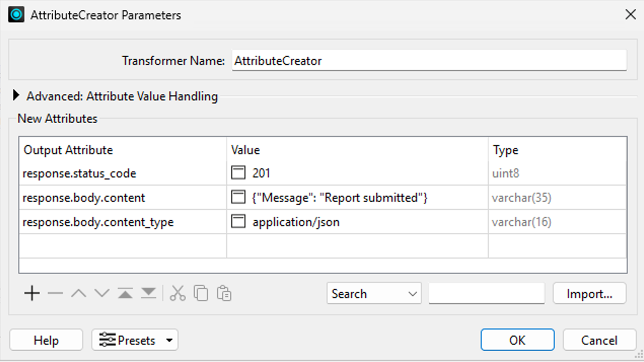

15. Format Successful Response Attributes
Add an AttributeCreator to the canvas and connect it to the Tester’s Passed port. Create the required response attributes for the ‘201 - Created’ status code.
  • Output Attribute: response.status_code
    • Value: 201
  • Output Attribute: response.body.content
    • Value: "Message": "Report submitted"}
  • Output Attribute: response.body.content_type
    • Value: application/json
Click OK to close.
To complete the successful response workflow, connect the AttributeCreator to the Data Virtualization Writer, http_response.
The successful (201) workflow is now complete.

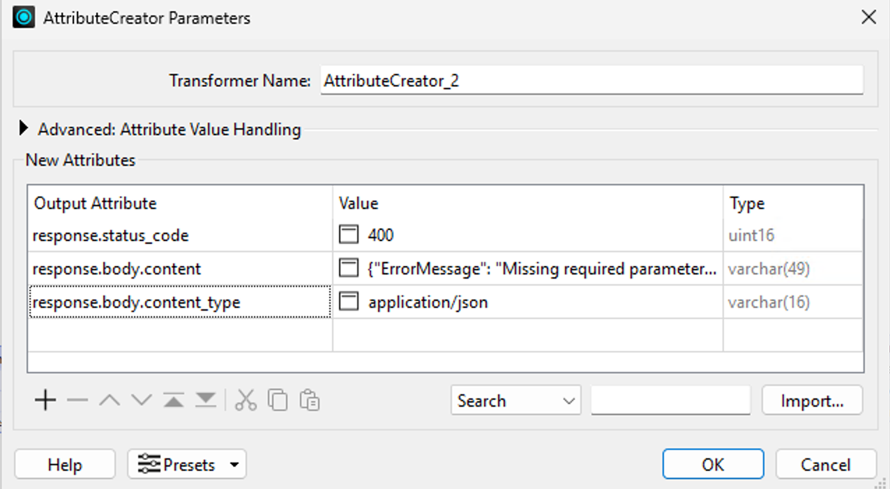

16. Format Failed Response Attributes
Recall we created a second status code, 400 - Bad request, for request bodies that were missing the required parameters.
Add another AttributeCreator to the canvas. This time, connect it to the Failed port of the AttributeValidator. Open it up to configure the parameters.
Create the required response attributes for the ‘400 - Bad request status code.
    • Value: 400
    • Value: "ErrorMessage": "Missing required parameters"}
Click OK to close.
Connect the AttributeCreator_2 to the Data Virtualization Writer, http_response.
The unsuccessful (401) workflow is now complete.

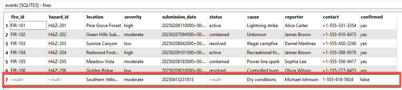

17. Test the Workspace

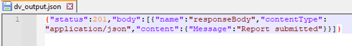

POST requests can also be tested locally with templates. Run the workspace to completion.
Review the response in the dv_output.json file. A simple 201 response indicates the SQLite database has been updated.
To confirm the update, open the events.sqlite database in the FME Data Inspector (if already open, refresh the data). The newly reported wildfire report is listed.
Save the workspace.

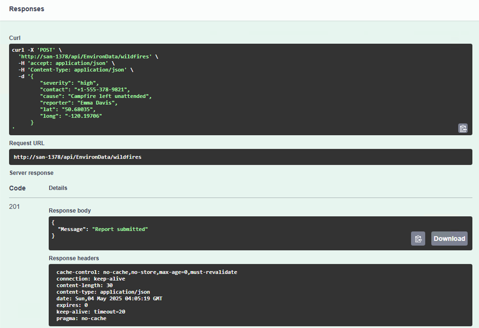

19. Test the Request from a Client
Find the POST /wildfires endpoint in the EnvironData API Swagger documentation (or another API client). Select Try it Out to test the request.
Replace the Wildfire event data with the following sample:
         "severity": "high",
         "contact": "+1-555-378-9821",
         "cause": "Campfire left unattended",
         "reporter": "Emma Davis",
         "lat": "50.68035",
         "long": "-120.19706”
Execute.
A 201 - Created response confirms that the POST /wildfires endpoint is successful.
