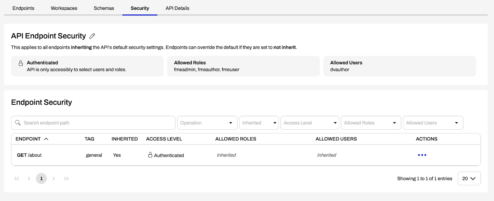

You can control access at two levels: for the whole API or for specific endpoints. That means that, within the same API, some endpoints may be public and others restricted.
You can give access to a specific user or to a role. If you assign per role, everyone in that role can access the endpoint. If you assign it to per individual user, only that user can access the endpoint.
Keep in mind that a user might get access through both their role and their personal account. So if you ever need to remove someone’s access, make sure to check both.

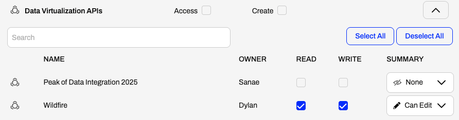

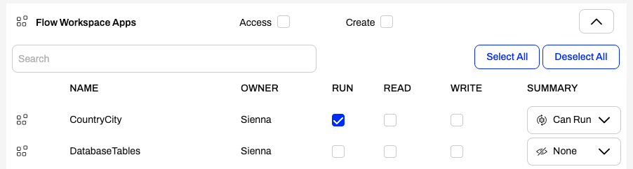

For Flow Apps, you can limit a token to specific items when you create it. For example, this token is authorized to run a Flow app, called “CountryCity”:
But for Data Virtualization APIs, API token access is not controlled in the same way. Item-level permissions do not apply. For example, this token would NOT authorize requests to the Wildfire API endpoints:
The above token would only give access to view and edit the API configuration in FME Flow, which wouldn’t be useful for making a request.

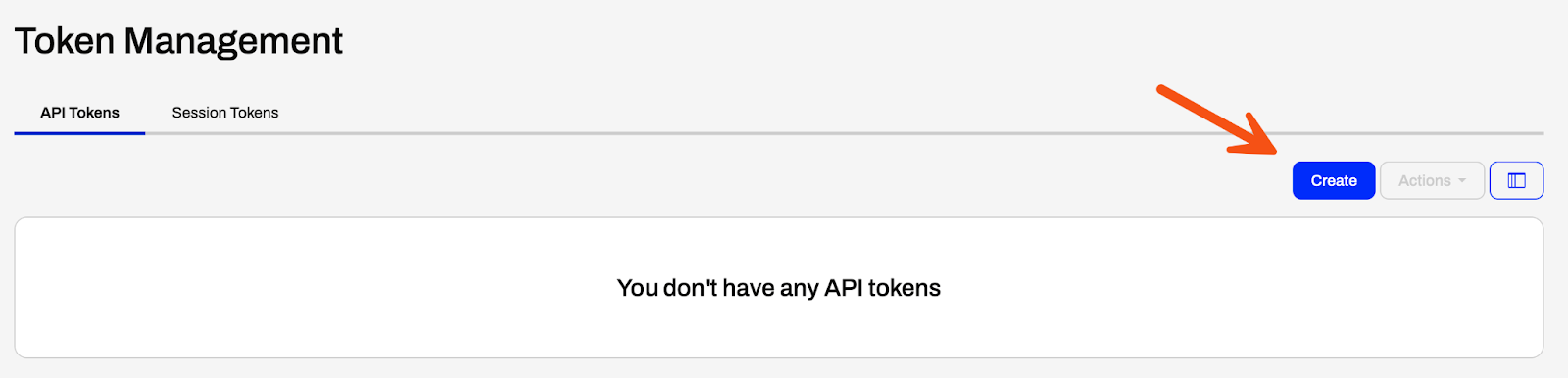

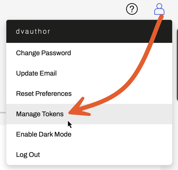

In FME Flow, click on the User Settings icon in the top-right corner to open the drop-down menu, then click Manage Tokens.

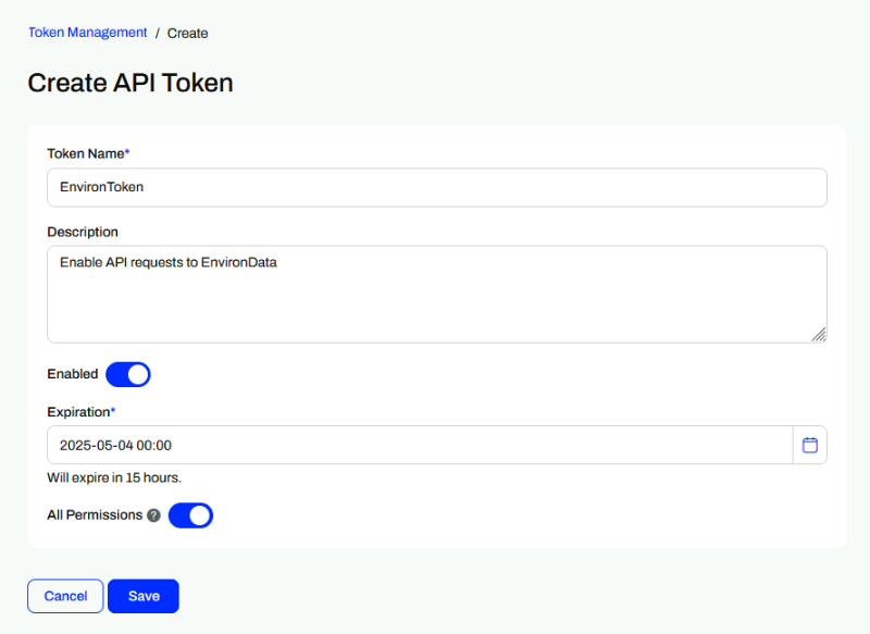

On the Token Management page, select Create.
Configure a token to use with Data Virtualization API testing:
Token Name EnvironToken
Description Enable API requests to EnvironData
Enabled Yes
Expiration Default
All Permissions Yes
Review the configuration and click Save to create the token.

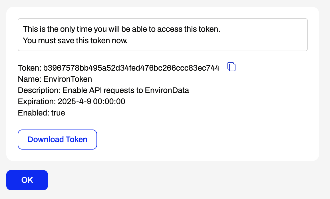

On the confirmation page, click Download Token to save a copy of the token information as a text file to your local machine.
This is the only time the full token value will be visible. If you do not download the file or copy the token now, you will need to repeat the process to generate a new API token.

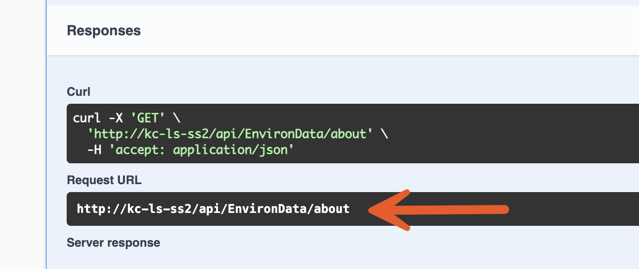

Next, we test the token in an API request to the GET /about endpoint. In order to get the endpoint URL, navigate to the EnvironData Swagger documentation.
If you make a request within the documentation page, it will return the Request URL. Copy the Request URL from the GET /about response.
Otherwise, manually create a request URL using the standard endpoint format: https://<FME Flow URL>/api/EnvironData/about

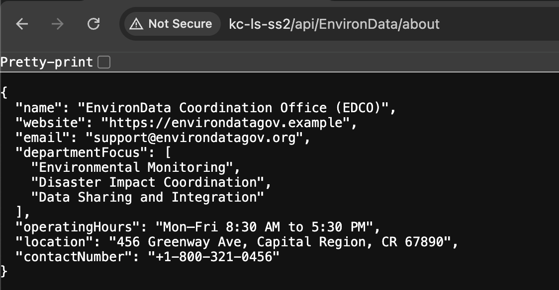

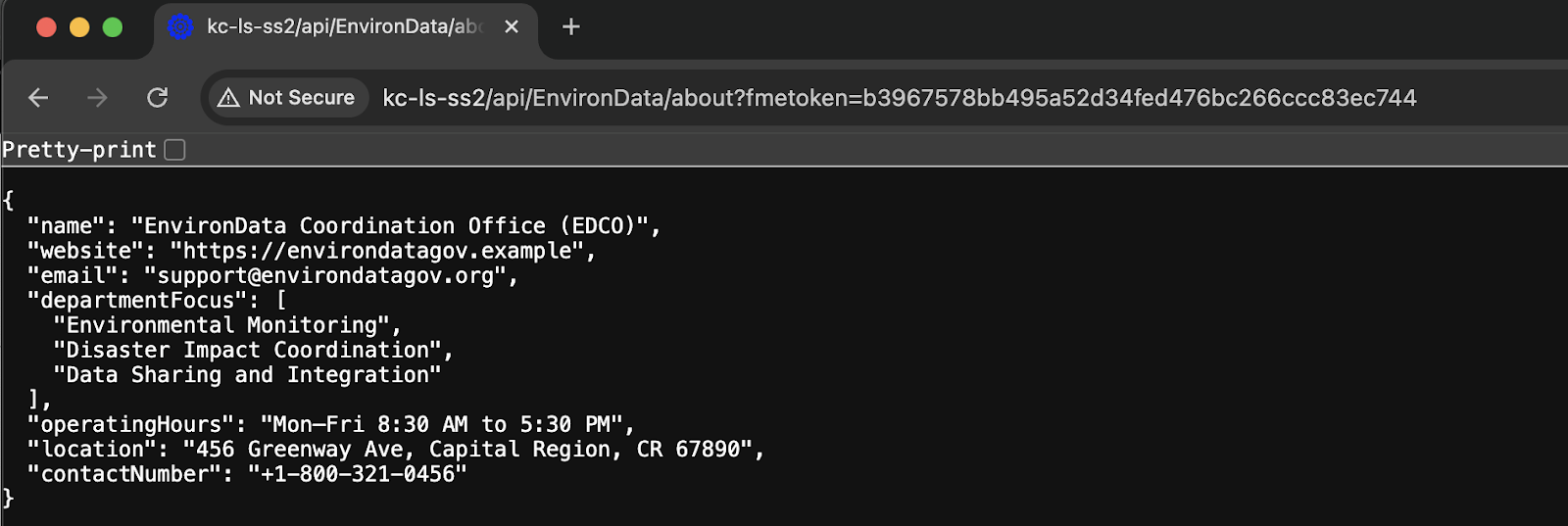

In that window, paste the full URL for the GET /about endpoint. But don’t use the plain URL, since that would just ask you to log in. Instead, append the API token as a query string. It should look like this:
http://<FME Flow URL>/api/EnvironData/about?fmetoken=<API-token>
Replace <API-token> with the actual token value generated earlier. You can copy this value from the text file you downloaded during token creation.
After entering the modified URL, press the Enter key to send the request. If the token is valid, the API will return the expected response, confirming that authentication using a query string parameter works as intended.

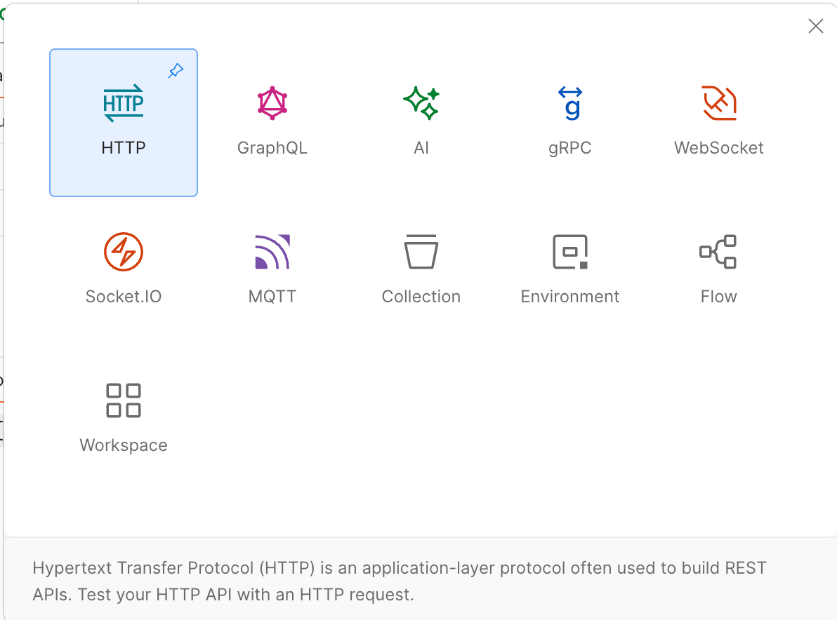

Unlike query parameters, API request headers can't be easily added through a browser. To demonstrate how to make authenticated requests using headers, we’ll use a third-party API client, Postman. Postman is free and can be accessed via a web browser or downloaded as a desktop application. If Postman isn’t available on your machine, the same request can be replicated using the HTTPCaller or OpenAPICaller transformer in FME Workbench.
In Postman, start by creating a new HTTP GET request. To do this go to File > New > HTTP.

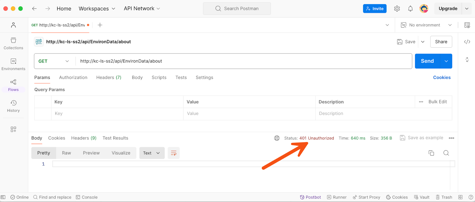

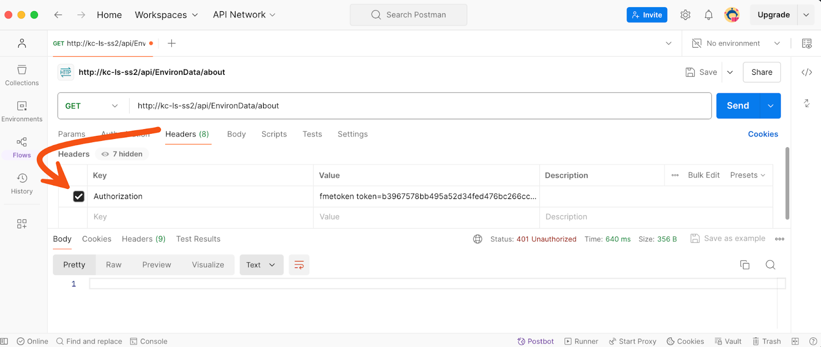

In the new GET request, paste the same /about endpoint Request URL from earlier, but remove any query string parameters (i.e., do not include ?fmetoken=...).
If you send the request without authentication, the EnvironData API will return a “401 Unauthorized” status code.

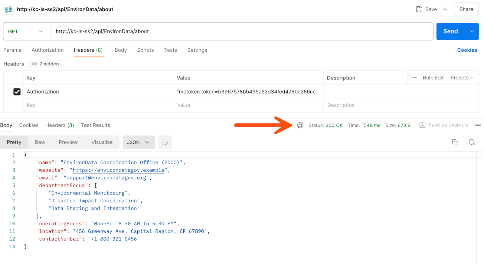

To submit an authenticated request using an API token in the headers, click the Headers tab in Postman. Configure a new header in the table.
Key Value
Authorization fmetoken token=<API-token>
Replace the <API-token> placeholder with the value from your EnvironToken text file.
Click Send. If the token was correct, a 200 OK status code and response body will be returned.

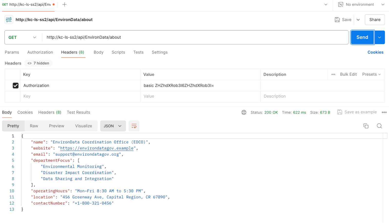

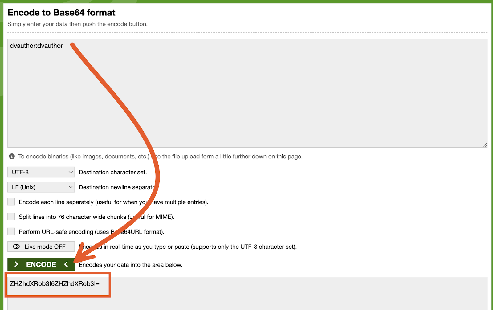

To test this method, create a new HTTP request in Postman and enter the same GET /about request URL used in previous steps. Open the Headers tab to configure a new header. Unlike the previous example, this method does not use an API token. Instead, you'll generate a Base64-encoded string from your FME Flow username and password.
You can use an online Base64 encoder (such as base64encode.org) or the TextEncoder transformer in FME to perform the encoding. Enter your credentials in the format username:password, then encode the full string.
Once you have the encoded result, return to Postman and add a new header. Set the Key to “Authorization” and the Value to “Basic <base64-encoded "username:password">”, replacing the placeholder with your actual encoded string.
Key Value
Authorization Basic <base64-encoded "username:password">
Send the request. If the credentials are valid, the EnvironData API will respond with a “200 OK” status and response body.

When the EnvironData API was set up, it was secured by default. That means the GET /about endpoint also required authentication. But sometimes, you may want different security settings for a specific endpoint.
In this case, the EnvironData Coordination Office wants GET /about to be public so users can access general info without logging in.
To do this, navigate back to the API in FME Flow. From the Endpoints tab, select the GET /about endpoint. In the Details tab, find Endpoint Security and turn off Inherit API Setting. This will load more security options.
