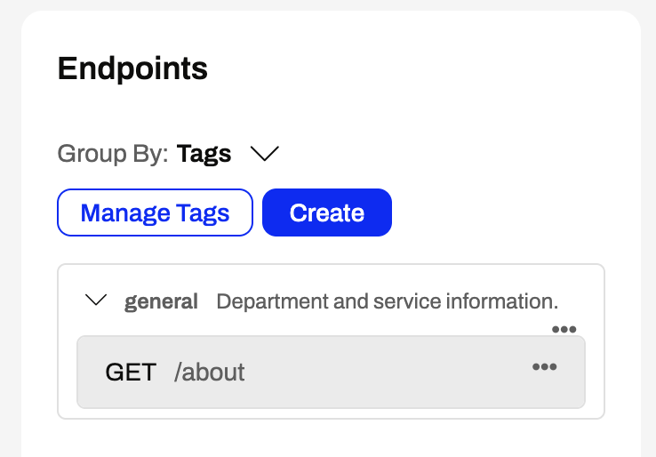

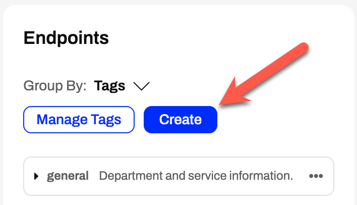

1. Create a Tag

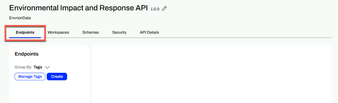

From the Environmental Impact and Response API page in FME Flow, click the Endpoints tab. Here you can create, update, organize, or delete endpoints.
Over time you’ll have many endpoints here. Use tags to group related ones (by topic, data source, parameters, or schema). Tags also help end-users quickly find what they need in the documentation.

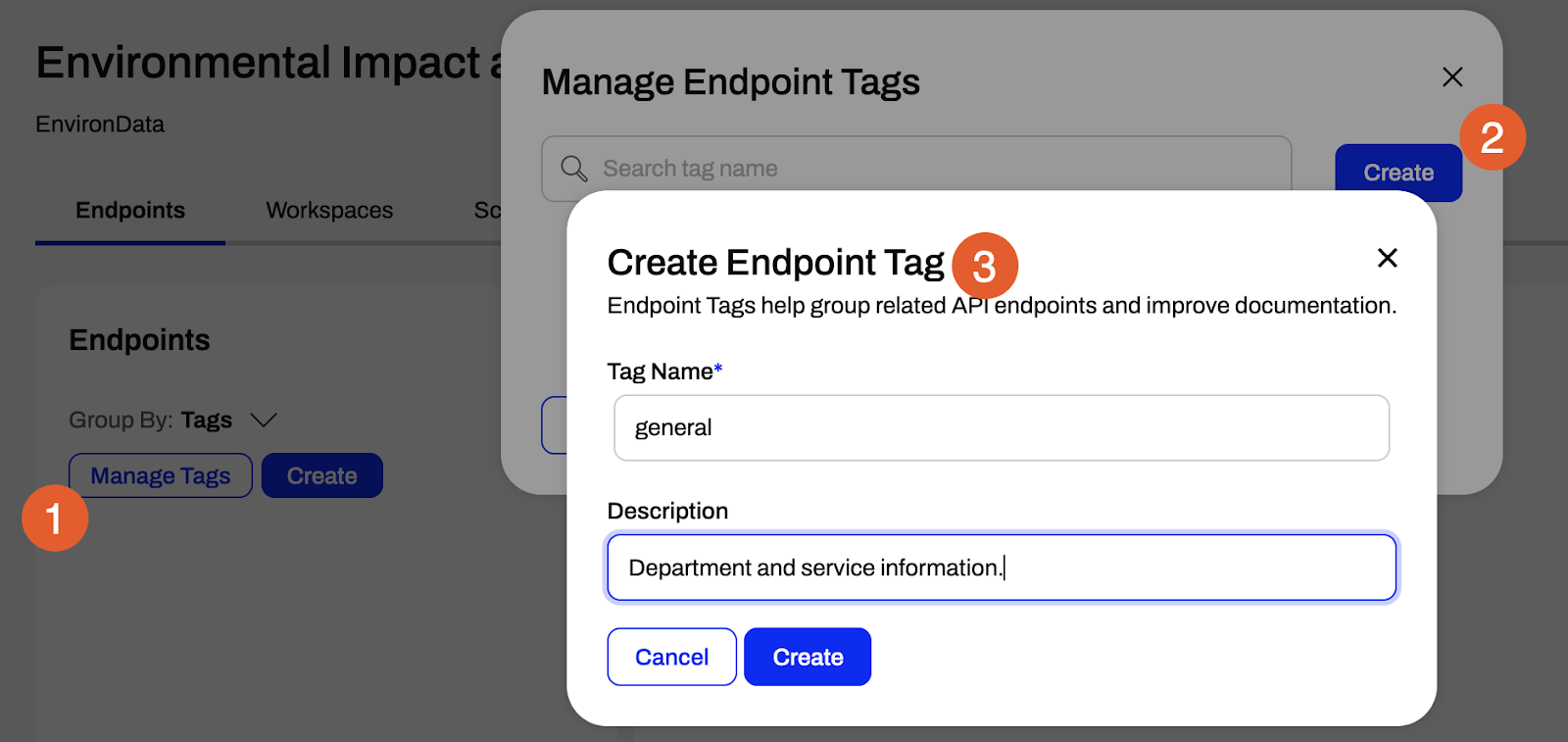

Click the Manage Tags.
Click Create and enter:
  • Tag Name: general
  • Description: Department and service information.

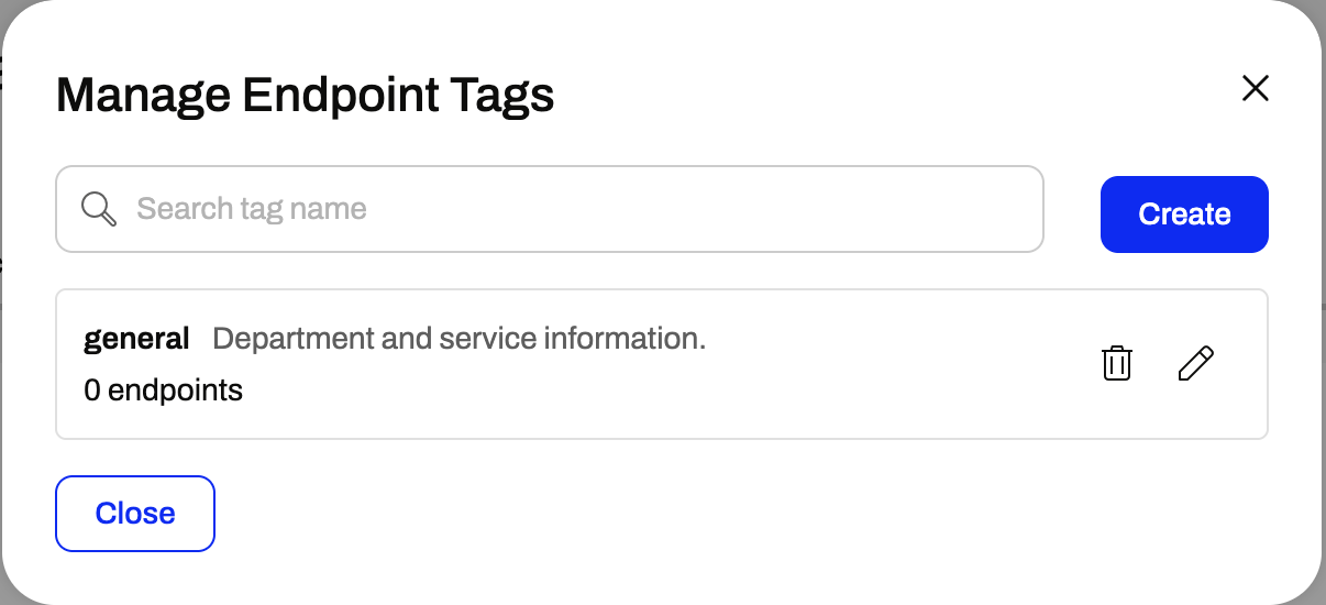

Click Create.
The new general tag is now listed.
Click Close to return to the Endpoints tab. The new general tag is now listed, and endpoints can be added to it.

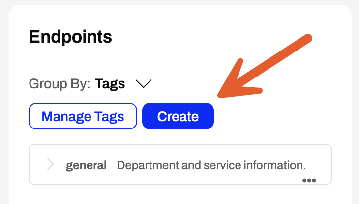

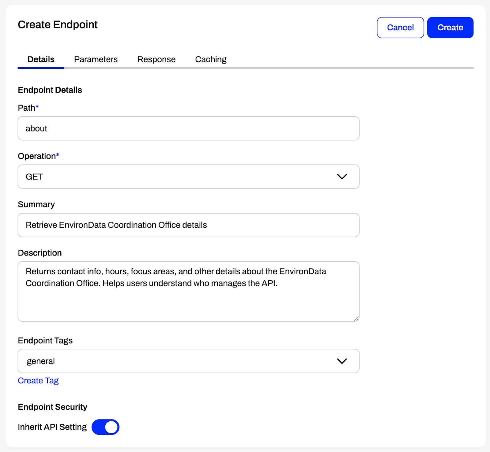

2. Create a Manual Endpoint

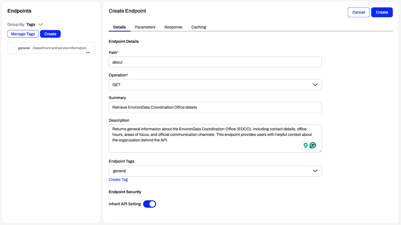

Click Create to open the Create Endpoint dialog.
Enter the following values:
Path about
Operation GET
Summary Retrieve EnvironData Coordination Office details
Description Returns contact info, hours, focus areas, and other details about the EnvironData Coordination Office. Helps users understand who manages the API.
Endpoint Tags general
Inherit API Setting* Enabled
*Endpoints can have individual security settings, or adopt the security configurations (such as authentication, users, and roles) from the parent API.

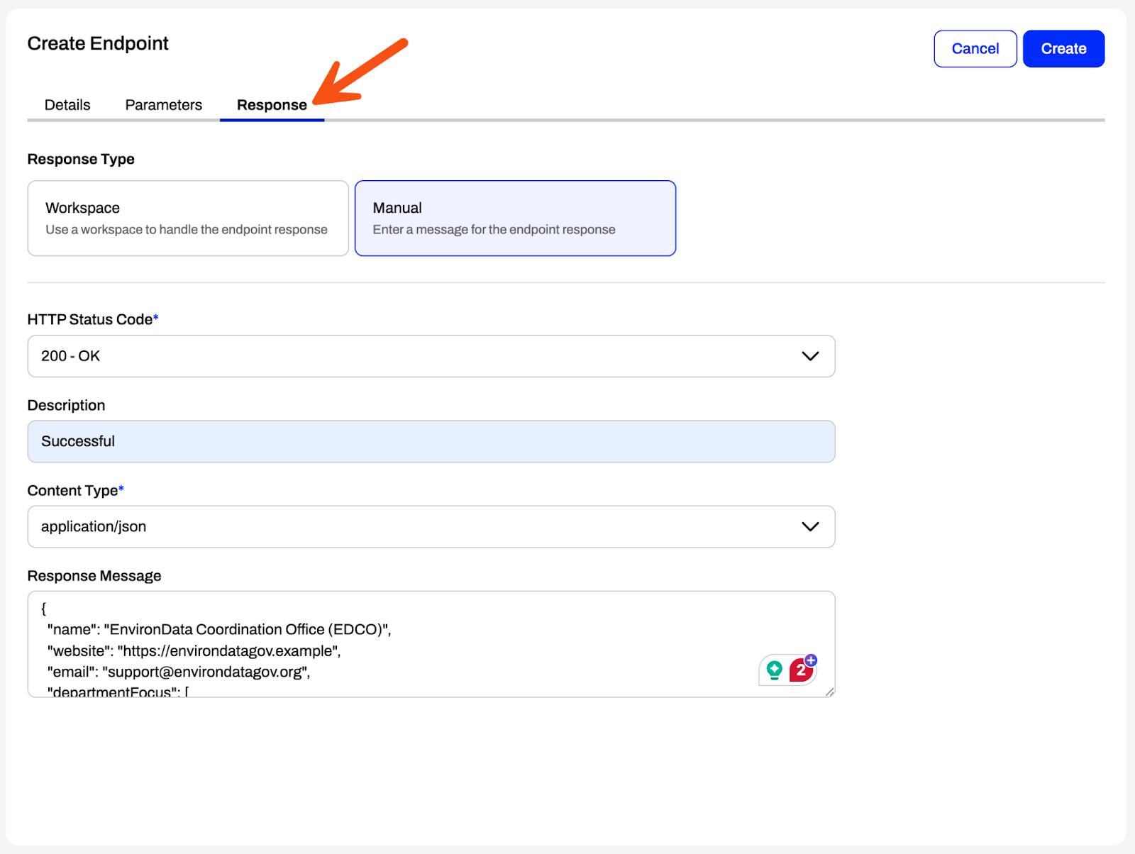

Next, go to the Response tab. Set Response Type to Manual.
Fill in:
HTTP Status Code 200 - OK
Description Successful
Content Type application/json
Response Message
  "name": "EnvironData Coordination Office (EDCO)",
  "website": "https://environdatagov.example",
  "email": "support@environdatagov.org",
  "departmentFocus": [
    "Environmental Monitoring",
    "Disaster Impact Coordination",
    "Data Sharing and Integration"
  "operatingHours": "Mon–Fri 8:30 AM to 5:30 PM",
  "location": "456 Greenway Ave, Capital Region, CR 67890",
  "contactNumber": "+1-800-321-0456"

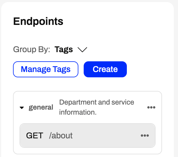

Click Create to finish. The new GET /about endpoint now appears under the general tag.

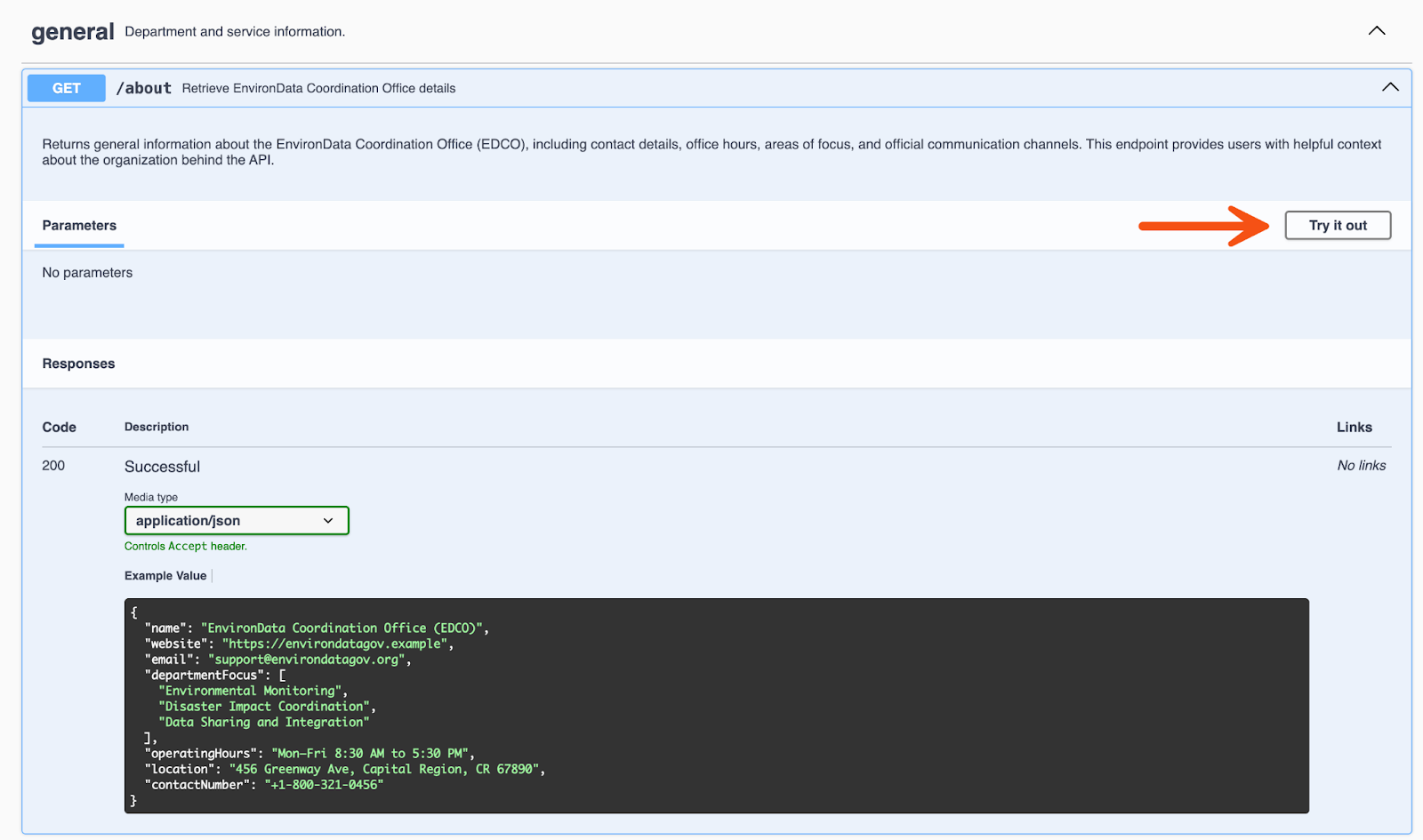

3. Make a Request from the Documentation

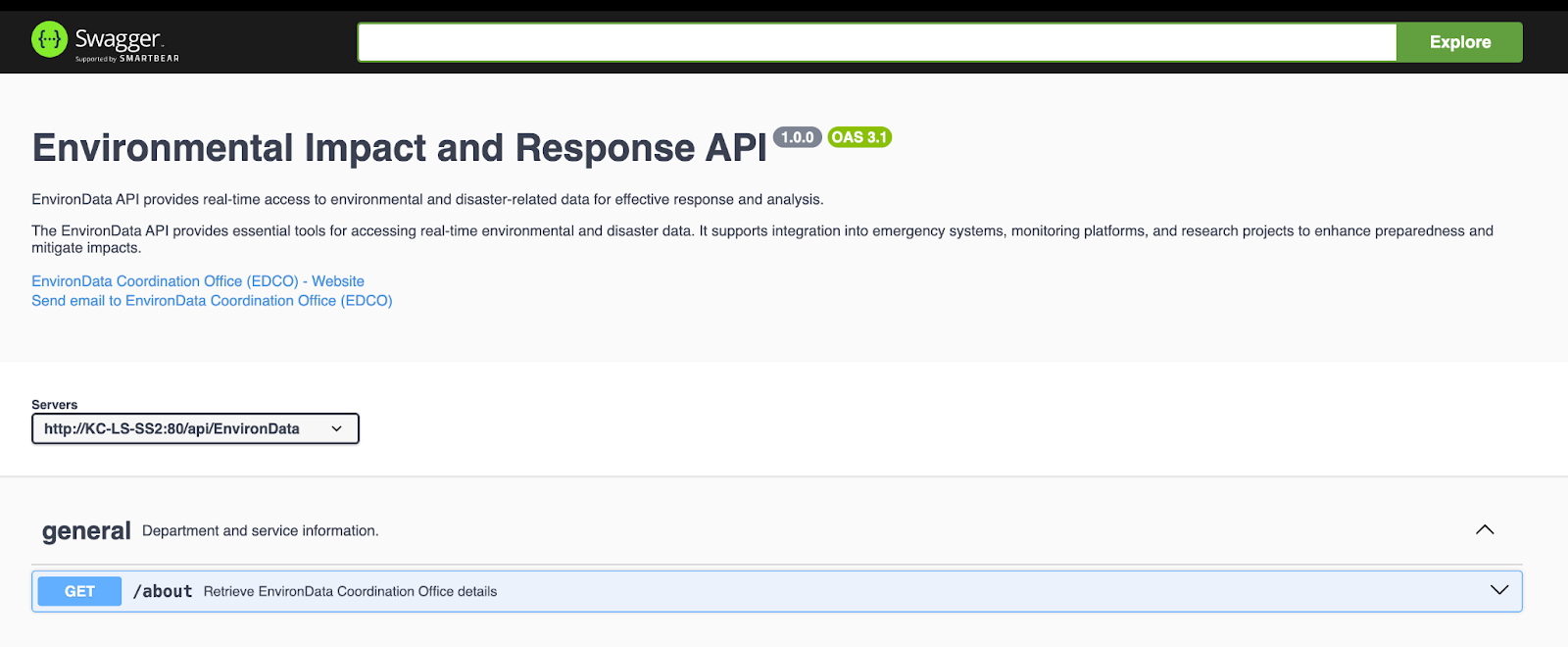

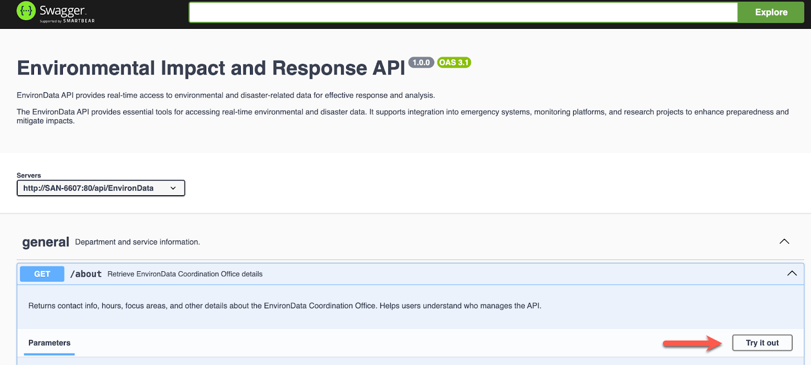

In FME Flow, open the API Details tab and launch Swagger (View Documentation).

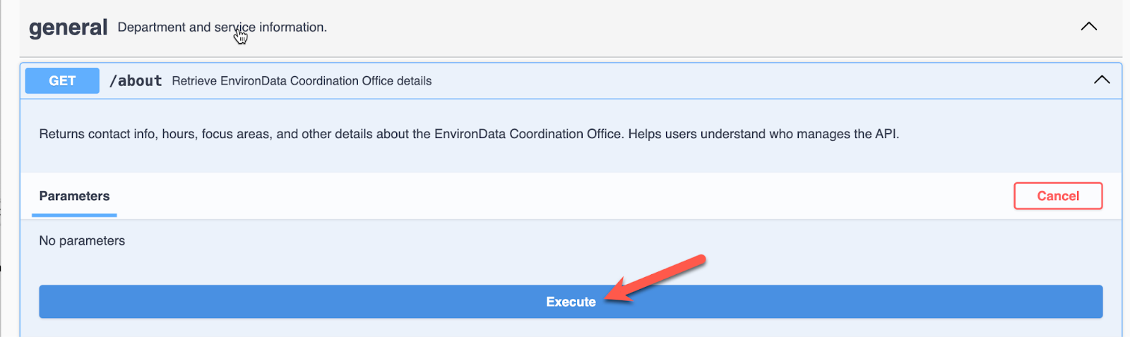

Click the GET /about endpoint to expand the request details. Click the Try it Out button to test a request.

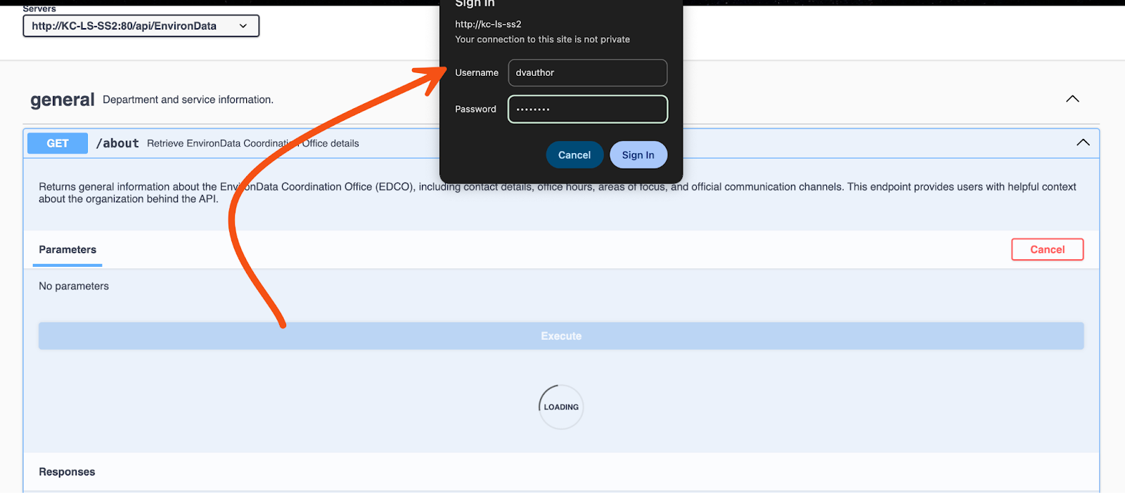

Click Execute to make the request.
NOTE: Since the EnvironData API requires authentication, a login window may appear. Enter your FME Flow credentials to create a temporary session token for testing requests in Swagger.

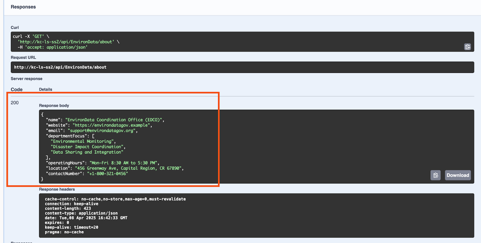

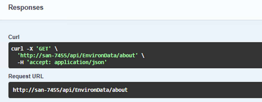

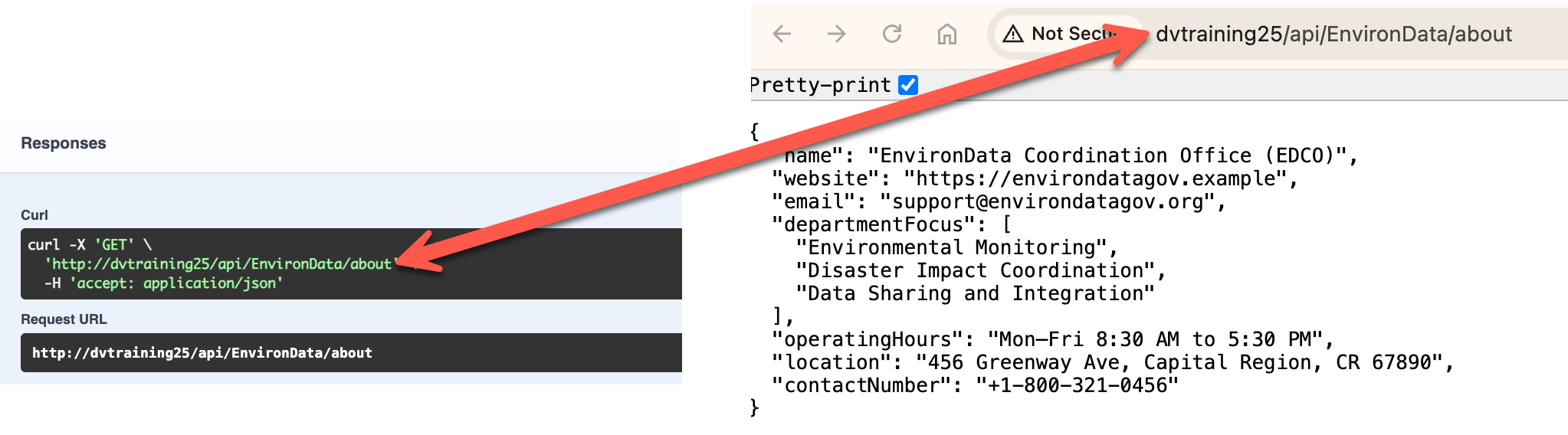

Once submitted, the request runs and the response appears under Server Response. You should see a 200 OK with the JSON body.
If credentials are wrong, you’ll see 401 Unauthorized.
Swagger is a powerful way to test endpoints in real time. You can try different parameters, credentials, and error conditions—all without writing code. Swagger also shows an example Curl request and the Request URL, which you can copy for use in other apps.
3. Copy Request URL
For the next tutorial, you’ll need the Request URL.  Copy the Request URL and continue to Secure Data Virtualization Endpoints with Authentication. Also, leave the Swagger documentation open for quick reference.
