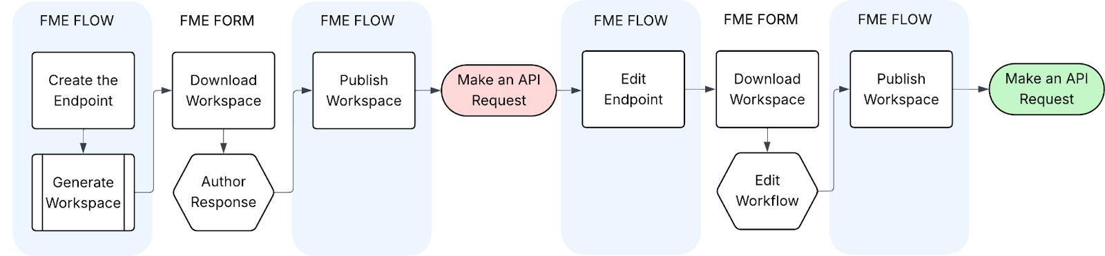

When you publish a Data Virtualization workspace, any changes made later to its endpoint settings in FME Flow will set the workspace status to Needs Updating.
When this happens, download the workspace again in FME Workbench so it reflects the new configuration. The new parameters will appear in the reader, ready to be used in your workflow before republishing to FME Flow.

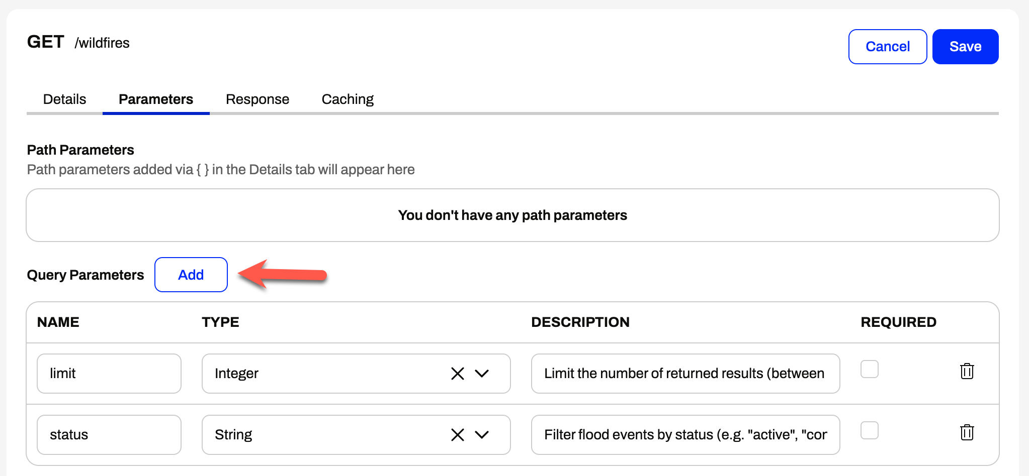

1. Add Query Parameters to an Existing Endpoint
In FME Flow, open the Data Virtualization EnvironData API and go to the Endpoints tab. Select the GET /wildfires endpoint, then open the Parameters tab.
Next to Query Parameters, click Add. Create two query parameters: limit and status.
NAME TYPE DESCRIPTION REQUIRED
limit Integer Limit the number of returned results (between 1 and 1000) No
status  String Filter wildfire events by status (e.g., "active", "contained", "resolved" ) No
Keep both parameters optional so users can decide whether to include them in a request.
Optional parameters make the API more flexible, allowing requests that either use or skip filters.

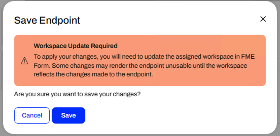

2. Save to Update an Endpoint
Click Save to confirm the new parameters.
When you save, FME Flow will display a warning message indicating that the connected workspace must be updated.
This ensures that the workspace and endpoint stay synchronized.
Click Save again to continue.

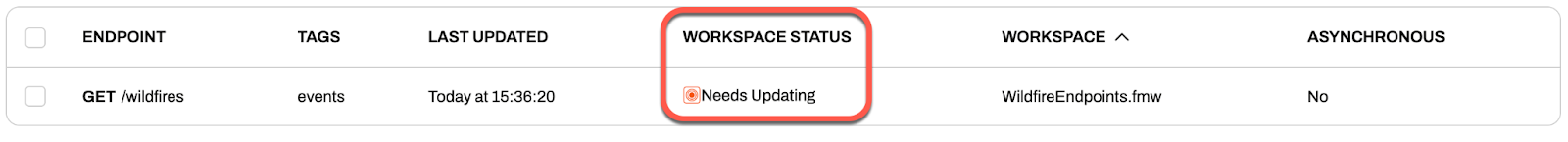

To verify this, go to the Workspaces tab and find the GET /wildfires endpoint.
Its Workspace Status should display Needs Updating, meaning the workspace must be updated and republished before the changes become active.

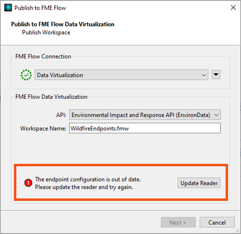

When endpoint metadata changes in FME Flow, the connected workspace must be updated or redownloaded to stay synchronized.
You cannot publish a workspace that is out of sync with its endpoint definition.
If FME Workbench is already open with the workspace loaded, click Publish. FME will detect that the endpoint metadata has changed and display the Update Reader dialog.
Select Update Reader to apply the new parameters before continuing.

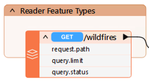

2. Confirm New Parameters in the Reader
Once the workspace is updated, expand the GET /wildfires feature type in the Data Virtualization reader.
You should now see two new attributes: query.limit and query.status.

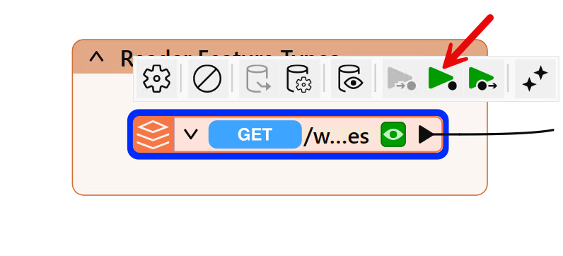

3. Run a Request in Workbench
When building or testing Data Virtualization workspaces, you can simulate API calls directly in FME Workbench.
To test locally:
  • Open the mini-menu on the GET /wildfires feature type.
  • Select Run Just This.

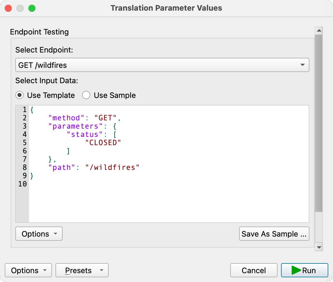

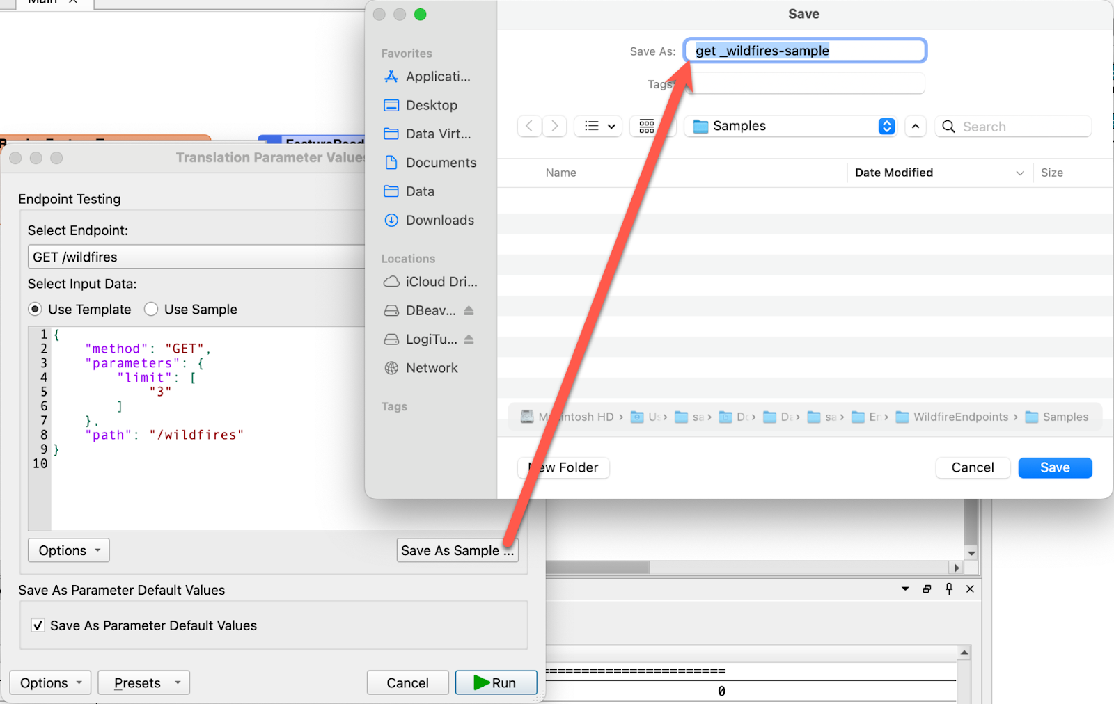

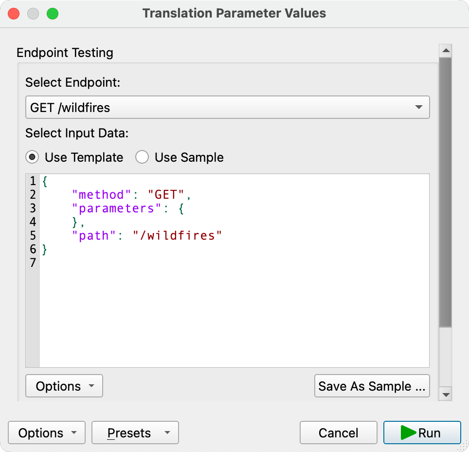

In the Translation Parameter Values window, the request template now has parameters to configure.
Update the placeholder values with test values. Replace “<integer>” with “3” and remove the “status” parameter entirely.
  "method": "GET",
  "parameters": {
    "limit": [
      "3"
  "path": "/wildfires"
This template imitates the request: http://<FME Flow>/api/EnvironData/wildfires?limit=3

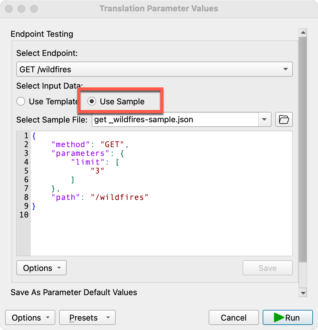

You can also save this configuration for reuse. Select Save As Sample, and FME will automatically store it in a “Samples” folder in your local EnvironData directory.

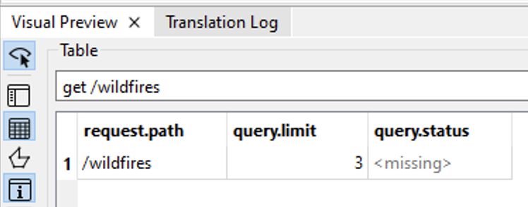

Click Run. When the translation finishes, open the Visual Preview window to confirm that the query parameters appear as attributes with your test values.

To test your changes, rerun the workspace using the sample request created earlier.
If prompted for Translation Parameter Values, select your saved sample.

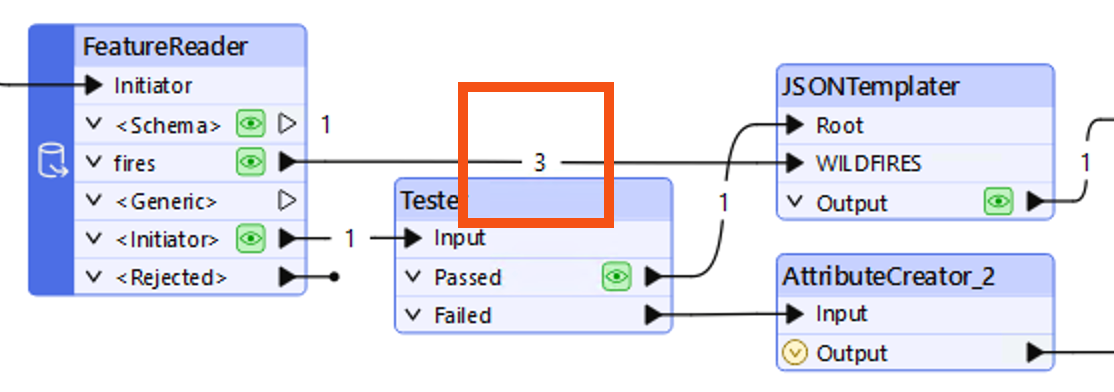

When the translation finishes, open the cache on the fires port of the FeatureReader.
You should see that only three records were read, confirming that the limit parameter is working correctly.

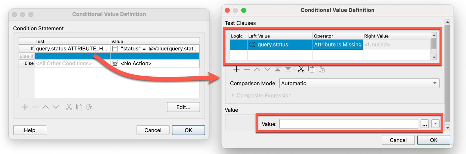

The status query parameter allows users to filter results dynamically. To make this work, you’ll create a WHERE Clause that uses the value of query.status to filter the database table.

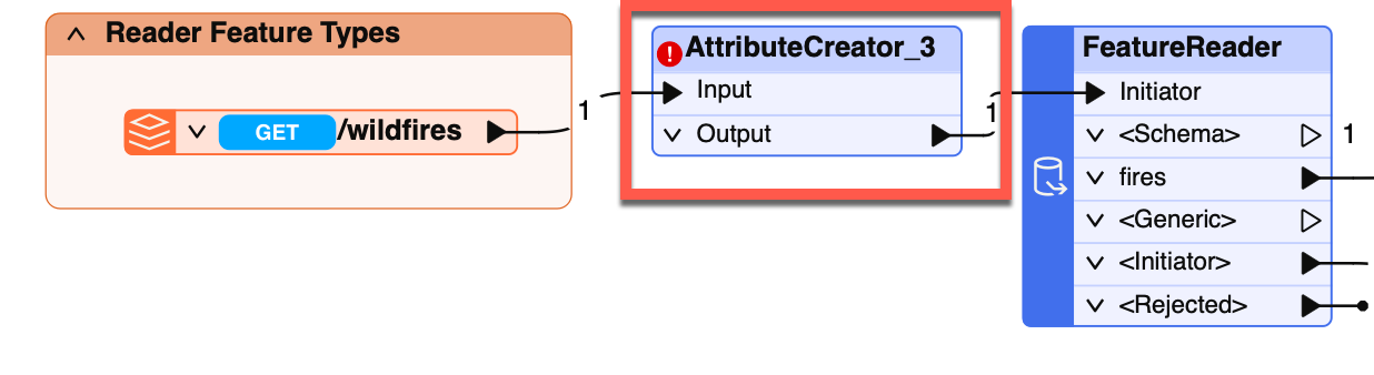

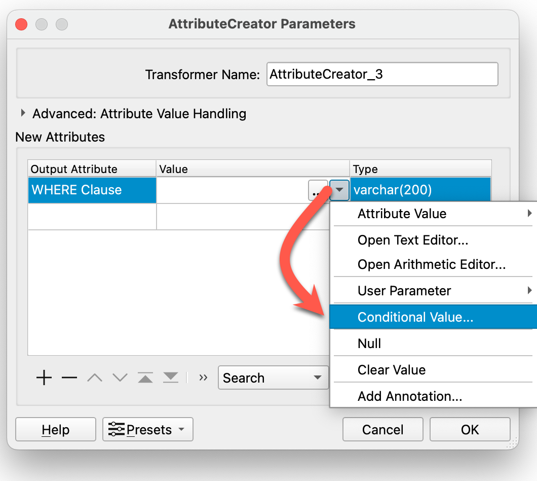

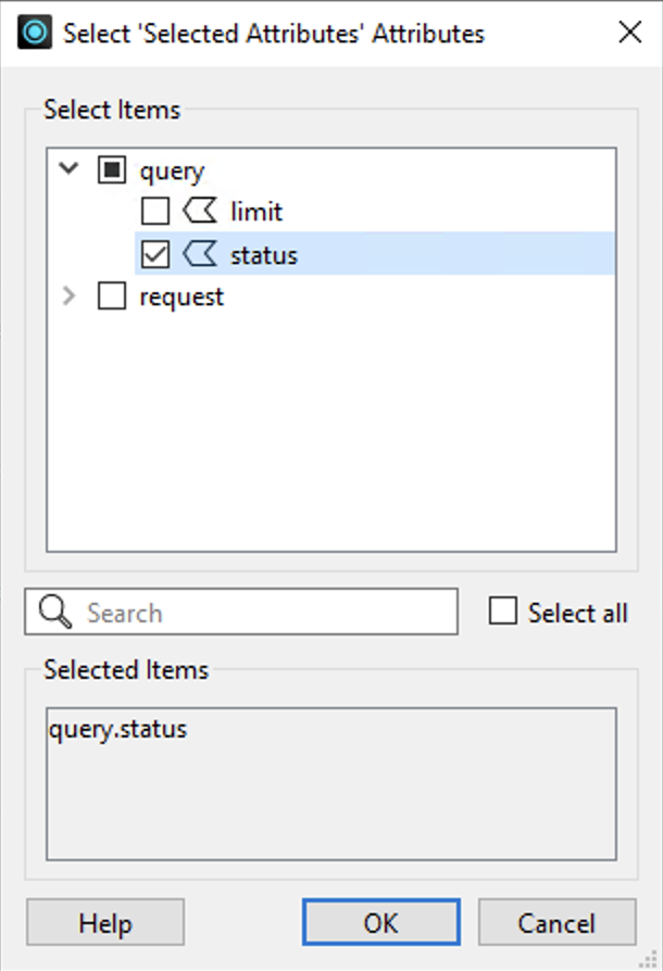

Add an AttributeCreator between the Reader and the FeatureReader. Make space on the canvas if needed to maintain a clear layout.
Open the AttributeCreator and create a new output attribute called WHERE Clause.

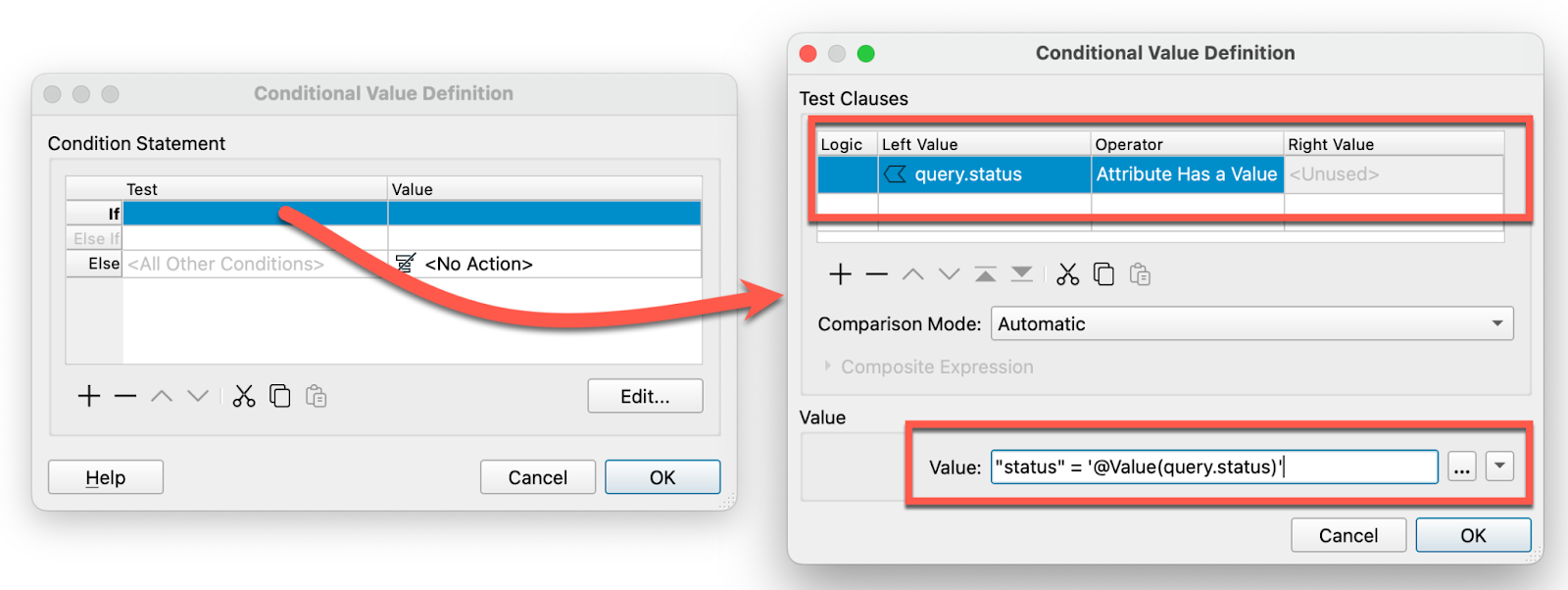

For its value, click the drop-down and select Conditional Values….
In the Conditional Value Definition window, add a condition that checks whether query.status has a value:
Logic Left Value Operator Right Value
query.status Attribute Has a Value
Set its value to: "status" = '@Value(query.status)'
In the next row, create another condition:
query.status Attribute is missing
This time, do not set a value.
Click OK to apply the change.
The final AttributeCreator should look like this.
OK to save.

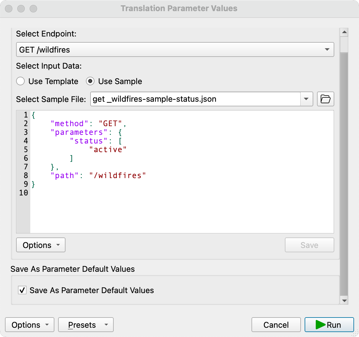

3. Run the Workspace with a Status Parameter
Next, test the status parameter using the same local testing workflow as before.

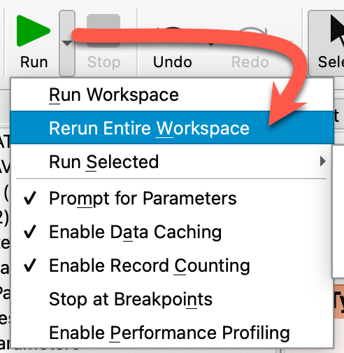

From the Run menu, select Rerun Entire Workspace.
This will refresh the request template.
This time, remove the “limit” query parameter and set the “status” value to “active”:
  "method": "GET",
  "parameters": {
    "status": [
      "active"
This template represents the request: http://<FME Flow>/api/EnvironData/wildfires?status=active
Save this as a sample for reuse (for example, get _wildfires-status.json).

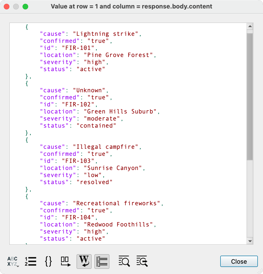

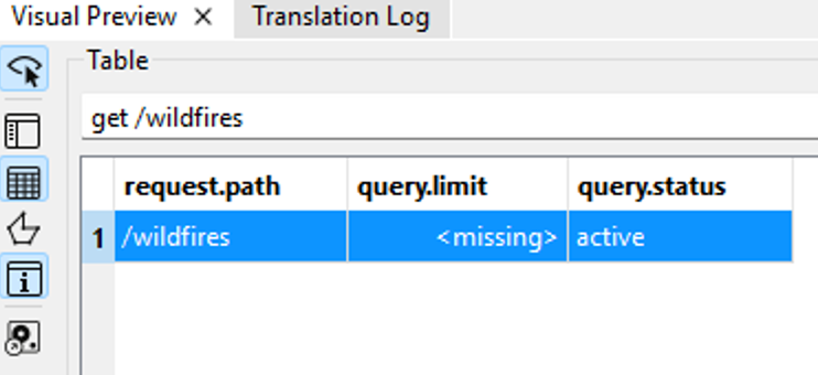

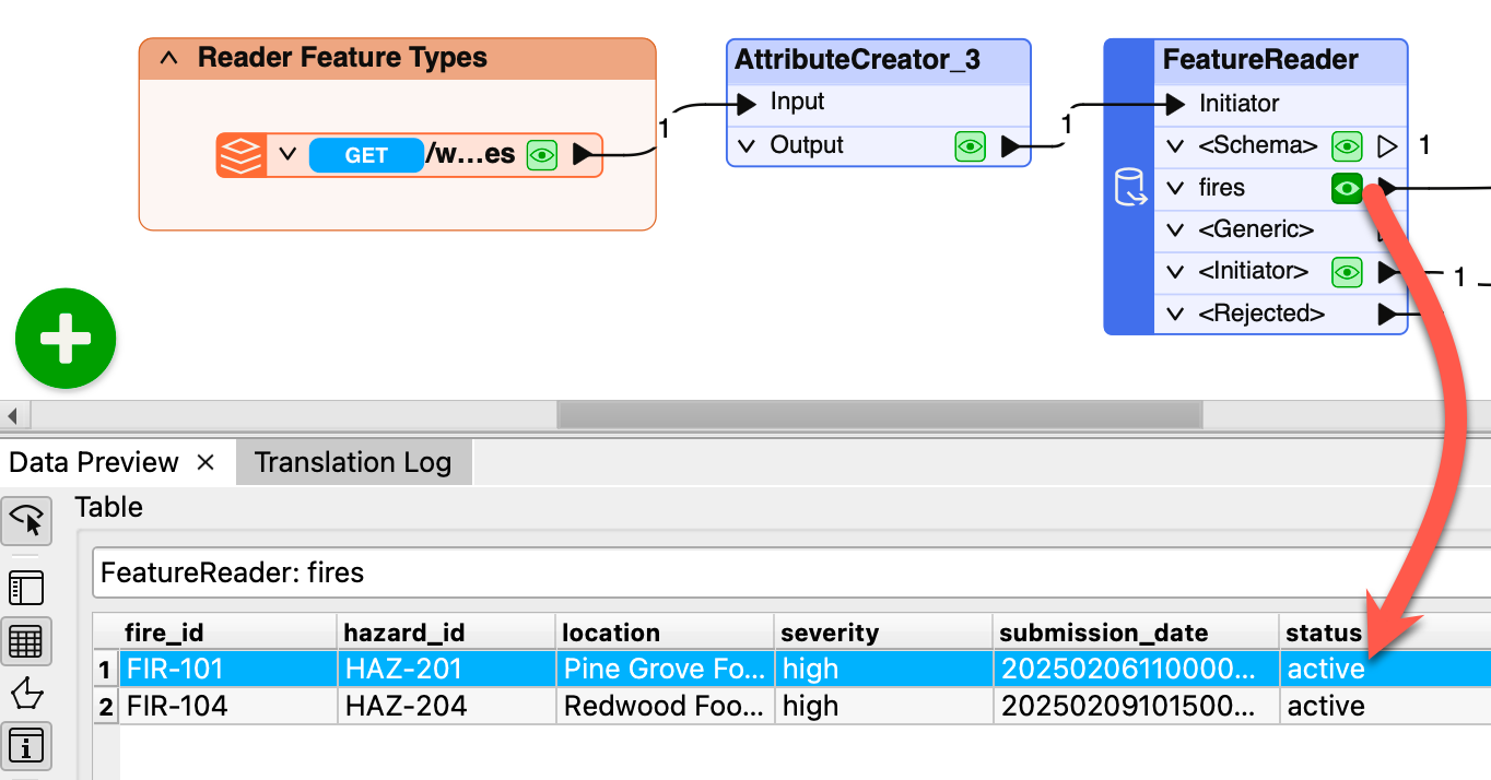

4. Verify the Filtered Results
Click Run, then open Visual Preview on the GET /wildfires reader to confirm the updated attribute values.
You should see that query.limit is missing, and query.status shows as active.
Next, inspect the cache on the fires port of the FeatureReader.
You should see only two records, both with the status active.
This confirms the WHERE clause is working.

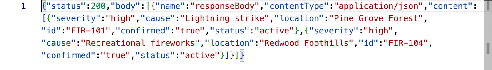

If you check dv_output.json, you’ll see the response body now contains only the filtered results matching the active status.

Rerun the Entire Workspace once more, this time removing all parameters from the request template:
  "method": "GET",
  "parameters": {
Click Run to execute.
The full fires table should now be returned, which is the expected behavior when no parameters are provided.

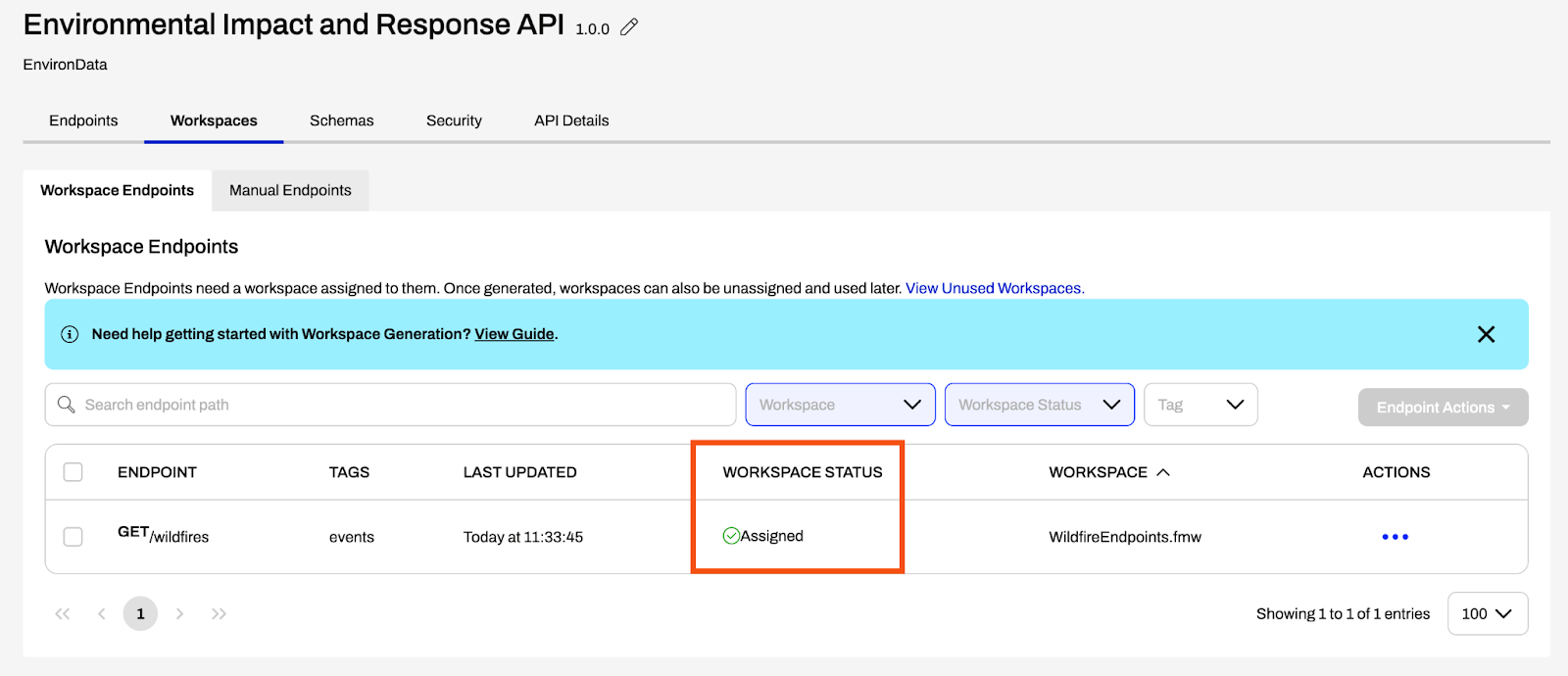

6. Publish to FME Flow
Once you’ve confirmed that filtering works correctly, publish the workspace to FME Flow to make your changes available through the live API.
In FME Workbench, click Publish.

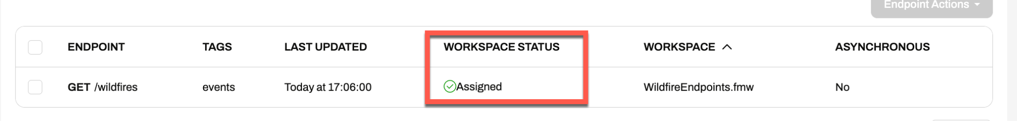

After publishing, open FME Flow and navigate to the Workspaces tab.
Verify that the GET /wildfires endpoint shows a Workspace Status: Assigned.
This indicates the workspace is linked and ready to handle API requests using your new filtering logic.

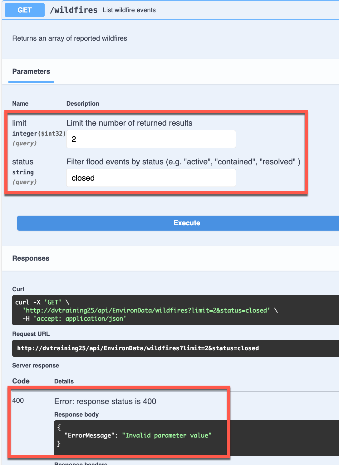

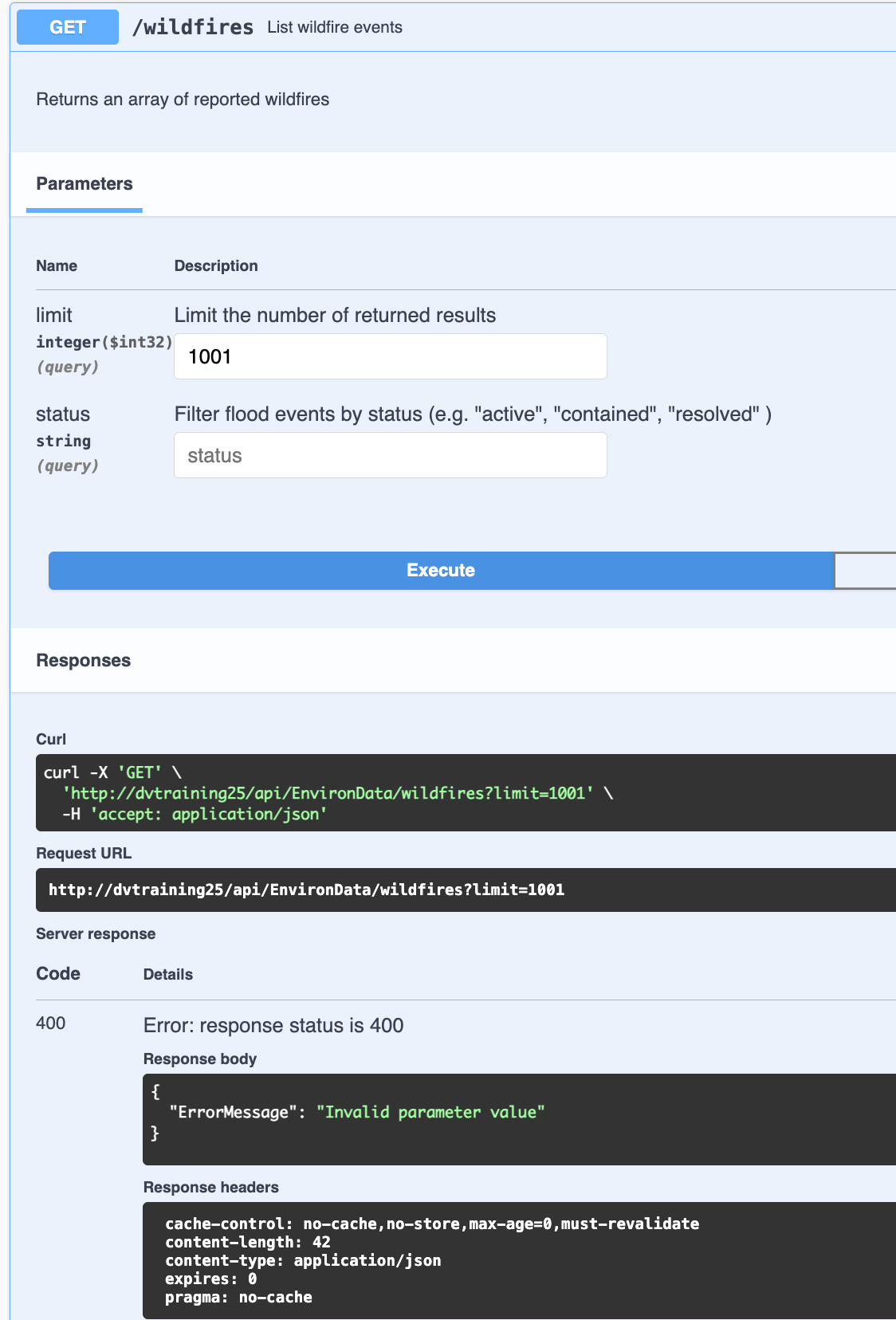

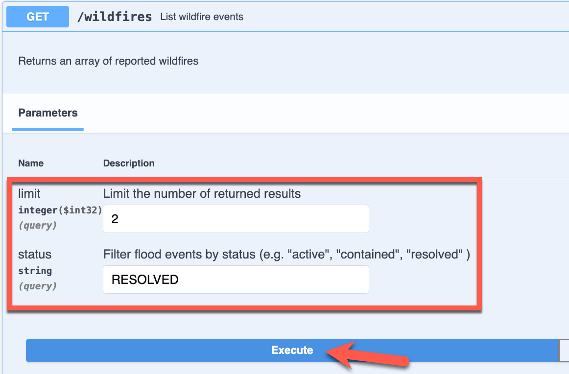

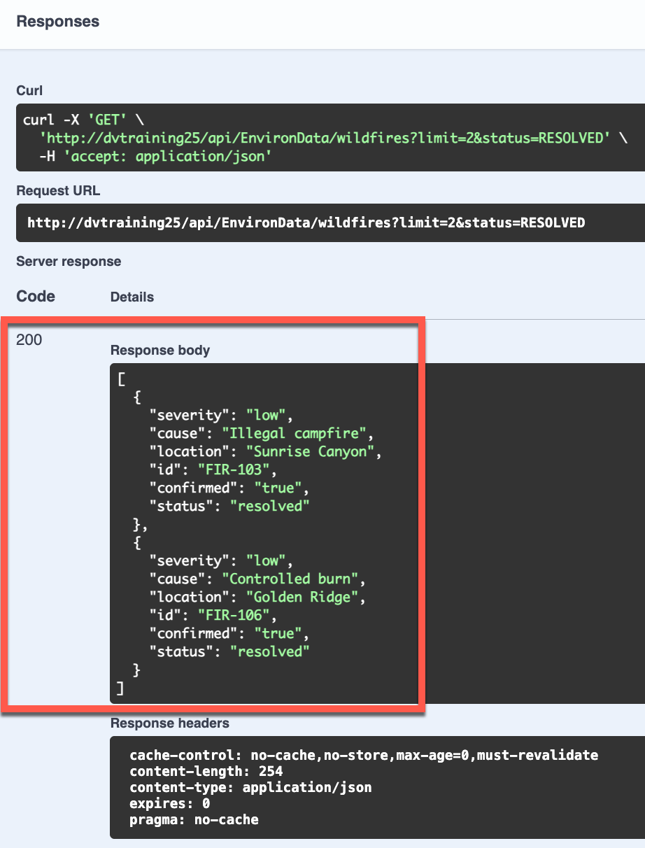

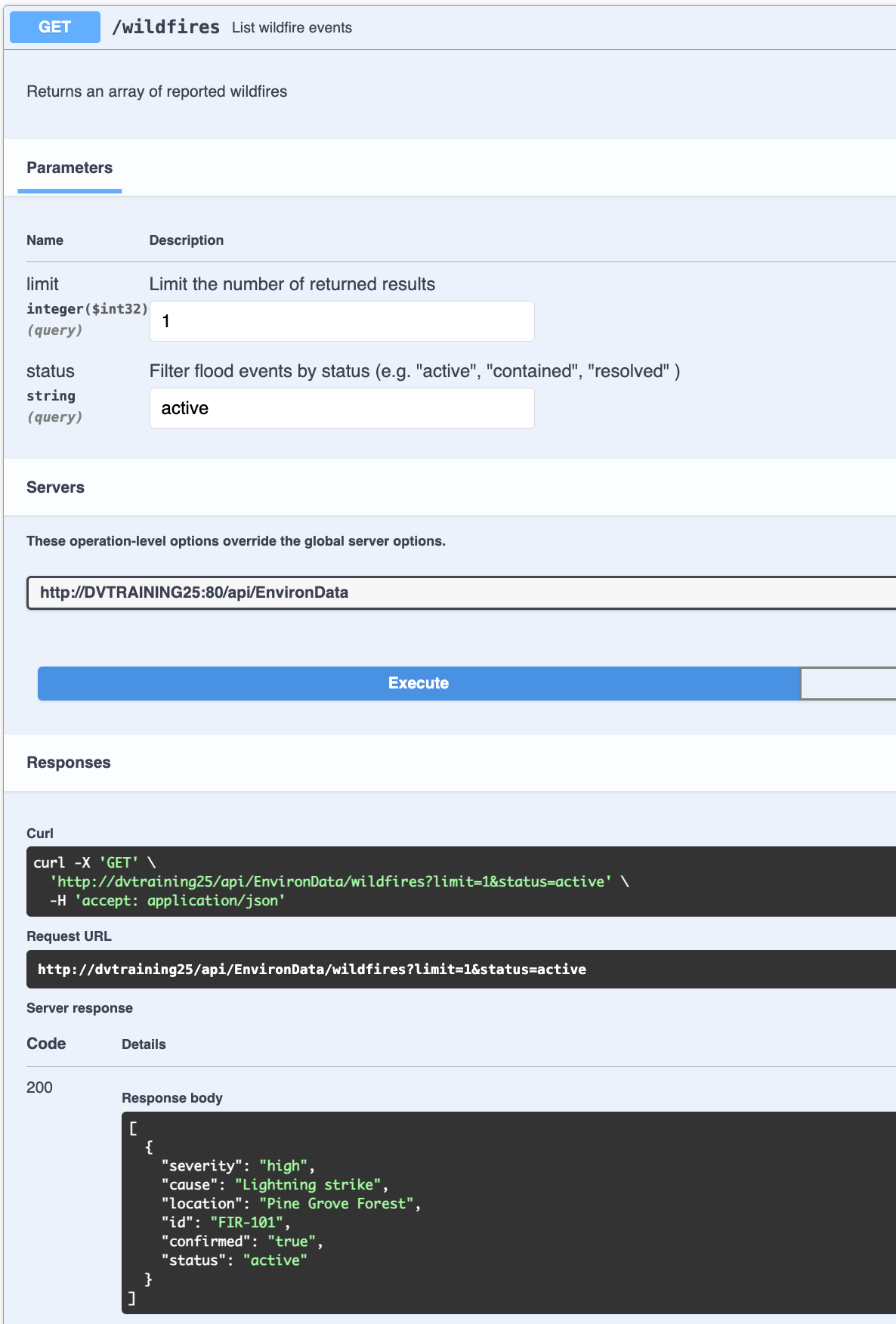

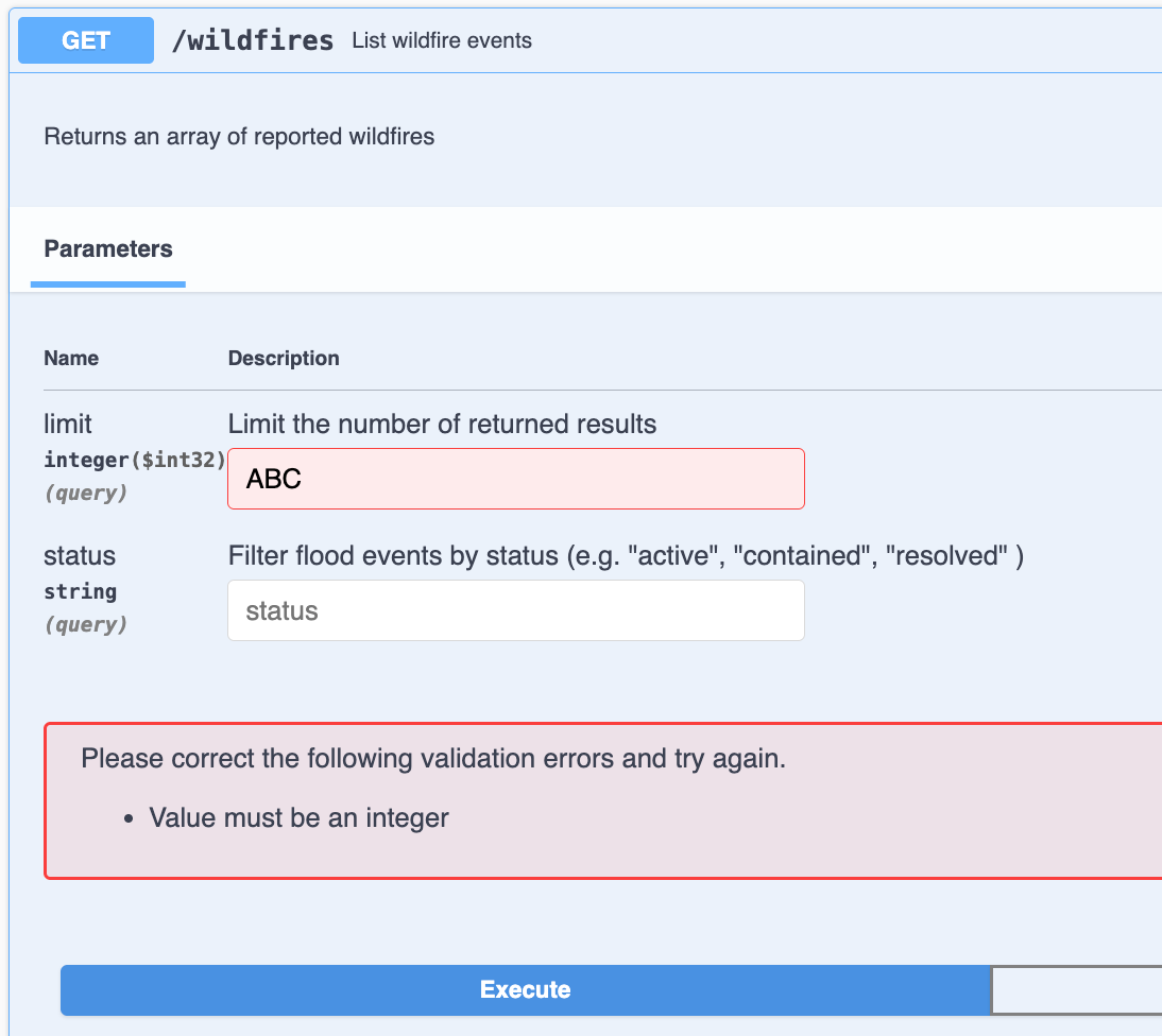

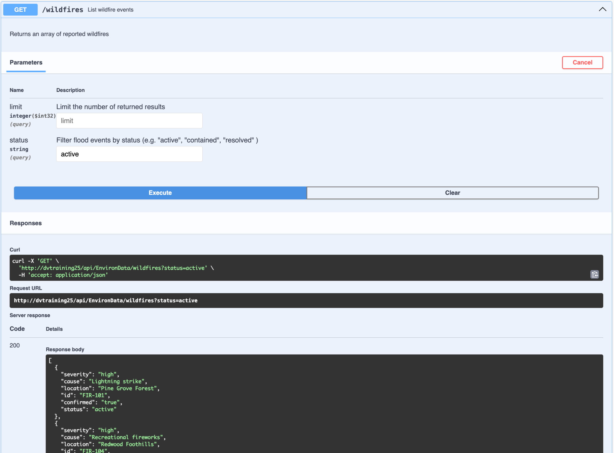

7. Test from API Documentation
Open the Swagger documentation for your EnvironData API and locate the GET /wildfires endpoint.
Click Try it Out, then enter the following test values for the parameters:
  • status= active
Try another test, this time adding a response size:
  • limit=1
  • status= active

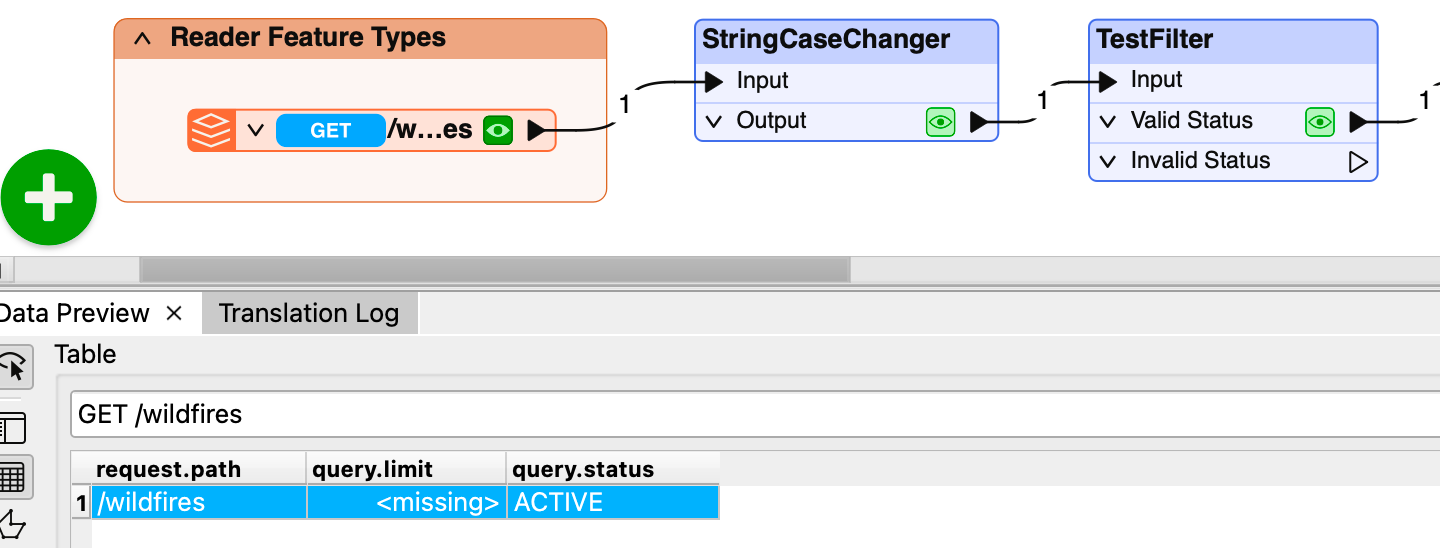

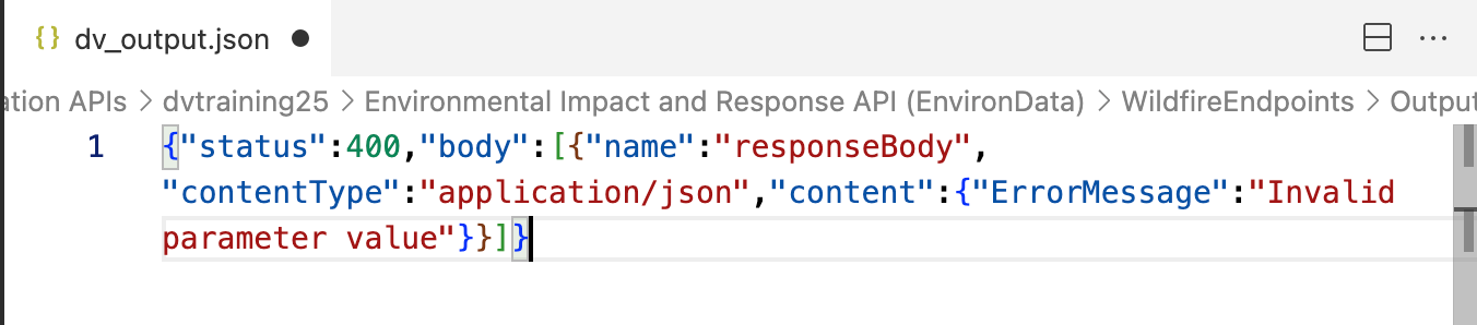

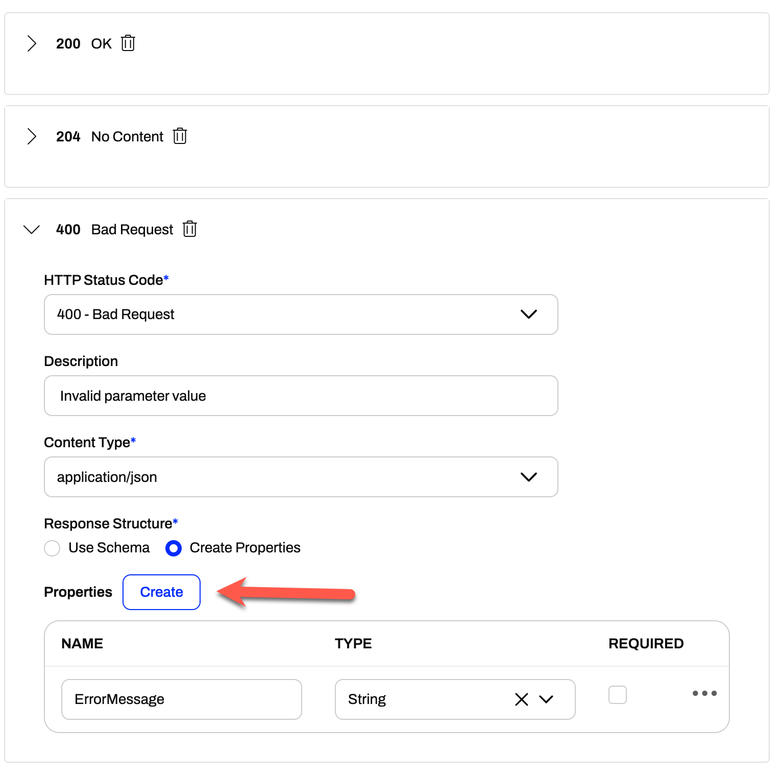

However, if you were to try an invalid value, such as status: ACTIVE or limit: -1, the API would return an undescriptive error.

In FME Flow, open the GET /wildfires endpoint.
Go to the Response tab and click Add Status Code. Configure it as follows:
HTTP Status Code 400 - Bad Request
Description Invalid parameter value
Content Type application/json
Input Type Create Properties
Responses don’t always need a predefined schema — you can define them with custom properties instead. This approach is useful for simple or unique responses and still shows clear examples in the API documentation.
Click Create next to Properties and add the following:
Name Type
ErrorMessage String
Save the endpoint.
2. Update the workspace
Whenever endpoint metadata changes, the workspace must be updated to stay in sync. This ensures new parameters or status codes appear correctly in your workflow.
In FME Workbench, open the workspace and update the reader:
  • Go to Publish > Update Reader, or
  • Redownload the workspace from FME Flow.
This ensures the workspace is in sync with the new endpoint definition.
(See Part 2 if you need to review these steps)

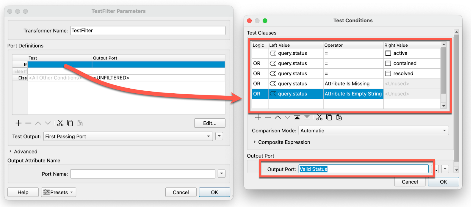

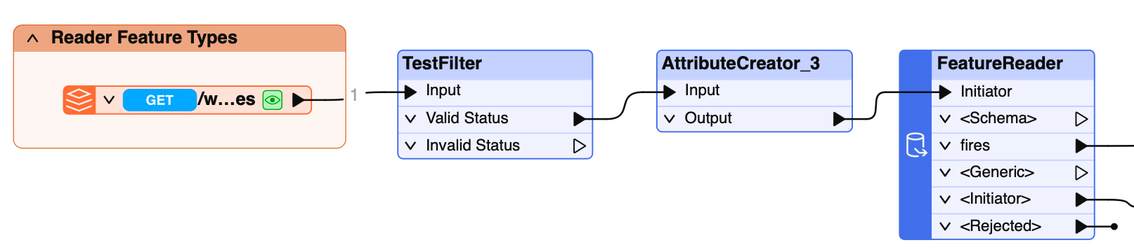

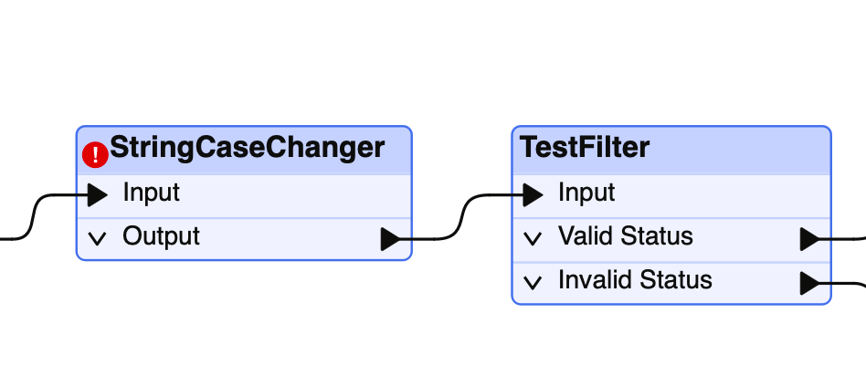

3. Add Conditional Logic for the Status Parameter
The status parameter filters wildfire records based on their current condition. To make sure users can only request valid statuses, you’ll use a TestFilter to define which inputs are accepted.

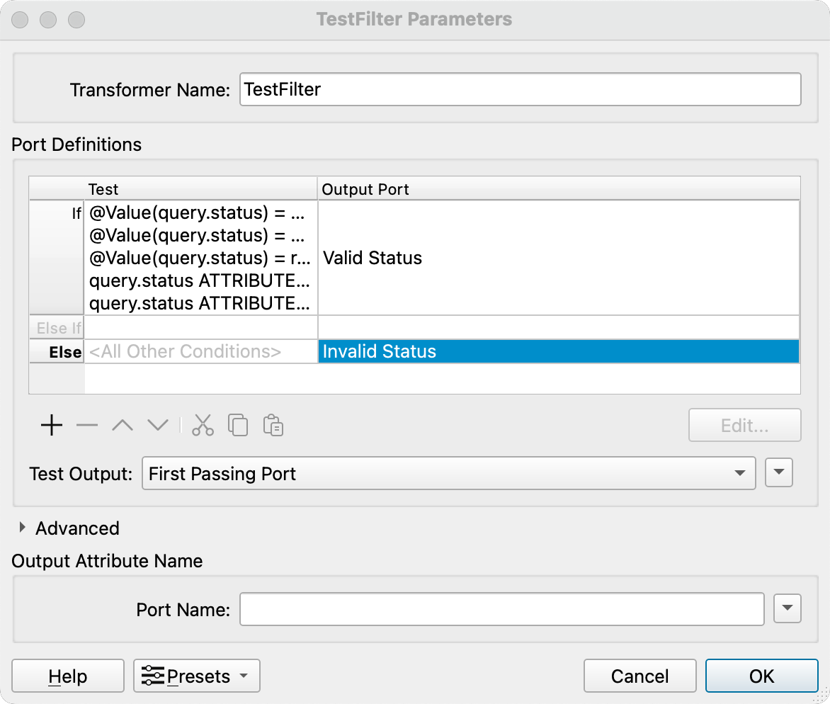

The TestFilter transformer checks each feature against one or more conditions and routes it based on the result.
Add a TestFilter to the workspace, make space if needed, and connect it after the GET /wildfires feature type.
Open the TestFilter to configure it.

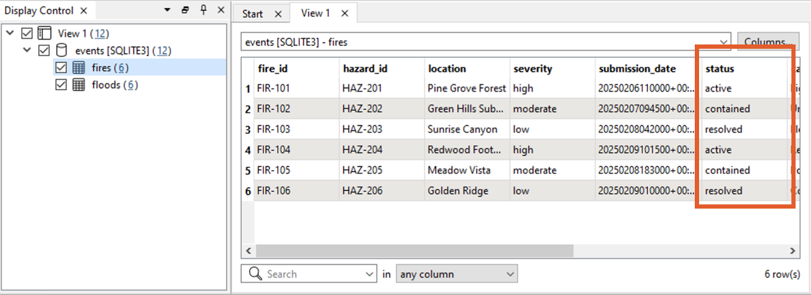

In the fires table, valid values for status are active, contained, and resolved. Because the parameter is optional, leaving it blank is also valid.
Double-click the If row to open the Test Conditions window, then create the following tests:
query.status = active
OR query.status = contained
OR query.status = resolved
OR query.status Attribute Is Missing
OR query.status Attribute Is Empty String
Add all tests, set the Output Port to Valid Status, and click OK.
Rename the final Else Output Port to Invalid Status to catch unexpected values.
Click OK to save.

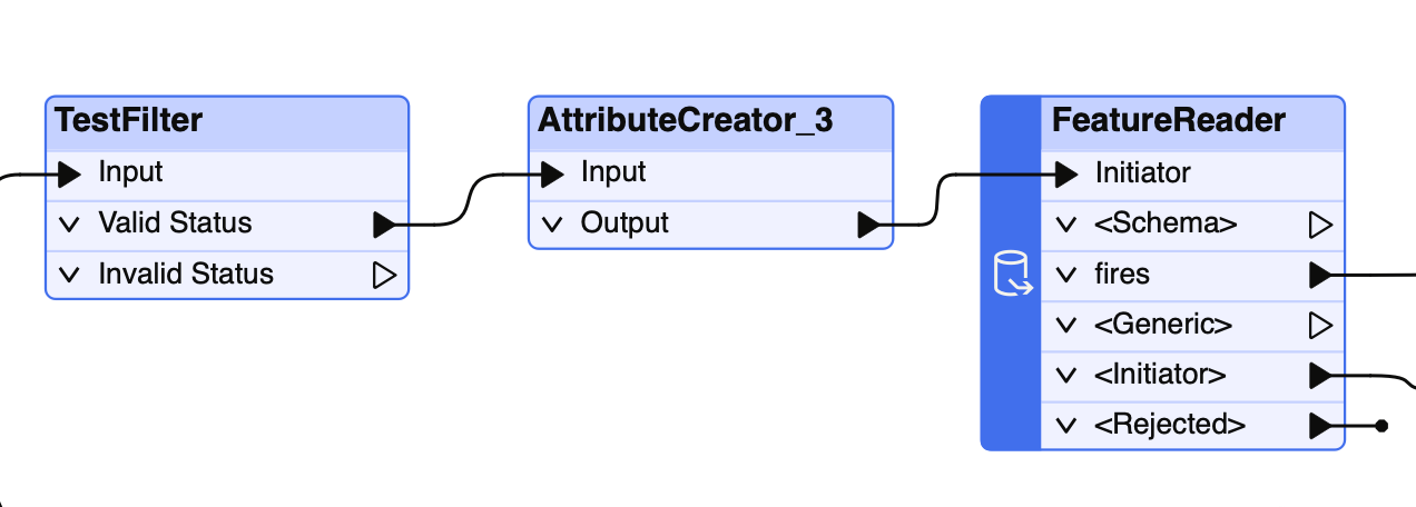

The TestFilter now has two output ports. Connect the Valid Status port to the AttributeCreator.

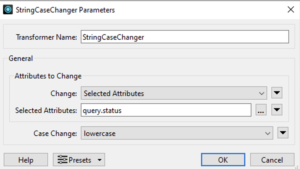

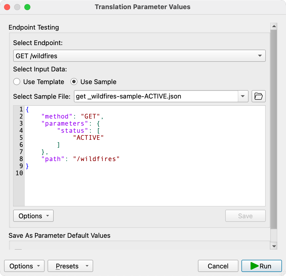

4.  Normalize Input with StringCaseChanger
Some users may enter values in different cases — for example, ACTIVE instead of active. Since the database query is case-sensitive, we’ll fix these differences automatically before validation.
The StringCaseChanger transformer modifies the capitalization of attribute values, helping standardize user input before further processing.
Add a StringCaseChanger to the canvas. Connect it between the GET /wildfires feature type and the TestFilter.
Open the StringCaseChanger and in Selected Attributes, expand query and select status.
 Click OK. Beside Case Change, select “lowercase”.
Now, any uppercase or mixed-case input will automatically be converted to lowercase before reaching the TestFilter.
To confirm, test the workspace with an invalidly cased value:
  "method": "GET",
  "parameters": {
    "status": [
      "ACTIVE"
This template represents this request: http://<FME Flow>/api/EnvironData/wildfires?status=ACTIVE
Run the request.
Because the database stores status values in lowercase, the workspace would normally reject this request. With the StringCaseChanger, the input is converted and now passes validation successfully.
If an input can’t be fixed automatically — such as a misspelled or unknown value — the workspace will treat it as invalid.
In the next steps, you’ll add logic to return a clear error message in those cases.

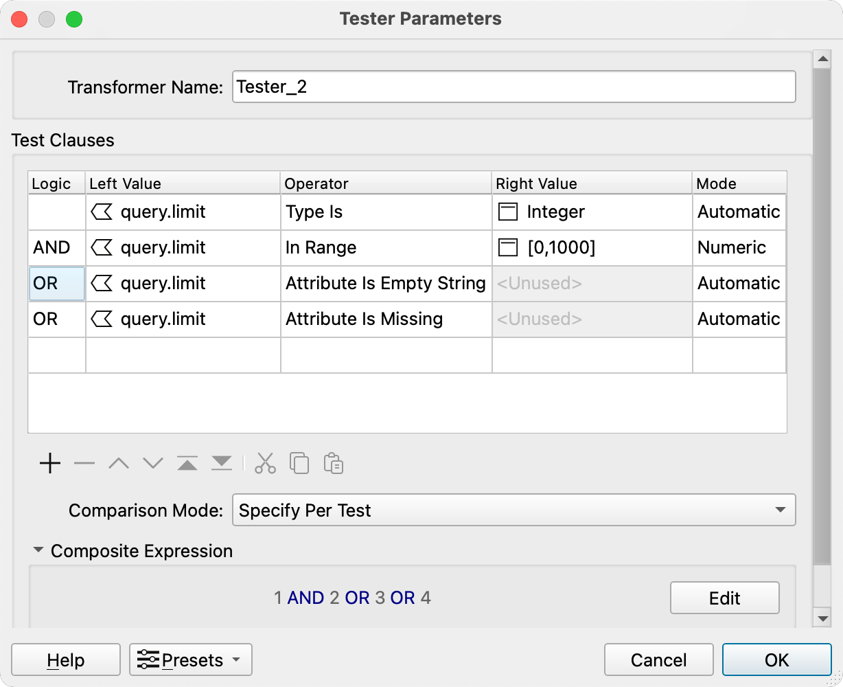

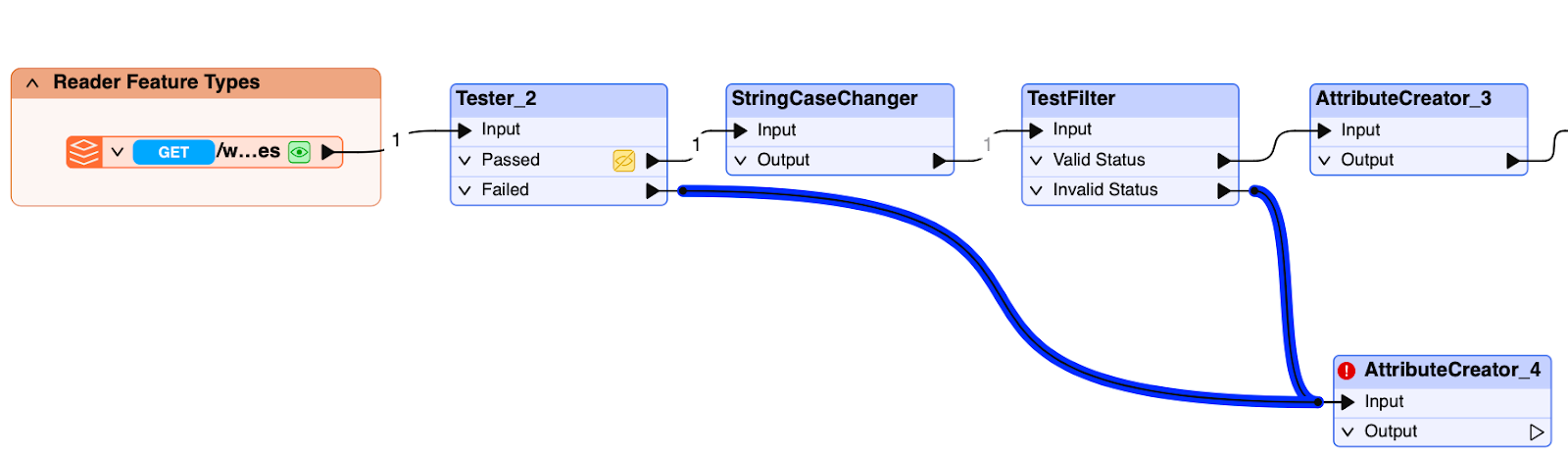

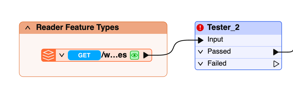

5. Validate the Limit Parameter
Next, we’ll verify the limit parameter to prevent requests that return too much data or invalid values.
The Tester transformer checks for specific conditions and is ideal for numeric or range-based validation.
Add a Tester to the canvas and make space if needed.
Create the following test clauses:
query.limit Type Is Integer
AND query.limit In Range [0,1000]
OR query.limit Attribute Is Empty String
These clauses ensure the user doesn’t send invalid data to the limit parameter, which could otherwise cause a database error.

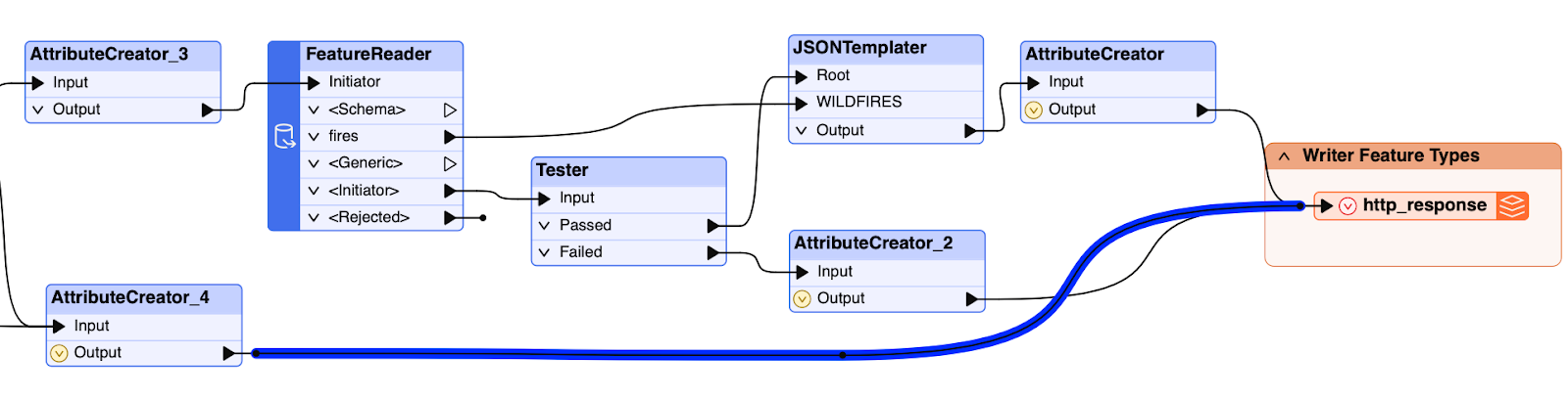

6. Return an Descriptive Error Message
When users send invalid values that can’t be corrected automatically, the API should return a clear, consistent response. This improves error handling and helps clients understand what went wrong.

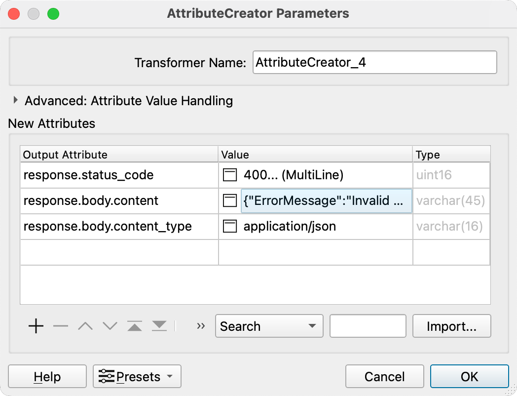

The AttributeCreator transformer lets you define response attributes directly in the workspace.
Add a new AttributeCreator to the canvas. Connect it to both the Tester (Failed) port and the TestFilter (Invalid Status) port.
Open the AttributeCreator and configure the following output attributes:
Output Attribute Value
response.status_code 400
response.body.content {"ErrorMessage":"Invalid parameter value"}
response.body.content_type application/json
Review the parameters.
For successful (200) responses, we used a JSONFormatter to build the response dynamically.
This time, we’re setting a static message directly in the AttributeCreator, which is best for short, simple responses.
Click OK, then connect the AttributeCreator output port to the http_response writer feature type.
7. Test Invalid Responses
Now that your validation and error handling are in place, test how the workspace reacts to different types of bad input.
Try rerunning the workspace with several invalid parameter cases:
  • A misspelled value (e.g., status="oepn")
  • An unexpected type (e.g., limit="ABC")
  • An invalid value (e.g., status="closed")
Example request:
  "method": "GET",
  "parameters": {
    "status": ["CLOSED"]
http://<FME Flow>/api/EnvironData/wildfires?limit=3&status=CLOSED
Run the workspace and open the dv_output.json file to confirm that a 400 status code and error message are returned.
Save the workspace.
8. Republish to FME Flow
After completing your updates, publish the workspace to FME Flow so the changes take effect.
This ensures the endpoint uses the latest version of your workspace logic, including validation, case correction, and error handling.
Once published, open FME Flow and go to the Workspaces tab.
Verify that the GET /wildfires endpoint now shows Workspace Status: Assigned. This means your workspace is correctly linked and ready to handle live API requests.
9. Test Requests in Documentation
Finally, use the Swagger documentation or another API client to test the endpoint with different parameters.
In Swagger, open the GET /wildfires endpoint and click Try it Out.
Enter the following sample values:
  • limit: 2
  • status: RESOLVED
For example, test the results for the request: http://<FME Flow>/api/EnvironData/wildfires?limit=2&status=RESOLVED
Click Execute to send the request and review the response.
You should see two results that match the resolved status, confirming that your filters and limits are working correctly.
Next, test an invalid data type:
  • limit=ABC
This time, FME Flow returns an error message before the request runs. This happens because the limit value was defined as an integer when the parameter was created, and the input doesn’t match that type.
Test a value outside of your defined range to confirm your custom error handling:
  • limit=1001
Finally, test a combination of valid and invalid values to complete the tests:
  • limit=2
  • status=closed
The invalid value should trigger a 400 Bad Request error along with your custom message.
