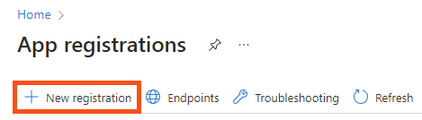

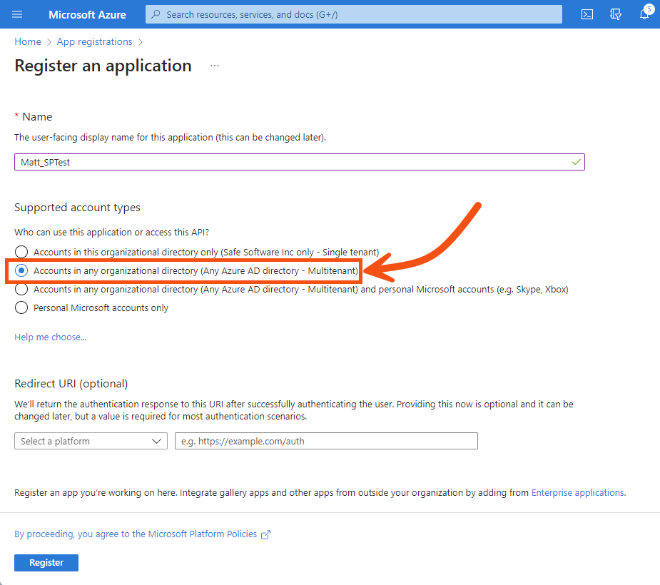

Add a new registration.
New App Registration
Choose the option "Accounts in any organizational directory (Any Azure AD directory - Multitenant)’’. Leave the Redirect URI options blank, and click Register.

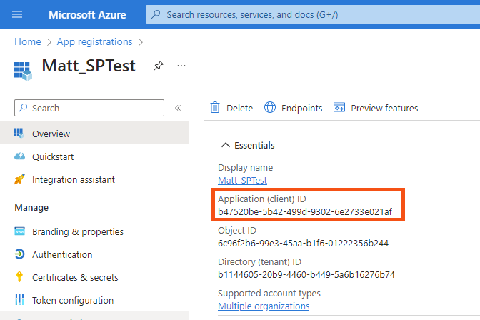

2. Obtain the Client ID value
On the new app registration's Overview page, take note of the displayed Application (client) ID value. This value will be used to configure the new FME web service in a later step.
You can confirm your app registration is multitenant by checking on the value of 'Supported account types'. Multitenant app registrations will display a value of 'Multiple organizations' for this setting.

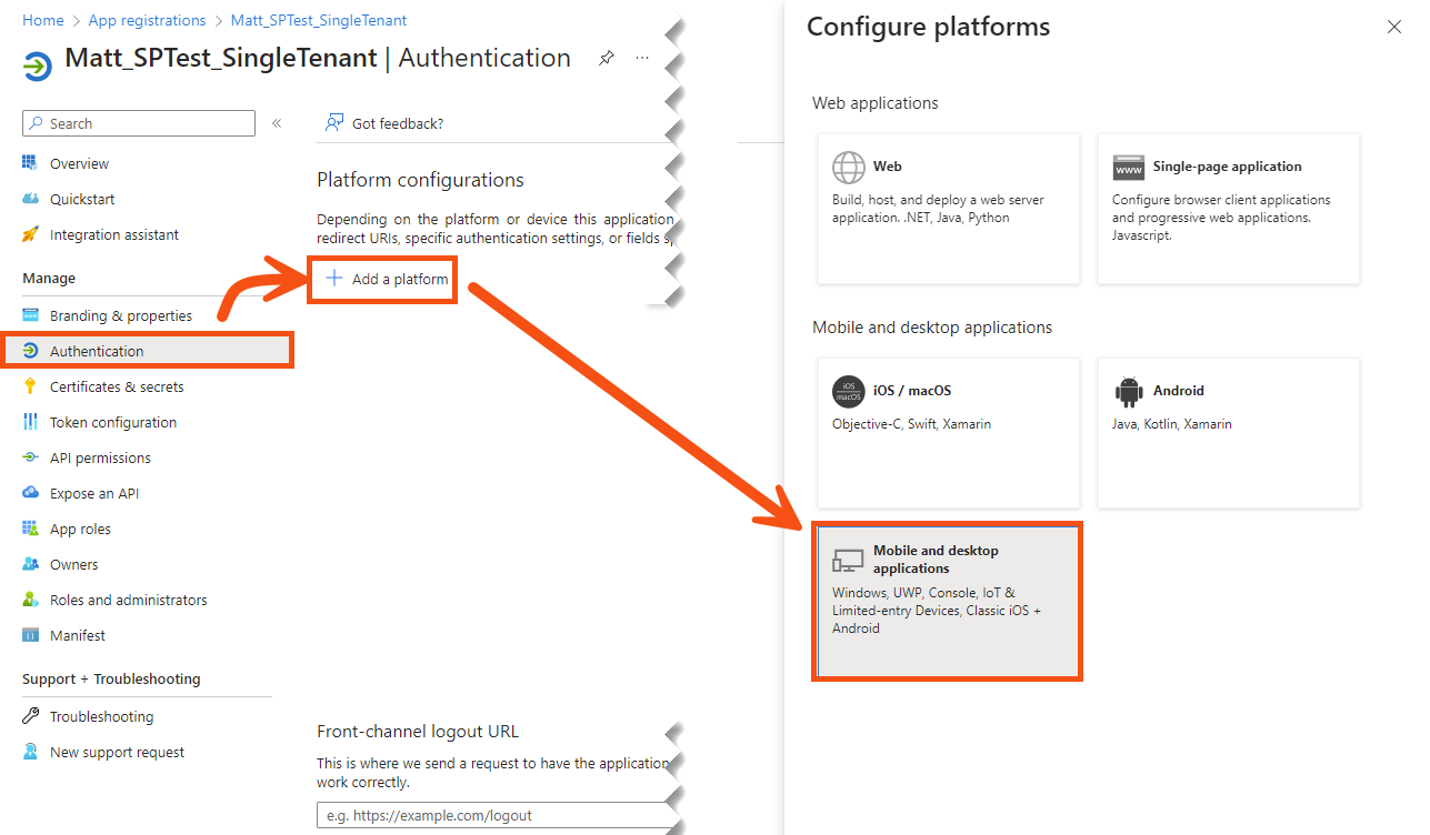

3. Add the 'Moblie and Desktop application' Platform

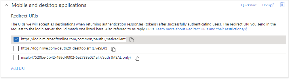

Click the Authentication option along the left-side menu, and then select 'Add a platform'. Choose the 'Mobile and Desktop applications' platform.

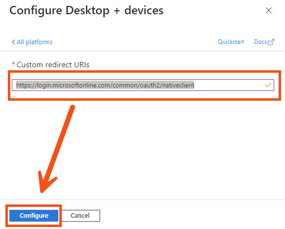

Ensure you see the following redirect URI included in the displayed list of URLs:
https://login.microsoftonline.com/common/oauth2/nativeclient
If you do not see the above URL included, please add it as a Custom redirect URI. Then, click Configure at the bottom left.
You should now see the Mobile and desktop applications platform enabled for your multitenant Azure app registration.

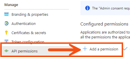

4. Add Delegated Graph API Permissions
Select the API Permissions option along the left-side menu, and then select 'Add a permission'.
Add API Permission

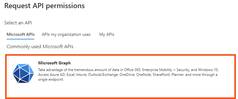

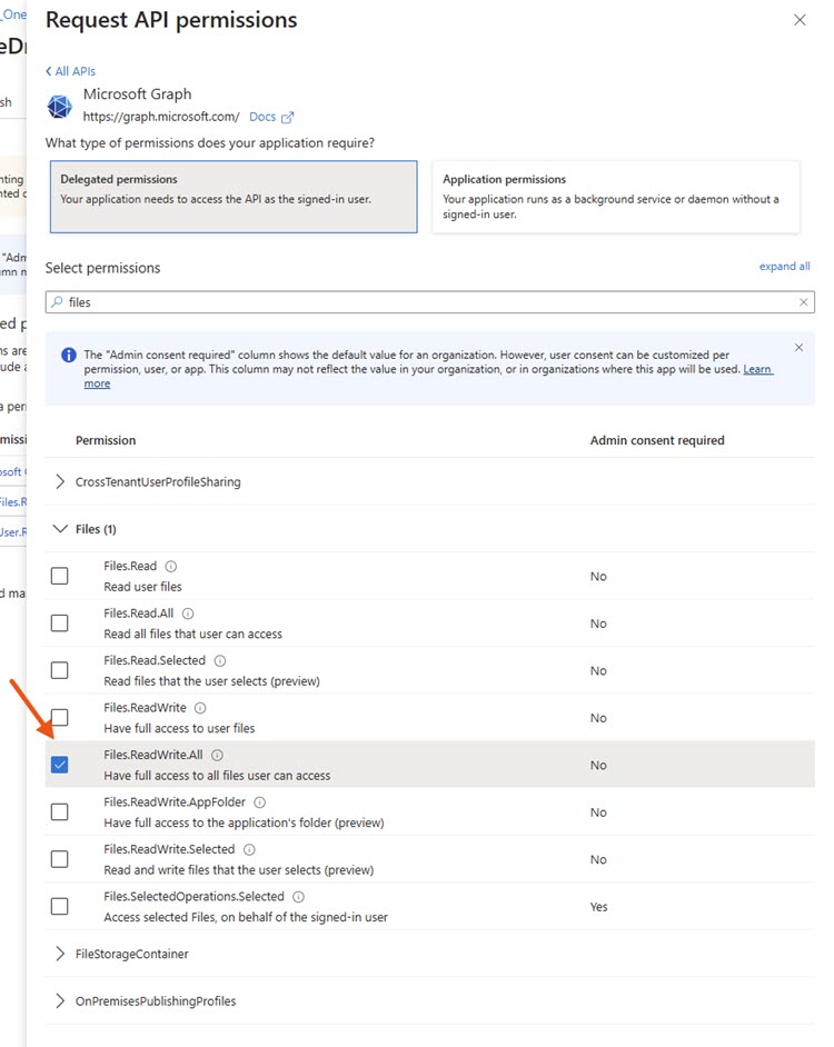

Choose Microsoft Graph from the Request API Permissions pane that opens at right.

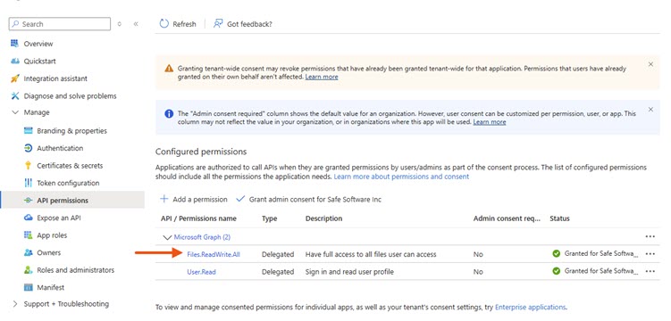

Click Delegated permissions, then search for and check off the Files.ReadWrite.All permission. Click Add Permissions.
Once added, you should see the delegated Microsoft Graph API Files.ReadWrite.All permission appear in the list of Configured permissions, as shown in the API Permissions view of your Azure app registration. Now your multitenant Azure app registration is complete.
If you have the ability to do so, select 'Grant admin consent for <Tenancy Name>', just above the table of API permissions as shown in the API Permissions view of your Azure app registration. Granting admin consent to your Azure app registration from Azure Portal will remove the need to do so in FME Workbench.

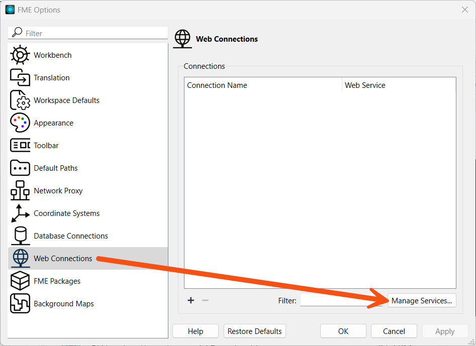

1. Access the Manage Web Services Menu in FME Workbench
In FME Workbench, navigate to Tools > Options > Web Connections > Manage Services

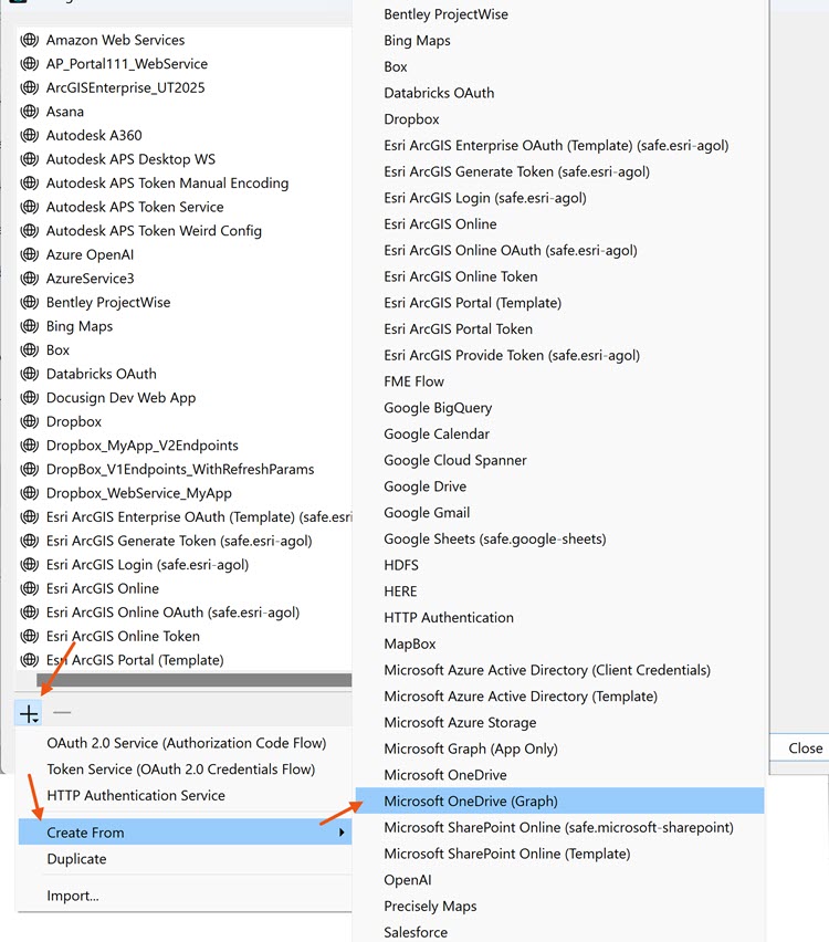

2. Create a New Web Service
From the Manage Web Services dialog that opens, select the plus (+) button below the list of web services at left, and then choose Create From > Microsoft OneDrive (Graph).
Do not choose the Microsoft OneDrive web service option, sitting just above the Microsoft OneDrive (Graph) web service option. This secondary web service template is a legacy option, and will not function correctly with the current version of the OneDriveConnector.

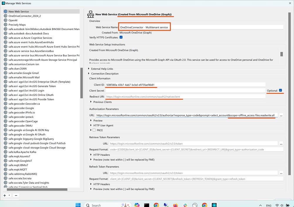

3. Configure the New Web Service
Make sure you have the Application (client) ID value, obtained from Part 1 - Step 2 above, on hand. In the web service definition that appears in the right-side pane of the Manage Web Services dialog, please make the following adjustments:
  • Web Service Name: give the web service a unique name. It is recommended that the web service's name reflect it's purpose and tenancy (eg. OneDriveConnector - Multitenant service)
  • Client ID: enter your app registration's Application (client) ID value.
  • Client Secret: leave this blank, and ensure Optional / Not Required is checked at right
  • Redirect URI: leave this value as https://login.microsoftonline.com/common/oauth2/nativeclient
  • Authentication URL: verify that the following parameter is present in the URL
    • ...&scope=offline access files.readwrite.all...
Click Apply at bottom right of the new web service definition to save it's configuration.

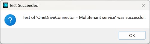

4. Test the New Web Service
Scroll down to the bottom of the new web service definition, and select Test (just above Apply). You will be prompted to enter your Microsoft user credentials in a pop-up browser window. If Microsoft prompts you to grant admin consent, select Accept.
If this web service test is successful, the following dialog will appear:
Once the web service is testing successfully, you can create a OneDriveConnector web connection. Close the Manage Web Services dialog to return to the Web Connections menu of FME Options.

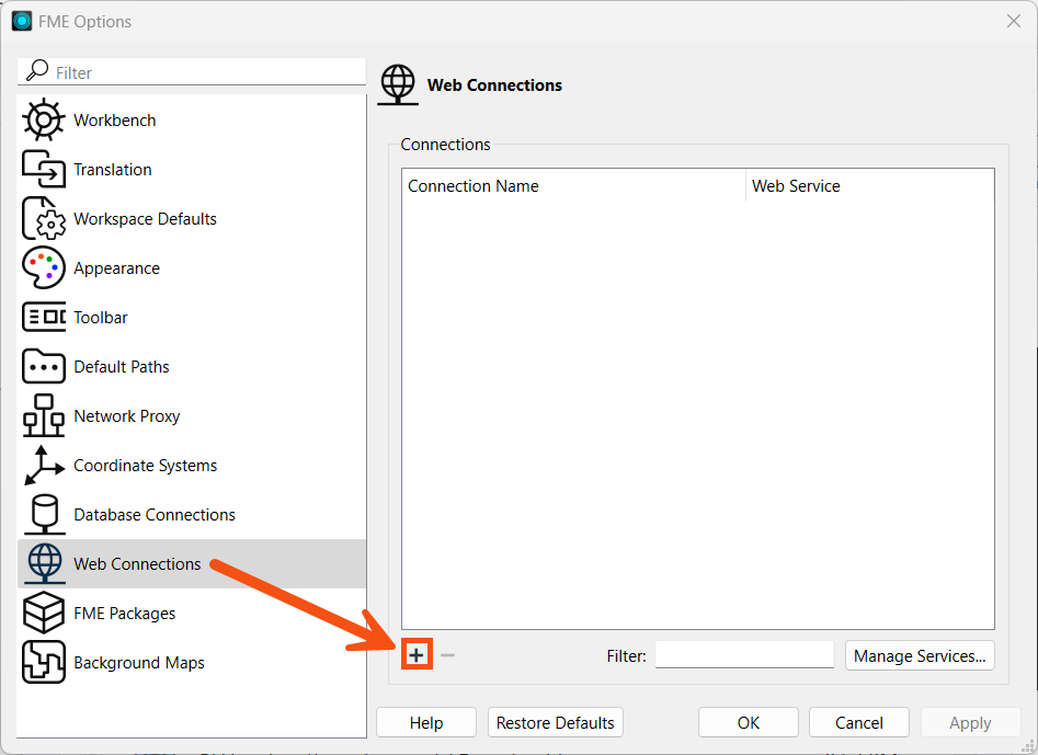

5. Create the Web Connection

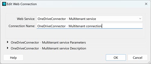

From the Web Connections menu, click the plus (+) button below the Connections table and choose to Add a new web connection.
Choose the web service that you just created and tested above, and give the web connection a unique name. Click OK in the Edit Web Connection dialog. You will be prompted again to authenticate with Microsoft.

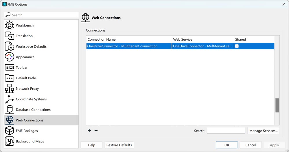

After successfully authenticating, the new web connection will appear in the Connections table of the Web Connections menu. The new web connection is now ready for use in your FME Form integrations with Microsoft OneDrive.
