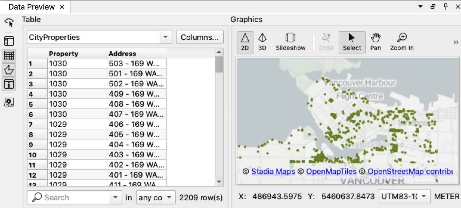

When working with any data source in FME, it is typically a good idea to view the data so that you know what you are working with. Data can be viewed outside of a workspace using the FME Data Inspector application that comes with FME Form. For more information on viewing data with the FME Data Inspector, see Getting Started with FME Form: Introduction to FME Data Inspector

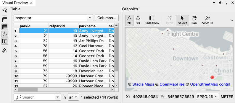

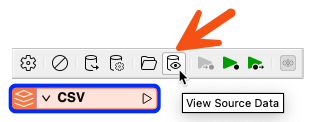

Data can also be viewed directly in FME Workbench after adding a reader feature type to the canvas or with certain transformers, such as the FeatureReader or DatabaseJoiner, that add data in the middle of a translation.
To view data, single-click on the feature reader type or FeatureReader transformer to open the mini menu, then click on the View Source Data button. The data can then be viewed in Data Preview within FME Workbench.
Some formats require the workspace to run first before the data can be accessed. If the View Source Data button is disabled or does not return data, run the workspace first and follow the steps in the Data Caching section.

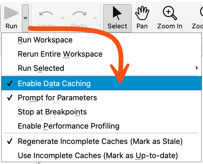

Enable Data Caching

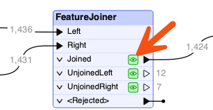

To enable feature caching, click the drop-down arrow next to the Run button in FME Workbench and select Enable Feature Caching. Once feature caching is enabled, when the workspace is run, caches will appear on each output port of each object on the canvas if there is data.
Viewing Data Caches

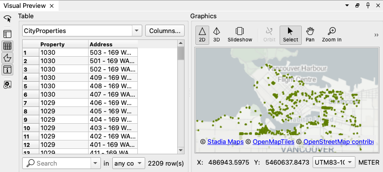

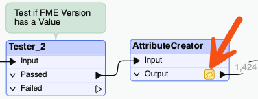

If data caching is enabled, after running the workspace, green icons will appear on each output port that has data. To view the data cache, click on the green icon, and the data will open in Data Preview.
If the data cache is yellow, that means the cache is stale and has not been updated via running the workspace. A stale cache can occur from a parameter changing upstream of the cache or by a change in which canvas object is connected.

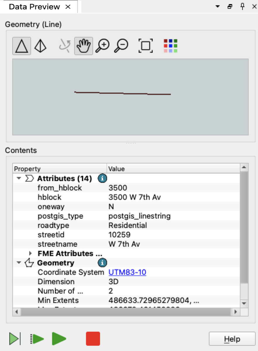

Breakpoints are inspection points where a single feature can be viewed at a time, whereas data caching is used to view all output features at a certain output port. Breakpoints are manually inserted wherever feature inspection needs to occur. Breakpoints are most commonly used for troubleshooting but can also be used to inspect a single feature to decide what action needs to be taken next.

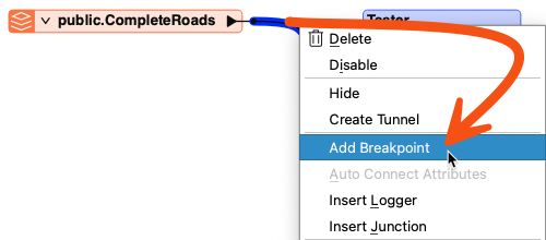

Enabling Breakpoints
Breakpoints are inserted on the connection lines between objects on the canvas. To insert a breakpoint, right-click on a connection line and select Add Breakpoint.
A red octagon will appear on the connection line to indicate the presence of a breakpoint. A workspace can have as many breakpoints as needed for inspection purposes.
Running with Breakpoints
Once at least one breakpoint has been added to the canvas, click the drop-down arrow next to the Run button and select Stop at Breakpoints. Once Stop at Breakpoints has been enabled, click the Run button to start running the workspace.
With Stop at Breakpoints enabled a new Data Preview window will appear, this is where each feature can be viewed as it stops at the breakpoint. If the feature has geometry, it can be viewed in the top half of the window, and any attributes can be viewed in the bottom half. The breakpoint controls are at the bottom of the window. The first button will continue the feature to the next object whether or not there is a breakpoint. The second button will continue running the translation to the next breakpoint, and the third will continue the translation ignoring all the breakpoints. For more information on the Data Preview window, please see the Data Preview documentation

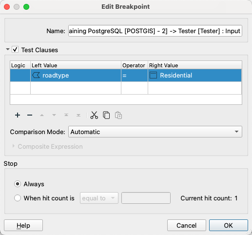

Breakpoints can also be set up to use test clauses to only have the feature stop should the test be satisfied or only stop after a certain number of features. To enable tests or stop counts, right-click on the breakpoint and select Edit Breakpoint. In the Edit Breakpoint dialog, either enable Test Clauses or modify the Stop Count.

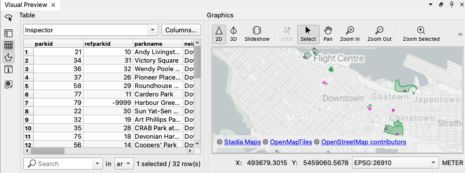

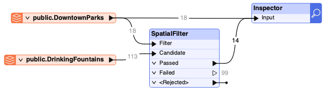

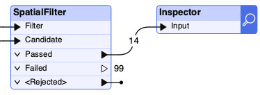

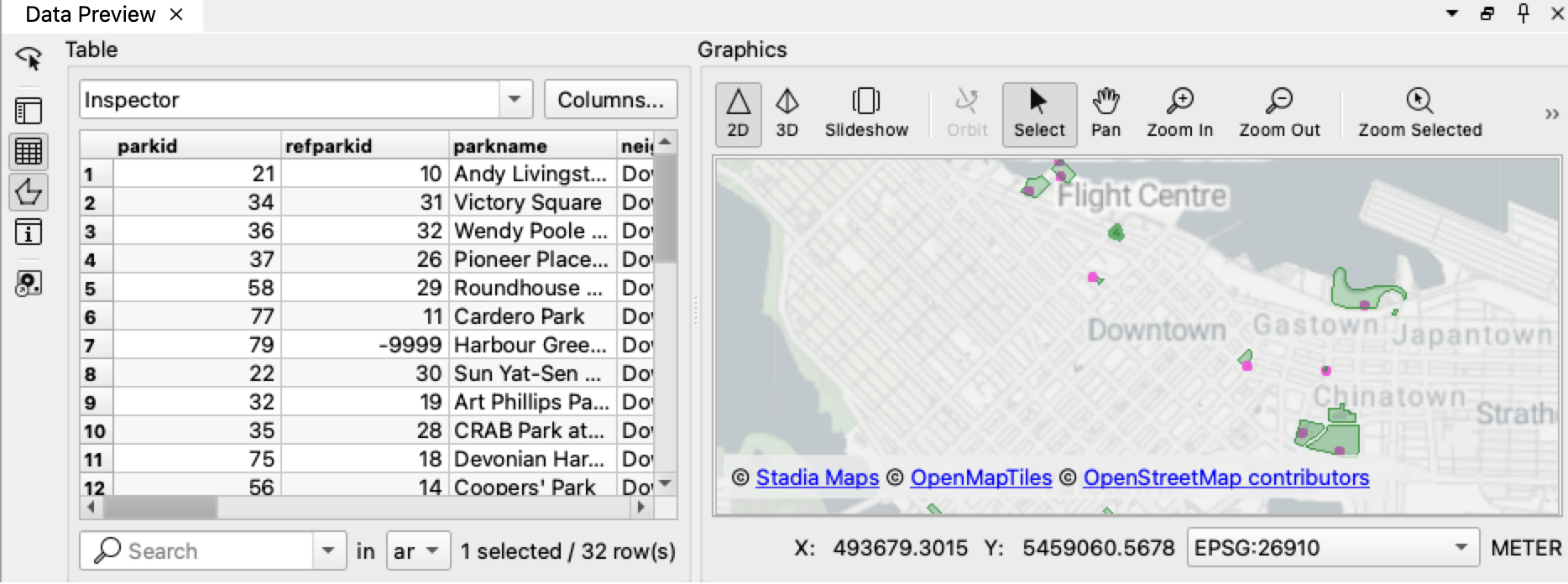

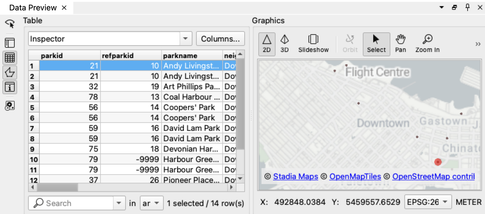

The Inspector transformer can be connected to any output port and will open data in Data Preview when a workspace is run. This is similar to running a workspace with data caching enabled; however, it is much less memory intensive, as only the data that reaches the Inspector will be viewed.
The Inspector transformer can also be connected to multiple output ports at once to layer data in Data Preview. For example, it can be used to view the park boundaries where the drinking fountains intersect.

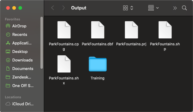

If a writer feature type is connected to the workspace or a FeatureWriter, after a workspace is run, the output data can be viewed directly in FME via Data Preview. To view the output data in FME, single-click on the writer feature type or FeatureWriter to open the mini menu, then click on View Written Data.
Written data can also be accessed via the computer’s file explorer. To quickly find written data, single-click on the writer feature type and click Revel in Finder (macOS) or Open File Explorer (Windows OS).

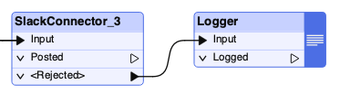

Features can also be logged throughout the workspace by using the Logger transformer and attaching it to any output port. The Logger can enhance error messages or log certain features to aid in troubleshooting. When working with APIs, the Logger can document the calls made to the API.
