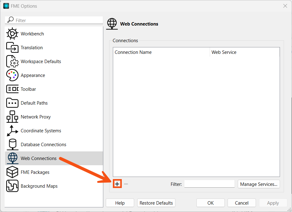

5. Create the Web Connection
From Web Connections, click the plus (+) button to add a new connection.
Choose the web service you created and give the connection a unique name. Click OK.
