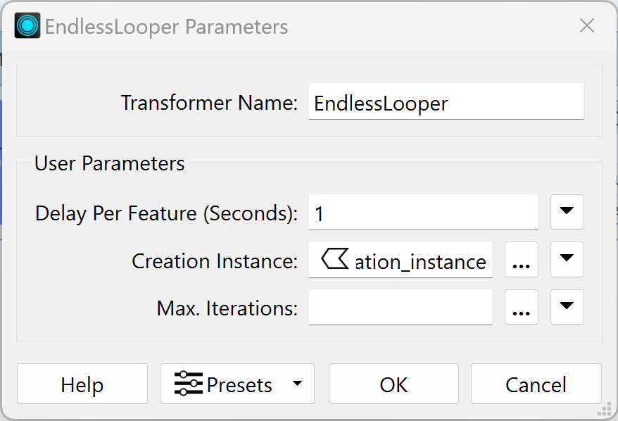

The EndlessLooper transformer contains a parameter called Delay Per Feature (Seconds), which dictates how often a feature exits the EndlessLooper.
This parameter can be used to control how often the API is being polled.

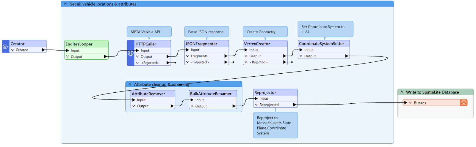

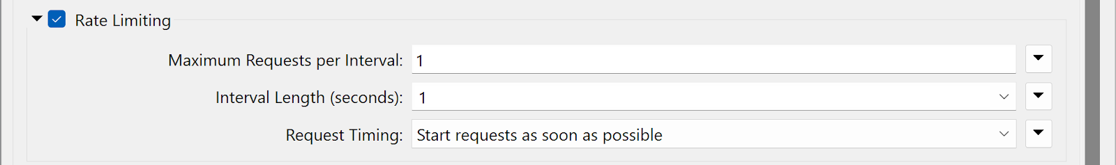

In a scenario where we want to continuously poll the vehicles endpoint for vehicle location information and status, we can create a workspace that uses the EndlessLooper and HTTPCaller transformers. The Delay Per Feature on the EndlessLooper is set to 1 second, and the rate limiting is set on the HTTPCaller to ensure that the rate limit for the API is not reached.
Additional transformers such as the JSONFragmenter, VertexCreator, and CoordinateSystemSetter are used to extract attribute values and create geometry to be visualized.
Features are then written to the desired destination, in this example, a SpatiaLite database table. On the SpatiaLite writer, the Features Per Transaction parameter is set to 50 to ensure that features are continuously updated in the table. The complete workspace, in FME Form, can be seen below. The workspace can also be downloaded from this article.
Now that the workspace is complete, it can be saved and published to FME Flow, where it can be set up in an FME Flow Stream that will run the workspace indefinitely, continuously updating the SpatiaLite database table with the latest vehicle tracking information to display on a web map or be used for further analysis. For instructions on how to work with streams in FME Flow, see How to use the FME Flow Streams Interface.
