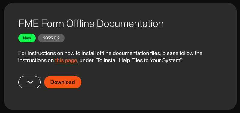

Option 1: Download Offline Documentation
Offline documentation can be downloaded from the Safe Software Downloads page starting with FME 2025.0.
After downloading the documentation zip file, extract the contents into the help folder within the FME folder. The folder will need to be created manually. Once extracted, enable Offline Help in the Default Paths section of FME Options.
Windows:
C:\Program Files\<FME Version>\help
macOS:
/Library/FME/<FME Version>/help
For complete instructions, see the documentation
