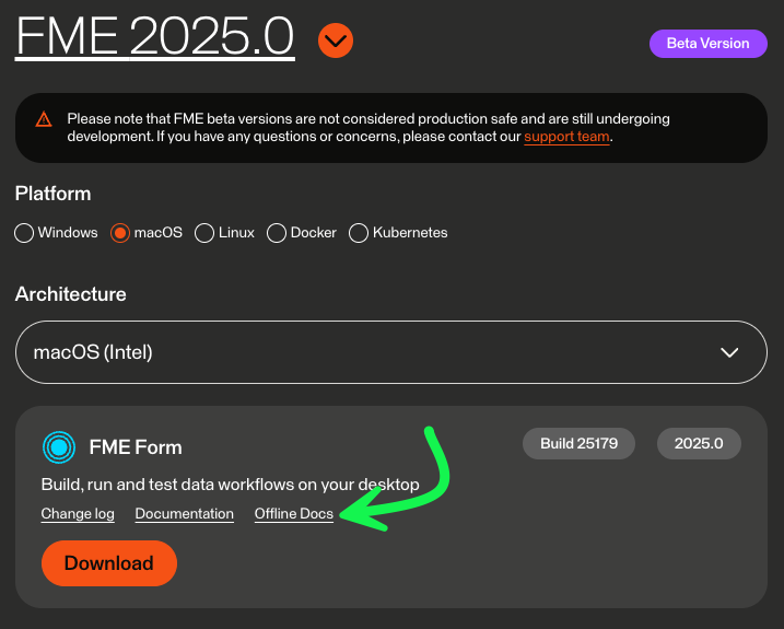

Option 1: Download Offline Documentation
1. Download Documentation Files
Offline documentation can be downloaded from the Safe Software Downloads page starting with FME 2025.0.

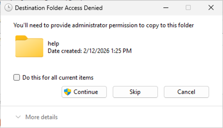

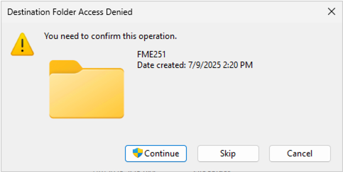

Create a new folder called help, which is where we will unzip the downloaded documentation files. When prompted, click Continue to create the folder as an admin. If you do not have admin permissions, please reach out to your IT department to have them install the folder.

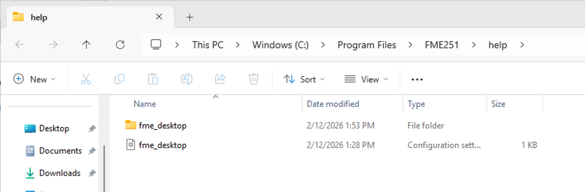

3. Unzip Help Files
Now navigate to where the downloaded help zip file is, and extract it to the newly created help folder. Again, you may be prompted to continue as an admin.
This file is large and may take some time to extract.

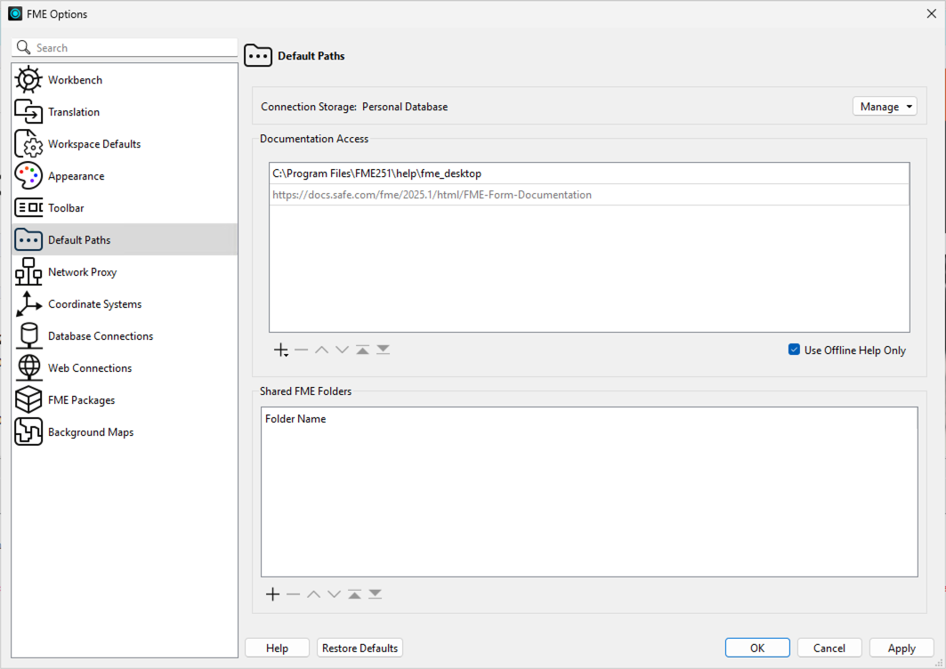

4. Open FME
After the files have been unzipped. Open FME Workbench, then go to Utilities > FME Options > Default Paths. The offline path should be available. Enable Use Offline Help Only.

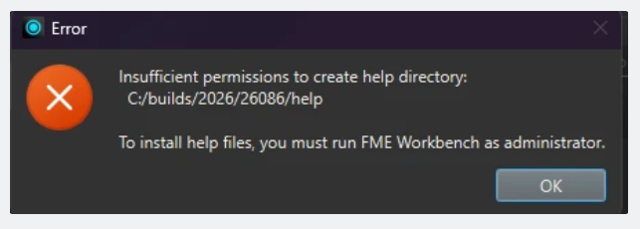

Troubleshooting

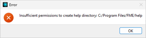

If you try to import the zip file directly into FME, an error message will appear stating:
Insufficient permissions to create help directory:
<file location>
To install help files, you must run FME Workbench as administrator.
Follow the instructions in Option 1: Download Offline Documentation
