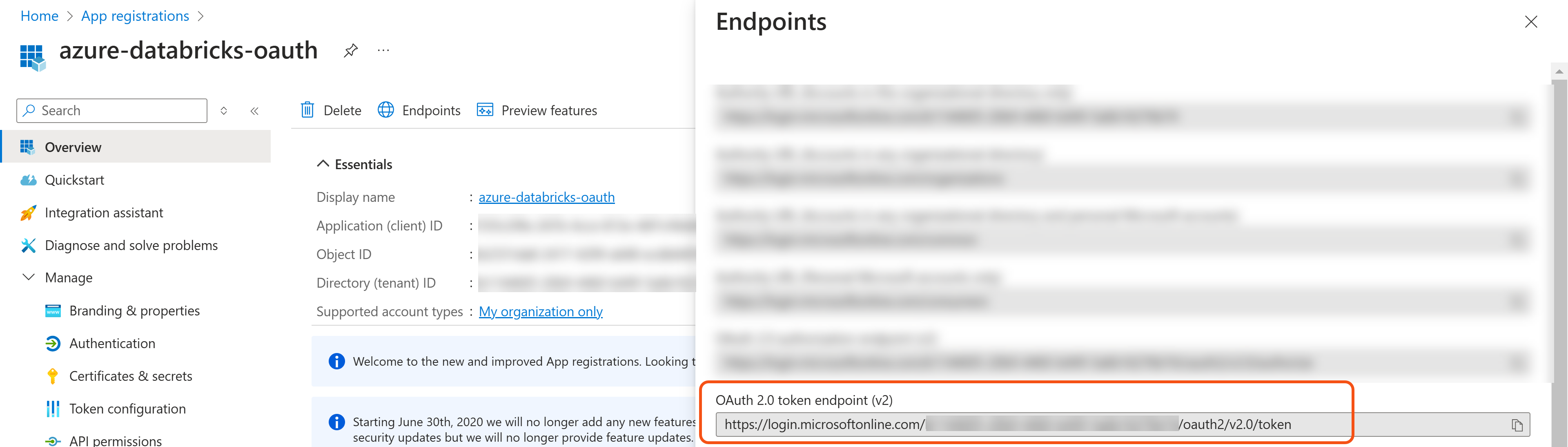

  1. Go back to the Overview tab. Click on Endpoints to pull up the list of endpoints for your organization. Keep a copy of the OAuth 2.0 token endpoint (v2). This will be used for the Token Endpoint URL in the connection in FME.
  2. Your Azure App registration is now complete. You should have values for the following parameters after completing the previous steps.

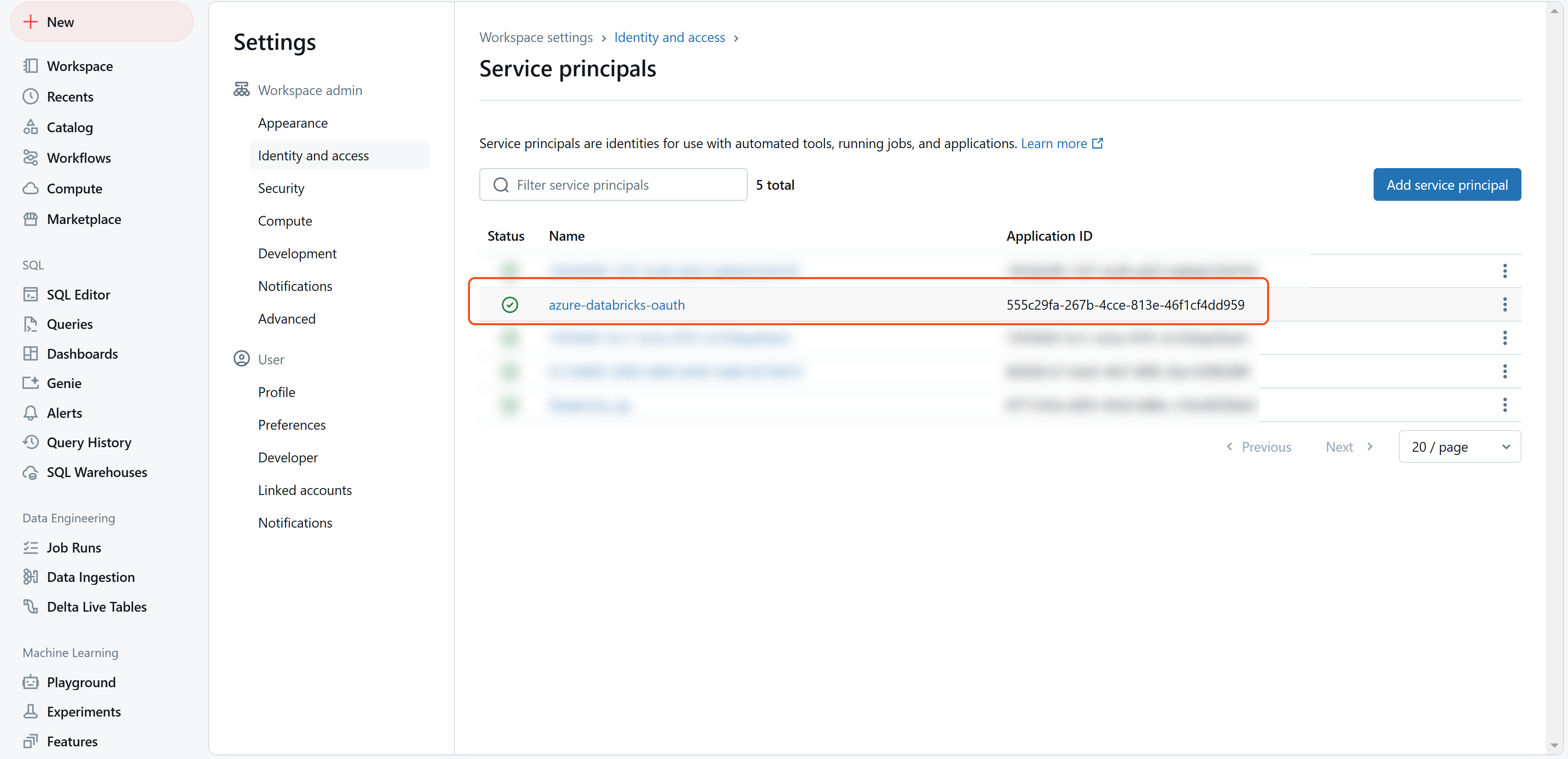

  1. Go to Identity and access
  2. Under Service principals, click Manage
  1. Click Add service principal
    • Select Add new
  1. Set Management to Microsoft Entra ID managed
  2. Enter the Application/Client ID from your Azure App registration
  3. Set any value for the Service principal name
  1. Click Add. You’ve now successfully linked your App registration to your Databricks workspace. For more information on Service Principals in Databricks (Azure), take a look at the Microsoft documentation

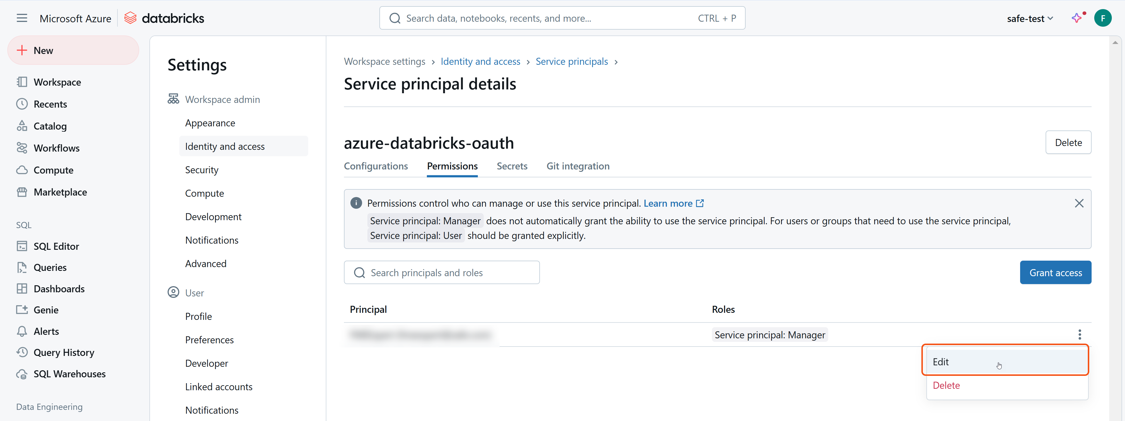

  1. In the Service Principals page, select the Service Principal you just created
  2. Go to the Permissions Tab

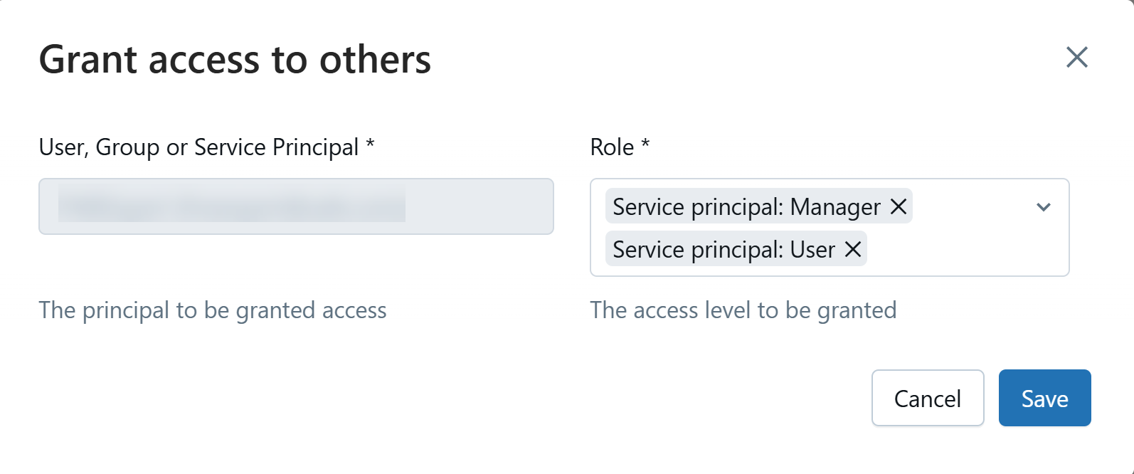

  3. Click on the three dots next to the default principal and select Edit
  4. Under Role, click the drop-down menu and add Service principal: User
  5. Click Save to save these permissions.

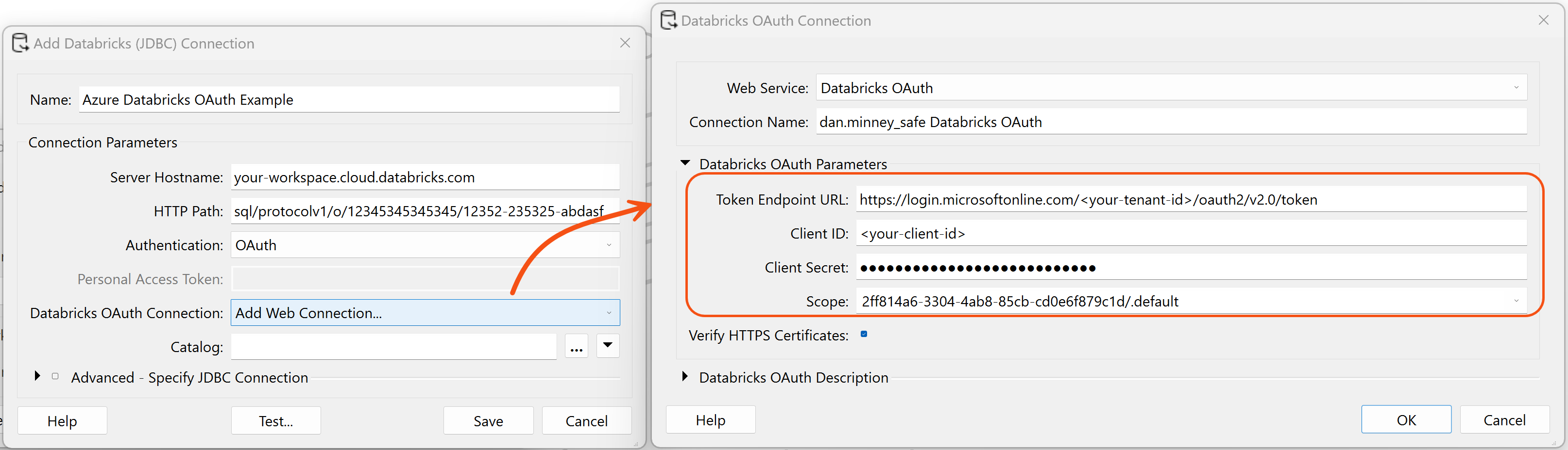

  2. In the window that opens, set the Server Hostname & HTTP Path based on the Cluster you want to connect with.
    On the Cluster Details page in your Databricks workspace, scroll down to the bottom and expand the Advanced Options. Click on the JDBC/ODBC tab and you will be presented with the parameters required to create a Databricks database connection. See the screenshot below for the corresponding parameters & where to find their values.
  3. Change the Authentication type to OAuth
  4. Click the drop-down next to Databricks OAuth Connection and select Add Web Connection…
  5. In the window that opens, enter the following values. If you are missing values for any of these parameters, please refer back to the Create an App registration in the Azure section of this article.
    • Token Endpoint URL: <your endpoint copied from the Azure App registration>
    • Client ID: <your Client ID from the Azure App registration>
    • Client Secret: <your Client Secret from the Azure App registration>
    • Scope: 2ff814a6-3304-4ab8-85cb-cd0e6f879c1d/.default
Note: This scope value represents the programmatic ID of Databricks on Azure.
  1. Press OK to accept the parameters and close the Databricks OAuth Connection window.
