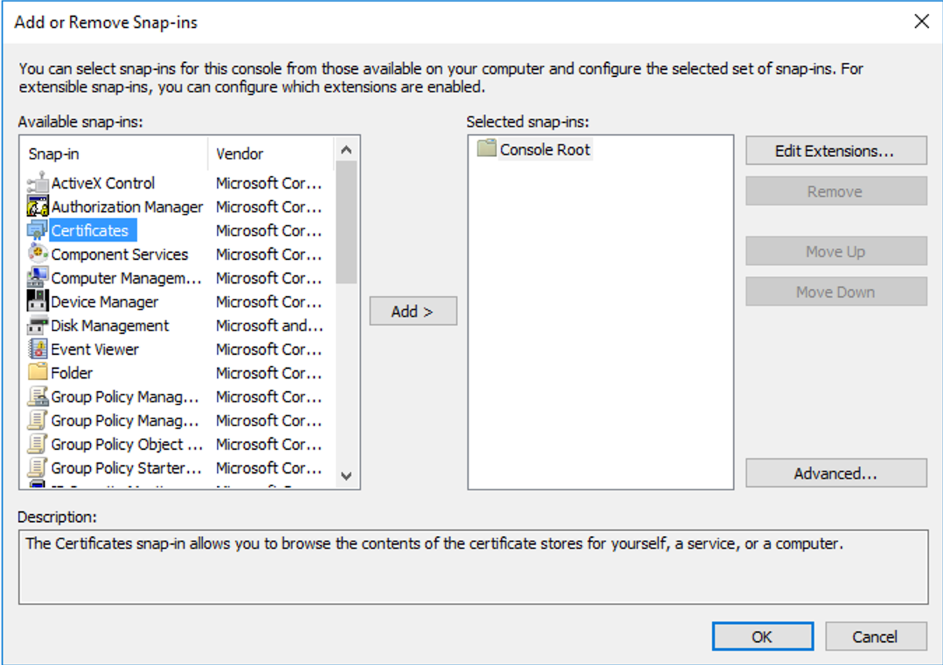

  2. In MMC, go to "File" > "Add/Remove Snap-in".
  3. In the “Add or Remove Snap-ins” dialog box, select “Certificates” and then click Add.
  1. In the “Certificates snap-in” dialog box, select “Computer account” and then click Next.
  2. In the “Select Computer” dialog box, select “Local computer” and then click Finish.
  3. In the “Add or Remove Snap-ins” dialog box, click OK.

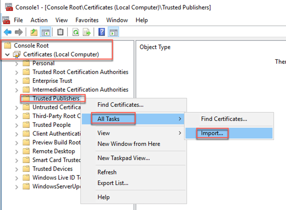

  4. In the console tree, navigate to “Certificates (Local Computer)” > “Trusted Publishers”.
  5. Right-click the Certificates folder, right-click to All Tasks, and then click Import. If the Certificates folder is missing, right-click "Trusted Publishers" instead and click "Import".

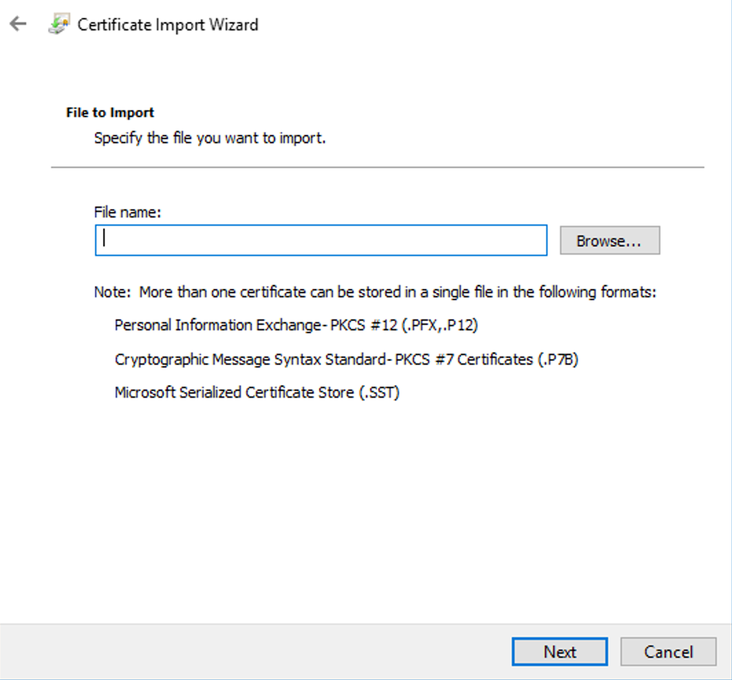

  1. Follow the instructions in the “Certificate Import Wizard” to find and import the certificate. When asked for the file to import, browse to the SafeSoftwareCertificate.cer file created earlier.
