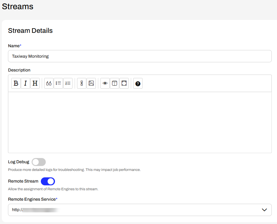

As of FME Flow 2025.0, you can assign a remote engine to an FME Flow Stream. This allows you to run your Stream as close to the streaming data source as possible.
When creating or editing a Stream, enable Remote Stream and choose the Remote Engines Service from which to assign engines.
