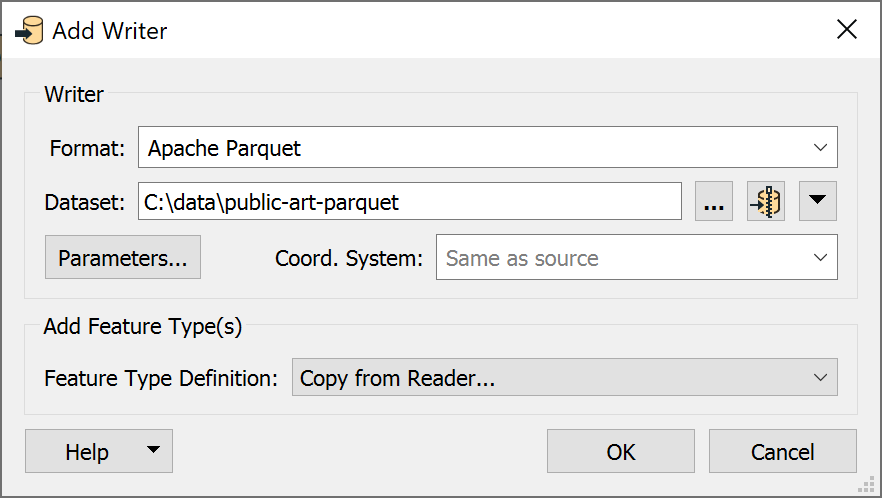

3. Add an Apache Parquet Writer
Click “Add Writer” and enter the following parameters:
  • Format: Apache Parquet
  • Dataset: C:\<Tutorial Download>\public-art-parquet
  • Feature Type Definition: Copy from Reader...
Open the Parameters dialog to optionally set the Compression Type and File Version. In this scenario, we will leave the default values:
  • Compression Type: UNCOMPRESSED
  • File Version: 2.0
Click OK.

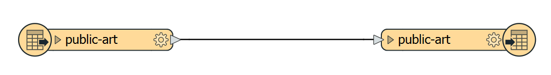

4. Connect the Reader and Writer
Connect the reader feature type to the writer feature type. The workspace is now configured to translate the input CSV file to Parquet.
5. Run the Workspace
Run the workspace to convert the CSV data to Parquet. The file public-art.parquet is generated in the output folder, which can then be uploaded to a Big Data system.
