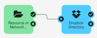

3. Add an External Action
Downstream, configure a Dropbox Directory (upload to) External Action. If you are in guided mode, simply click on the silhouetted Next Action node and scroll down to External Actions. Otherwise, drag an External Action node out onto the canvas and connect it to the Resource or Network Directory  Trigger. Before we can proceed, you'll need to configure your Dropbox account with an app to generate an OAuth 2 access token.

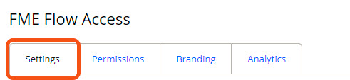

Your OAuth 2 access token is separate from your access key and secret key. Select Settings after selecting the app, scroll down to OAuth 2, and click Generate under Generated Access Token. Copy the token.
5. Configure Dropbox Directory External Action
Navigate back to the automation in FME Flow. In the Dropbox Directory External Action parameters, paste the token into the Access Token parameter.
Note: When permissions are changed, a new access token needs to be generated from the Dropbox application and then added to FME Flow, the change will not be passed on to FME Flow.
Populate Source Path with any files created or modified in the watched directory by clicking the drop-down arrow and then selecting Directory > File Path. Choosing a directory will copy the contents of that directory and all subdirectories to your Dropbox.
Fill in Destination Path with a folder in your Dropbox where you wish to deposit the files. For example, if you want files copied to the root of your Dropbox, simply type “/”. If the folder you specify does not exist, it will be created the first time data is uploaded. Uploads will overwrite existing files with the same name in the Dropbox.
When you are satisfied with your configuration, click Validate and Apply.

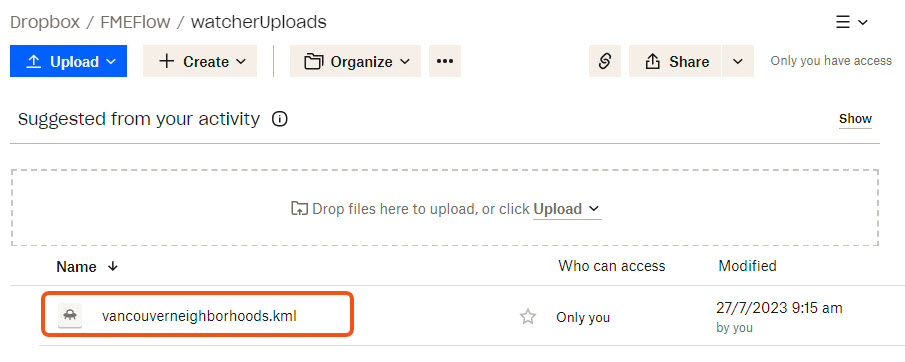

FME Flow logged the file upload, but we can always verify its success by logging into the target Dropbox and checking the folder path (/FMEFlow/watcherUploads/) we specified for the file uploaded to FME Flow earlier.

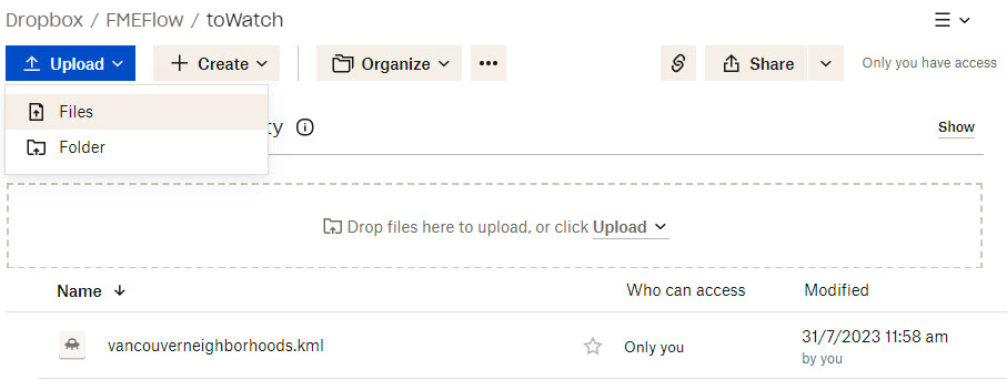

1. Create a Dropbox Folder to Monitor
In the Dropbox web interface, create a new folder to monitor for this exercise. Below, /FMEFlow/toWatch/ has been created.

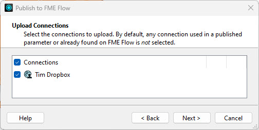

When the workspace is configured, publish it to FME Flow under the Automations Exercises repository (create this if it doesn’t exist). Upload your Dropbox connection information with the workspace, and register it with the Job Submitter service.

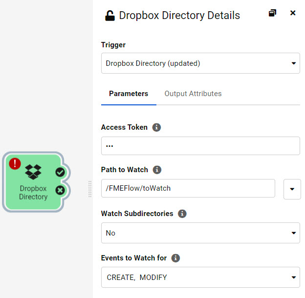

On the Automations canvas, double-click the Trigger node. Under Trigger, select Dropbox Directory (updated). Paste in an OAuth 2 token generated from your Dropbox app according to these instructions, which is the same OAuth 2 token generated in Part 1. Under Path to Watch, fill in the file path you created in Part 1, Step 2. Choose not to Watch Subdirectories (default), and remove DELETE from Events to Watch for.
Click Validate and (if valid) Apply. If the Trigger fails to validate, check the Dropbox file path you are watching and try re-pasting your Access Token, being careful not to highlight any leading or trailing whitespace.

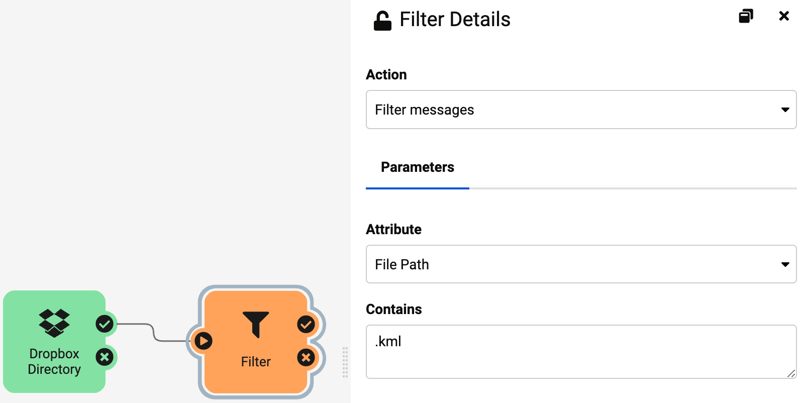

5. Configure a Filter
Add an Action after the Dropbox Trigger, and select Filter messages from the list. Under Attribute, click the drop-down arrow, and select File Path. This reads the file path whenever the trigger detects a file |create or updated in Dropbox. Under Contains, enter .kml (do not use wildcards). We are monitoring this Dropbox for features digitized from Google Earth, and we will need to process them further to make them compatible with the rest of our project.

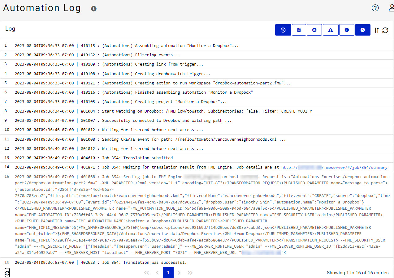

8. Test the Automation
In another browser tab, open the Dropbox web interface, navigate to the folder you are monitoring, and upload vancouverneighborhoods.kml from the Files section of this article (or another KML of your choice).

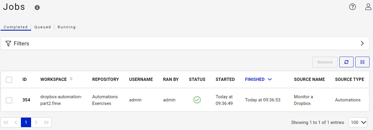

Wait a moment for the automation to trigger, then navigate back to your running automation. Select Menu > View Log File. You’ll see some lines related to the automation initializing and details about the Run Workspace job.
To jump right into the job log and omit the automation’s coordinating activities, instead choose Menu > View Triggered Jobs from the Automation canvas.
