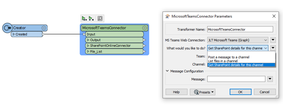

Post a message to a channel
To post a message to a Microsoft Teams channel, all input parameters must be set.
The Team and channel names must match exactly, as they are in Microsoft Teams.
Inside the transformer, API calls are made using Team and Channel IDs, not the team or channel names. A TestFilter has been used to match the user input with the names returned from Microsoft; if the two strings don’t match, the transformer will fail.
When run, this transformer posts the message to the specified channel.

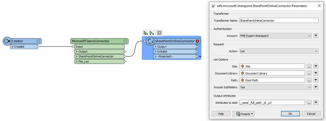

Get SharePoint details for this channel
If a user wishes to download, upload, or delete a file from Microsoft Teams, they must use the SharePointOnlineConnector transformer. This is because Microsoft Teams files are accessed through SharePoint.
To retrieve the SharePoint details, all input parameters must be set, except for the Message parameter.
The output attributes are:
Team Name: As specified in the transformer parameters
Channel Name: As specified in the transformer parameters
Root|Full Path: The path to either the root location (useful to list all files that have been uploaded to a channel) or the path to the location of a top-level item.
Site: The SharePoint site where the file exists
Document Library: The document library where the file exists
