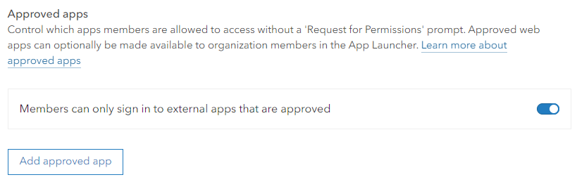

ArcGIS Online includes a security setting called "Members can only sign in to external apps that are approved." This can be found under Settings > Security > Apps.
When this setting is enabled, FME's built-in ArcGIS Online web service (Client ID OSNnG92IVpxtDLHf) may be blocked because it is an external application not on your organization's approved list.

Option 2: Adjust the security setting
Either disable the "Members can only sign in to external apps that are approved" setting, or add the FME application (Client ID OSNnG92IVpxtDLHf) to your organization's approved application list in ArcGIS Online.
