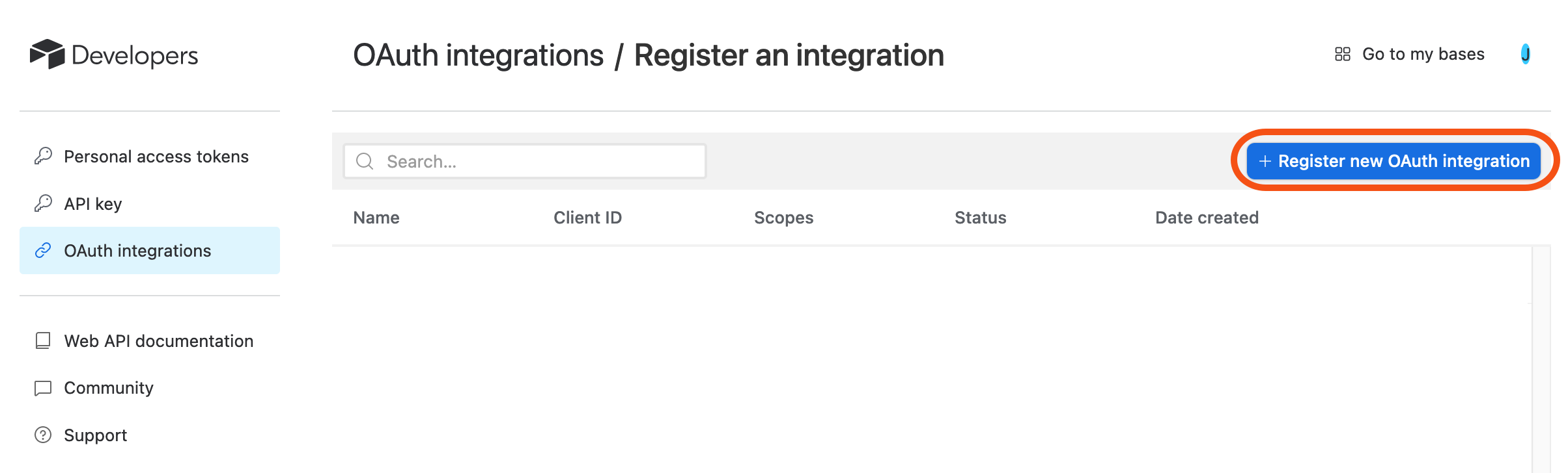

2.  Register a New OAuth Integration
Select ‘Register new OAuth integration’ and fill in the name of the app. The OAuth redirect URL should point to: https://airtable.com/create/oauth

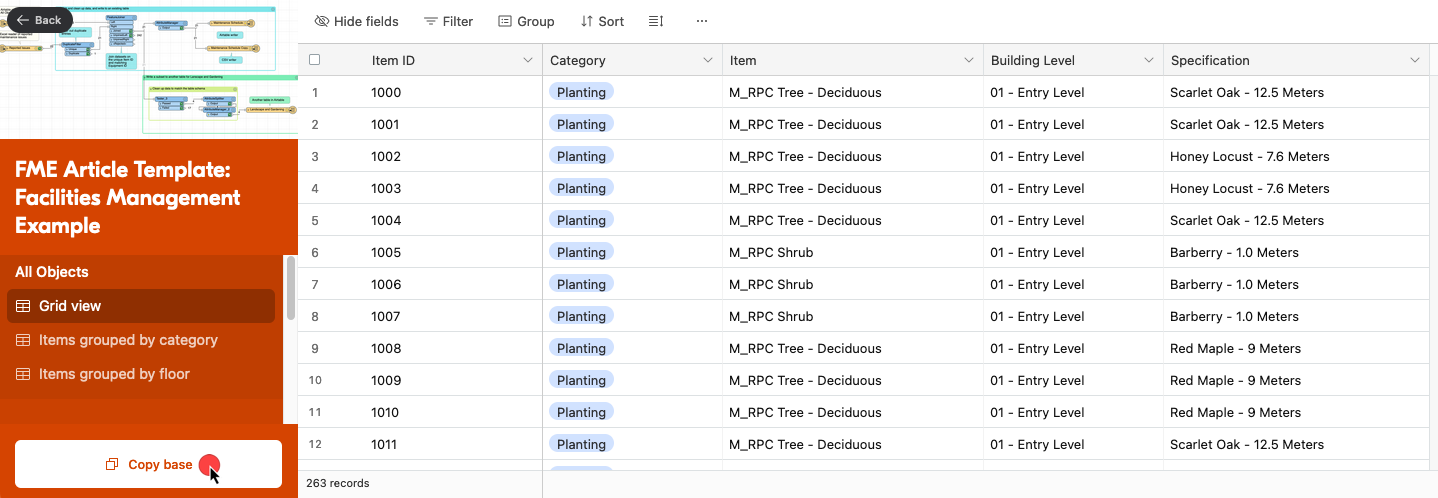

2. Make a Copy of this Base
Go to FME Article Template: Facilities Management Example and make a copy of the base to your own Airtable workspace.
Explore the schema in each table to get an idea of the structure of the data that we will be writing to. While many of these are long or single line text fields, there are some single select fields with set values that are important to note to be able to write to them successfully.

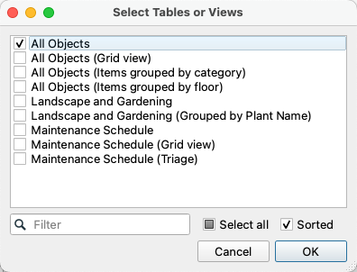

3. Read in a Table in an Airtable Base
Add an Airtable reader by typing Airtable into the canvas. Select the Connection that you just created. Click Parameters and select the Base you want to read from and press OK.
In the ‘Select Feature Types (Table)’ dialog, edit the dialog so that only ‘All Objects’ is selected.

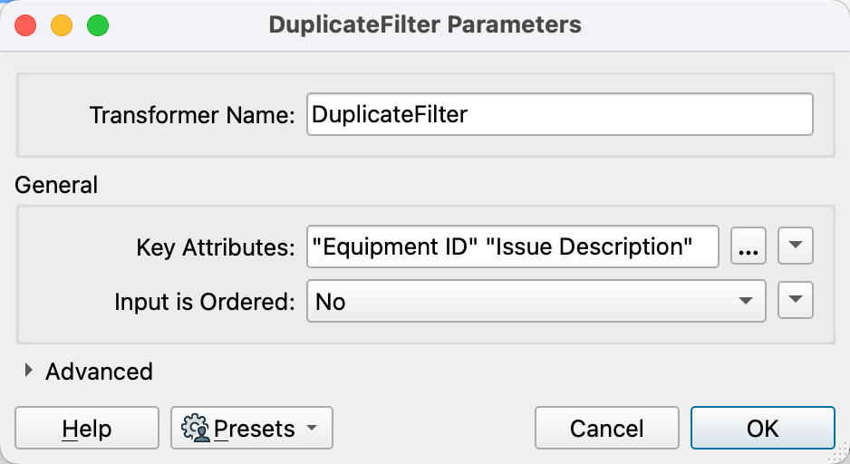

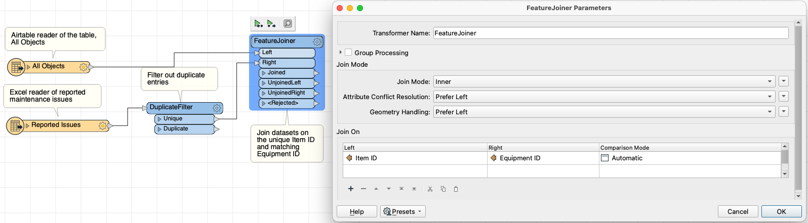

5. Check the Reports for Duplicates
Since we didn’t use an Airtable form to create this spreadsheet, let’s check for duplicate entries. Add a DuplicateFilter to the canvas and connect it to the Reported Issues feature type. Open up the transformer parameters and set the Key Attributes to ‘Equipment ID’ and ‘Issue Description’.
6. Merge Data Based on the Equipment ID
Add a FeatureJoiner and connect the All Objects to the Left port, and the DuplicateFilter Unique output to the Right port. In the FeatureJoiner, set Join On to:
  • Left: Item ID
  • Right: Equipment ID
This will join information from both tables, enhancing our existing Airtable data with recent reports of issues that people have filed for facilities management.

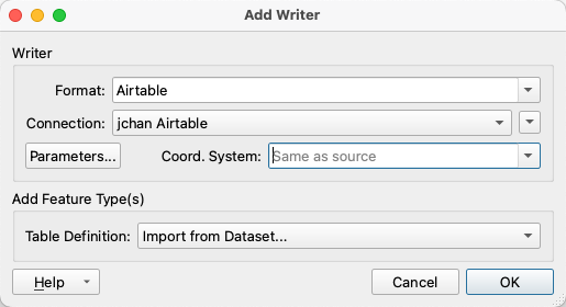

8. Add an Airtable Writer
Add an Airtable writer. Set the Connection, pick the Base you wish to write to, and set the Table Definition to ‘Import from Dataset’.
In the Import Writer Feature Types dialog, go to the Parameters, and pick your tables to import. Select ‘Landscape and Gardening’ and ‘Maintenance Schedule’ and press OK out of all the dialogs. This should add two writer feature types to your canvas.
Connect the AttributeRemover to the Maintenance Schedule Writer Feature Type.

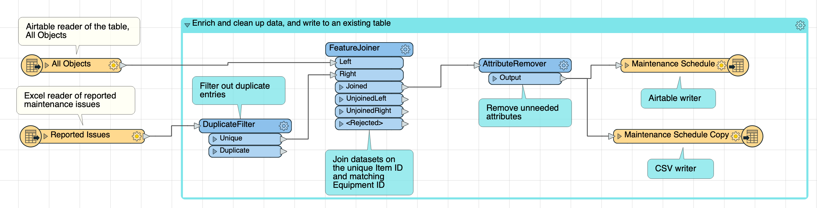

9. Make a Local Copy Using the CSV Writer
Add a CSV writer, set the CSV File Definition to ‘Automatic’ and give the CSV File a name. Connect the AttributeRemover to the CSV writer feature type.
Your workspace will look a bit like this:

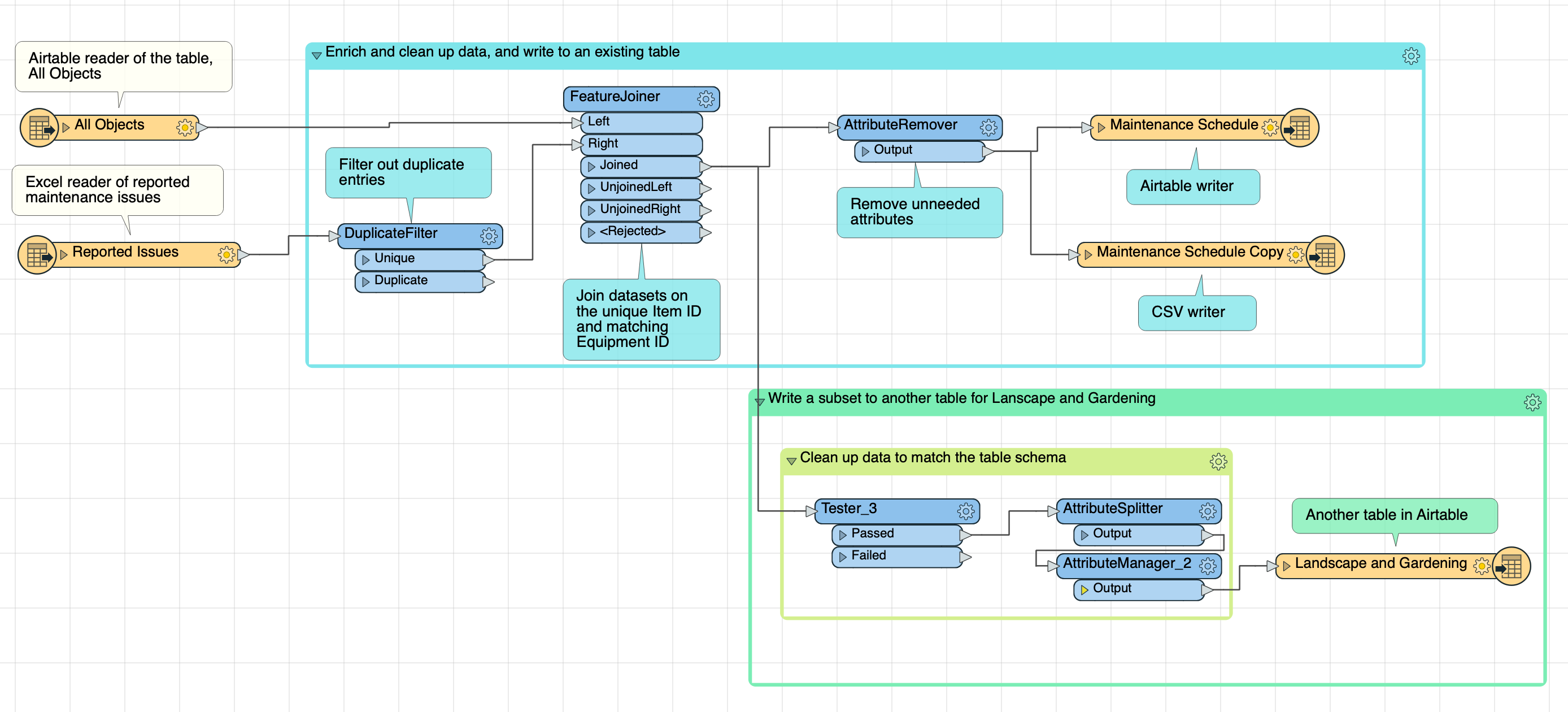

Part 4: Write a Subset of the Data to a Different Existing Table
We’re set up to write to a table for managing a Maintenance Schedule, but we also have an empty table setup for Landscape and Gardening. Using the same workflow, we can filter a subset of data to import into this new table as well.

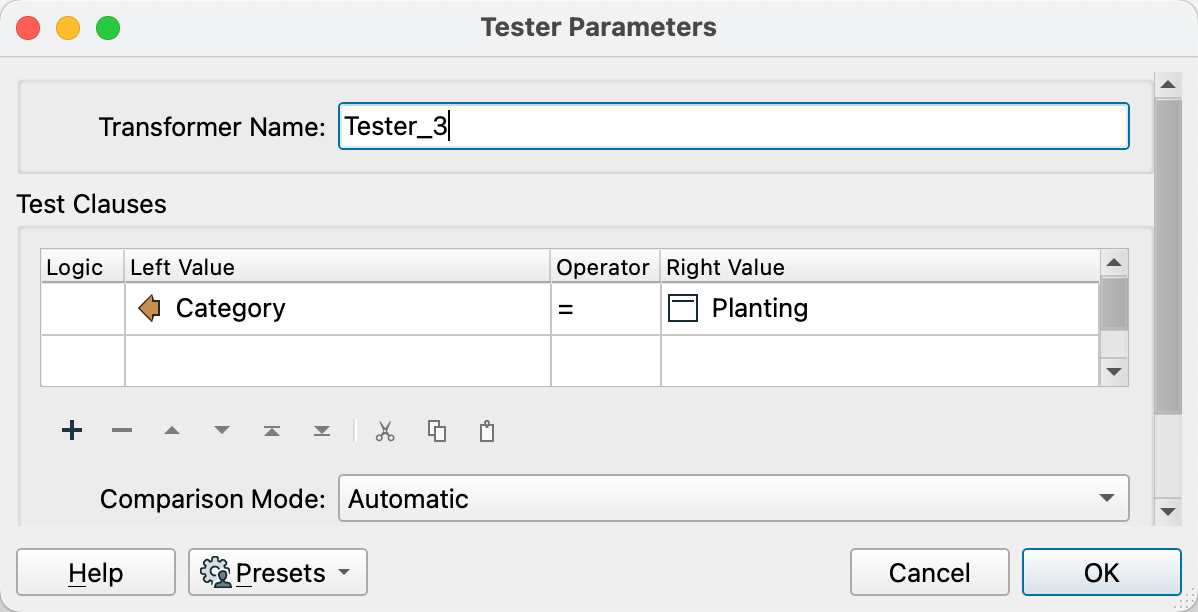

1. Filter Data for Plants Only
Add a Tester to the canvas and connect the Joined output port of the FeatureJoiner to the Tester. In the Tester parameters, set the Test Clause to
Category = Planting
2. Prepare Data to Match the Target Schema
  • Add an AttributeSplitter, and set:
  • Attribute to Split: ‘Specification’
  • Delimiter to Format String: -
  • List Name: _specs
3. Clean up Attributes
After the AttributeSplitter connect an AttributeManager. Here we will set the Specification to Value of ‘_specs{1}’ using the drop-down and selecting Attribute Value.
Create a new attribute called ‘Plant Name’ and press the up arrow to move it above _specs{}. Set the Value to ‘_specs{0}’ to split the attribute parts into two different fields or attributes.
Ensure _specs{} is at the bottom of the list, select it and hit the ‘-’ button to remove it.
4. Connect the AttributeManager to the Landscape and Gardening Writer Feature Type
Lastly, we will connect the AttributeManager to the other existing table in Airtable to populate the Landscape and Gardening table.
5. Run the Workspace
At the top left, click the green play button to run the workspace.
The completed workspace will look something like this:

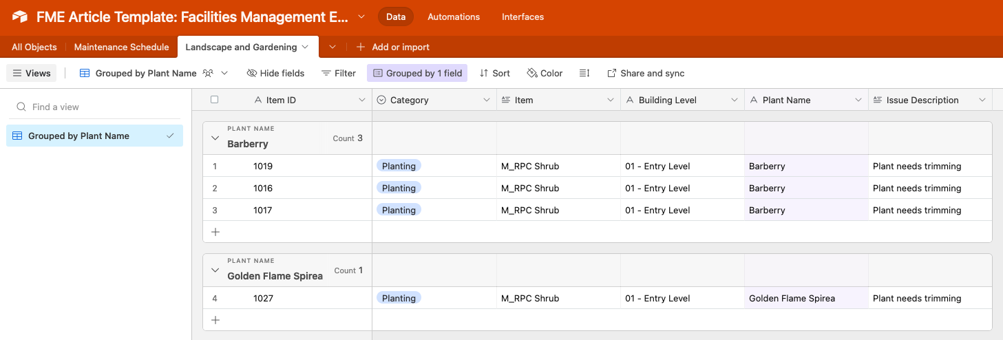

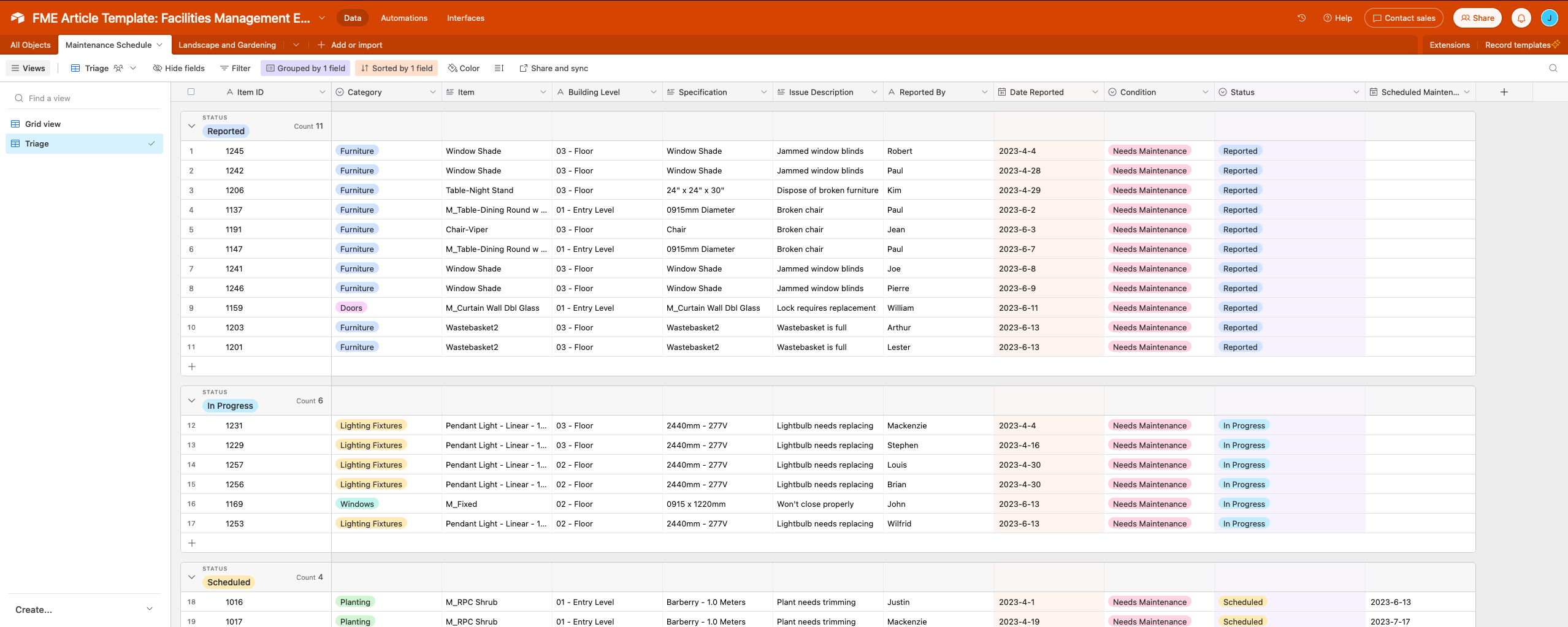

6. View the Output in Airtable
Check back in Airtable, and refresh the base. You should now see rows populating the tables for Maintenance Schedule and Landscape and Gardening.
