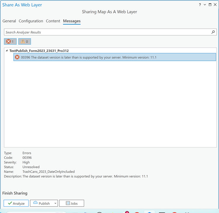

While trying to publish a feature class written to file geodatabase in FME Form 2023.1 with an ArcGIS Pro 3.1.x license, users see the following error message in the Share As Web Layer geoprocessing pane of ArcGIS Pro 3.1.x after selecting Analyze:
The dataset version is later than is supported by your server. Minimum version: 11.1
Error encountered in ArcGIS Pro 3.1.2

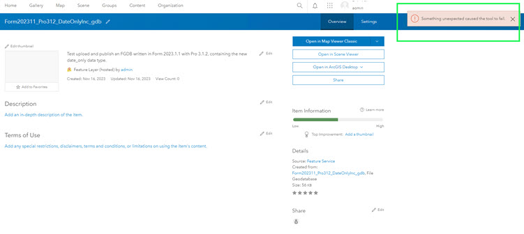

If the same geodatabase is uploaded and published to an ArcGIS Enterprise 11.0 portal, from within the My Content page of the portal, users will see the following error after adding the new item:
Something unexpected caused the tool to fail.
Error encountered in ArcGIS Enterprise 11.0 portal

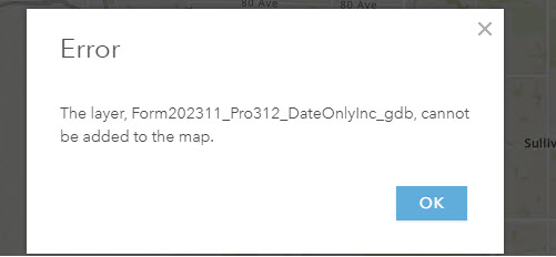

Despite the error displayed in the above screenshot, a new hosted feature layer will appear in the My Contents space. However, adding this new hosted feature layer to Map Viewer will cause the following error:
Error
The layer, <LayerName>, cannot be added to the map.
Error encountered in Map Viewer upon adding the hosted feature layer

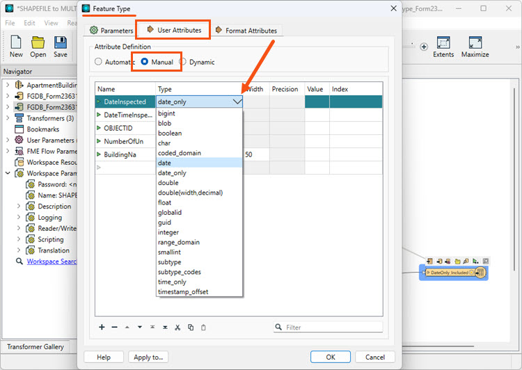

Alternatively, users who prefer to remain with FME Form 2023.1 can consider manually adjusting the data type of affected attributes from within the Feature Type User Parameters of the Esri Geodatabase (File Geodb) writer. Double-click on the file geodatabase writer feature type to open its parameters, then switch to the User Attributes tab.
Adjusting the data type of affected attributes in the Esri Geodatabase (File Geodb) writer feature type parameters dialog
Change Attribute Definition to Manual, and then adjust the data type of any attribute whose Type is set to one of the new Esri data types. This will prevent the writer from including these new data types in the written feature class(es).
