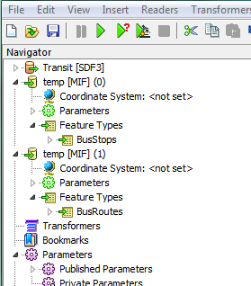

The writer feature type order cannot be controlled; however, the writer order can be controlled. This means that if you have two feature types in your workspace and you want one feature type written before another, you can add a writer for each feature type. The feature type belonging to the first writer in the Navigator pane will be written first, and the feature type belonging to the second writer will be written next.
There are two MapInfo mid/mif writers in this workspace. Bus stops will be written first, and bus routes second.
