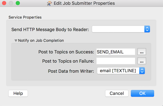

  1. Select the Job Submitter service for publication.
  2. Edit its properties, setting “Post to Topic(s) on Success” to SEND_EMAIL, and “Data to Post” to the Text File Writer.send-part3.png
  3. Finish publishing, and run the workspace on FME Server.
You should receive an email with your custom message.
