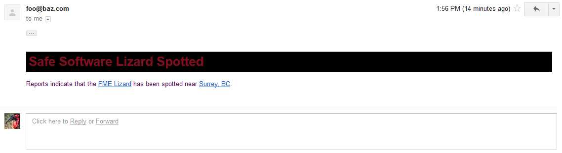

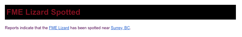

This tutorial is part of the series Email in FME Server. This is the fourth article in the sending emails series. The previous article demonstrated how to send an email after a workspace completes. This tutorial will demonstrate how to send emails with HTML. This email will include a formatted header and hyperlinks which will be dynamically generated based on the user's input. This tutorial will produce the email below.

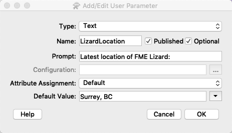

- Create a published parameter called LizardLocation. To create a published parameter, right click on the Published Parameters and select Create User Parameter. Fill in the following values in the User Parameter.

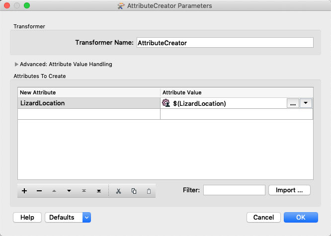

- Add an AttributeCreator to the canvas. The input of the AttributeCreator should be attached to the Creator. Modify the parameters in the AttributeCreator. In the New Attribute column write LizardLocation. The Attribute Value should be the User Parameter LizardLocation.

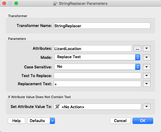

- Next, replace spaces with “+” so that the Google Maps search is properly formatted. To do this add a StringReplacer to the canvas. Connect the input of the StringReplacer to the AttributeCreator. Then, connect the output to the FMEServerEmailGenerator. The Attributes should be LizardLocation, the Mode should be Replace Text, and the Replacement Text should be +.

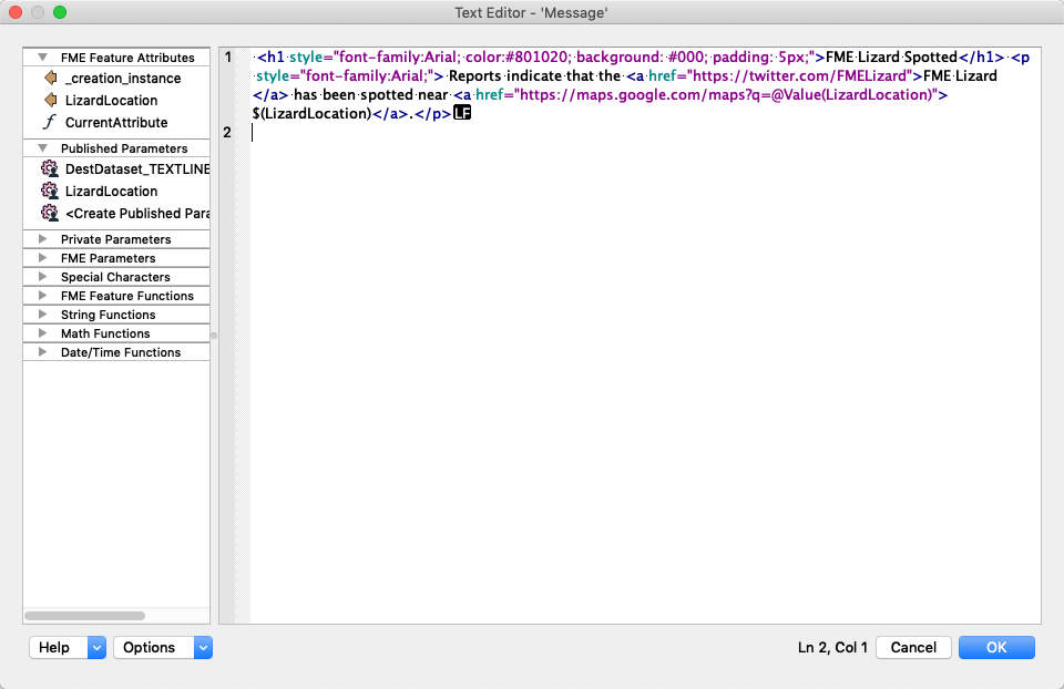

- Modify the properties of FMEServerEmailGenerator. The HTML email message is entered in the content field. It is generally easier to edit HTML in the text editor.
Please note, that to see the syntax highlighting above select Options > Syntax Highlighting > HTML.
<h1 style="font-family:Arial; color:#801020; background: #000; padding: 5px;">FME Lizard Spotted</h1> <p style="font-family:Arial;"> Reports indicate that the <a href="https://twitter.com/FMELizard">FME Lizard</a> has been spotted near <a href="https://maps.google.com/maps?q=@Value(LizardLocation)">$(LizardLocation)</a>.</p>
The completed workspace can be found at the beginning of this article.
Note, that not all email clients support <head></head> tags, so it is better to use inline styles, as in the example above. For more information about formatting, see the HTML and CSS references at http://www.w3schools.com/.

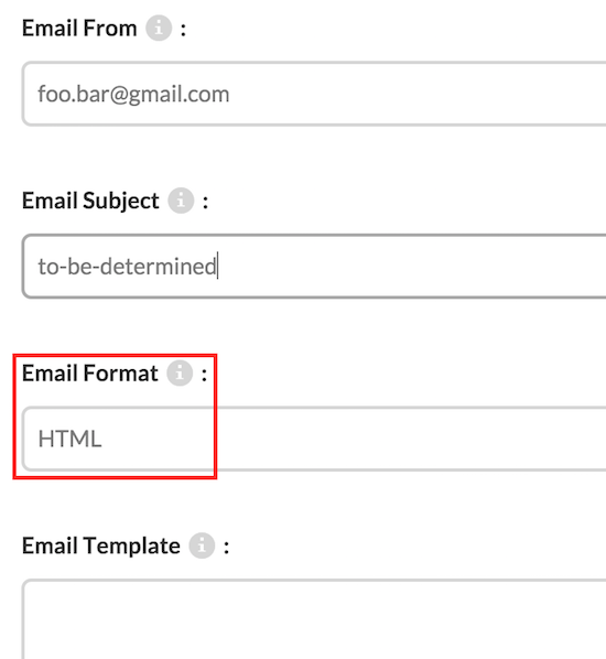

Since you will be sending a different MIME type (text/html instead of text/plain), you will need to configure this using the FME Server web interface.
- Go to Notifications > Subscriptions > SEND_EMAIL
- Change the email format to HTML
- Click OK
