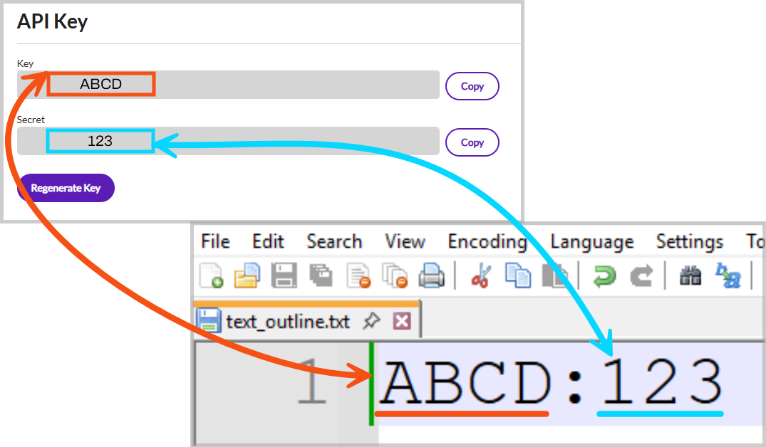

Start by creating a text file containing the API Key and Secret provided by Precisely as outlined by their documentation. Using Notepad++ or a similar text editor, create this text file; it should look something like this:
Save the file as text_outline.txt

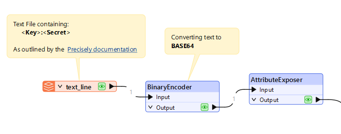

Add a Text File reader and browse to the text_outline.txt file created in step 1.

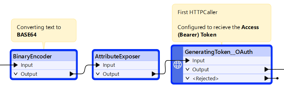

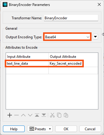

Connect the text_line reader feature type to a BinaryEncoder transformer to convert the text file to BASE64, as outlined by Precisely’s documentation. In the BinaryEncoder parameters, set the Output Encoding Type to Base64, then set the Input Attribute to text_line_data and the Output Attribute to Key_Secret_encoded.
Finally, expose the encoded text attribute, so you can pass that value into the HTTPCaller. Add an AttributeExposer and set the Attribute to Key_Secret_encoded.
3. Configure the HTTPCaller According to the API’s Documentation
In this example, the HTTP Method is set to POST, and the Header and Body have been configured to carry the Authorization Key. The output of HTTPCaller will be stored in the _response_body

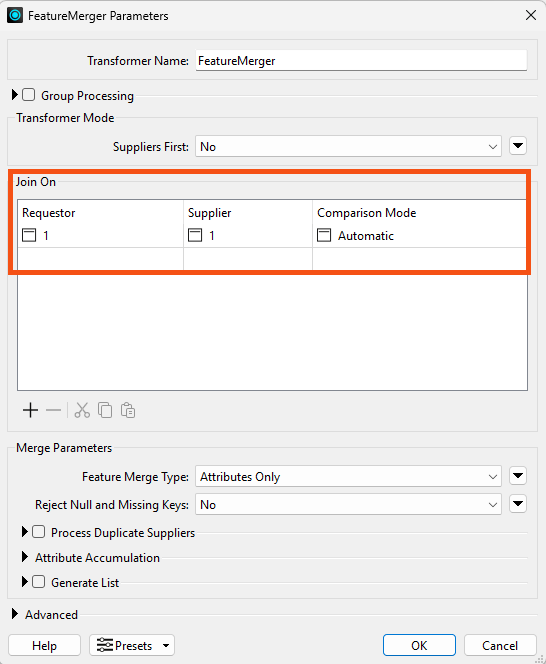

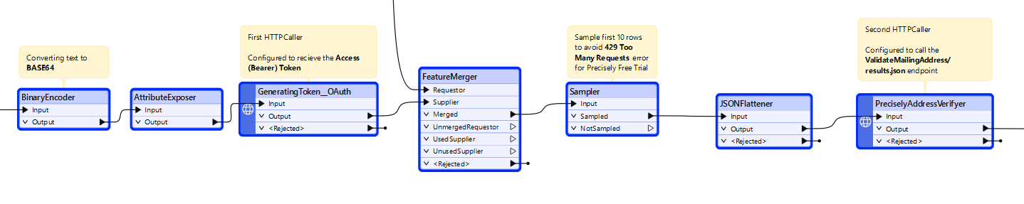

Use a FeatureMerger to add the _response_body to each row in the census data, by setting the Join On Supplier and Requestor values to the same constant (i.e, the value “1”) and leaving the Comparison Mode as Automatic.
7. Flatten JSON
Connect the Merged output of the FeatureMerger to a JSONFlattener. The JSONFlattener will extract the object keys and values into FME feature attributes. If you need a refresher on working with JSON in FME, refer to this tutorial. In the JSONFlattener parameters, set the JSON Document to _response_body, then for Attributes to Expose, click the ellipsis, then type access_token.

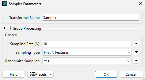

8. Limit Calls
With the Precisely free trial, there is a limit to the number of calls that can be made. To avoid any 429 responses, add a Sampler between the FeatureMerger and JSONFlattener and configure it to sample the first 10 rows of the merged data.
In the output, we see that all features now have an access_token attribute. We are now ready to use these features in our first API Call.

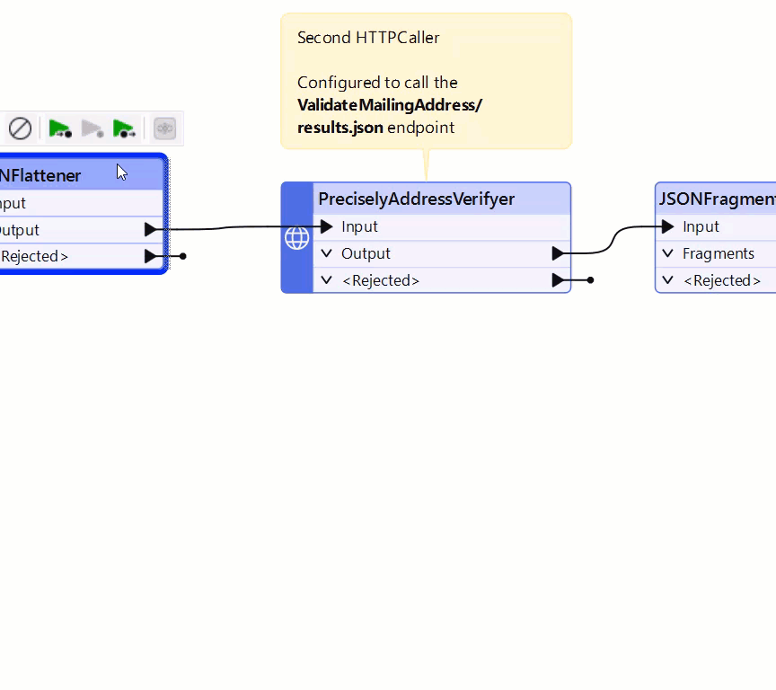

Part 2: POST HTTP Method: Configure the HTTPCaller to make your first API Call
Put down another HTTPCaller on the Workspace. Refer back to the documentation for the API for the request parameters of the API.
   "options": {
       "OutputCasing": "M"
   "Input": {
       "Row": [
               "AddressLine1": "@Value(address)",
               "AddressLine2": "",
               "City": "@Value(city)",
               "Country": "USA",
               "StateProvince": "@Value(state)",
               "PostalCode": "@Value(zip)",
               "FirmName": "@Value(company_name)"
The Response URL has .json at the end, as we want our results returned in JSON. Please refer to the Address Verification Precisley API documentation for more detailed instructions about this API, the link requires a Precisely account to view.
Confirm your configurations and run your HTTPCaller.

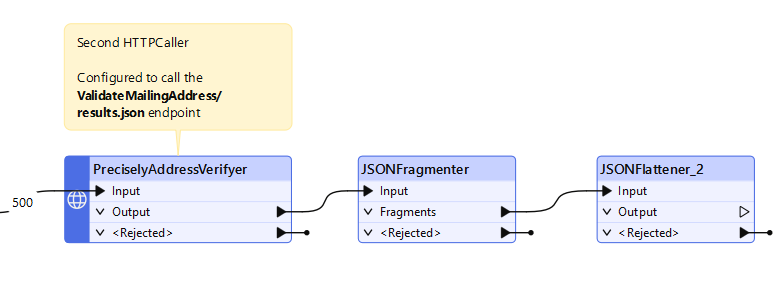

Part 3: Parsing the response body
These transformers come in handy when parsing JSON
Let's create a sequence of these transformers that will correctly extract information from the response body of our API every time. You can visualize your response body in any JSON Parser of your choice to understand the schema of your API call.
​​​​​​​1. Fragment JSON
First, add a JSONFragmenter to fragment a section of your response body that you want to flatten. Select _response_body to be the JSON Attribute. For JSON Query, input:
json["Output"][*]
2. Flatten JSON

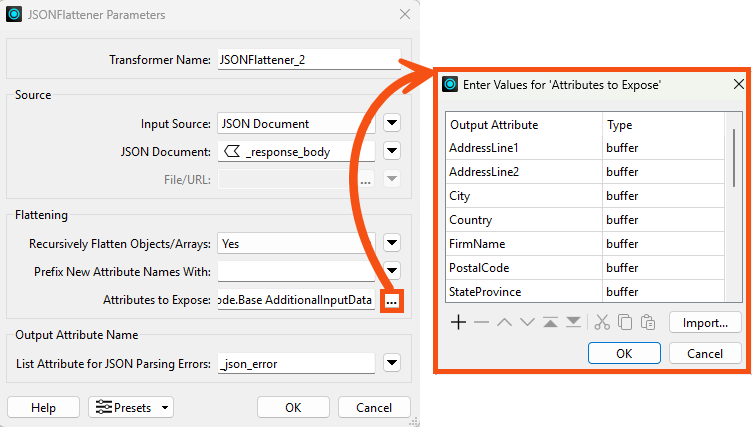

Connect another JSONFlattener to expose the attributes. There are a few ways you can go about doing this.
  • Manual Selection
  • Import Schema

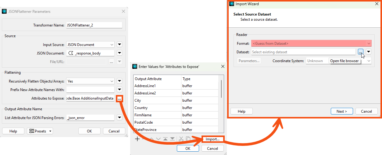

To manually select attributes to flatten, enter the values into the “Attributes to Expose”.
To Import Schema from a source, select Import to bring in a source document that follows the same schema. You could achieve this by simply saving a .json file of the _response_body locally.
​​​​​​​Run the JSONFlattener, and your selected attributes will be exposed in your table.

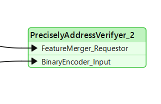

  1. Select the sequence of transformers on the canvas that satisfies the use case
  2. Right-click or (Ctrl + T) to create your custom transformer.
  3. In the dialog, set:
    • Transformer Name
    • Attribute References
    • (Optionally) Category and Description
  4. Add Input and Output ports to match your design.
