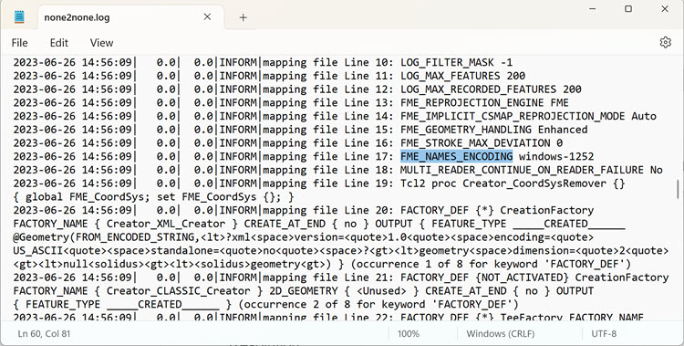

Workspaces built in FME Workbench pre-2021.0 did not store the character encoding system of the machine used to create the workspace. Workspaces, including template workspaces, built or saved in FME Workbench 2021.0 or newer do store such an encoding indicator, as the FME_NAMES_ENCODING field. This field can be viewed in translation logs where Log Debug has been enabled from the Translation menu of FME Options. The value of FME_NAMES_ENCODING for workspaces built and / or saved in FME Workbench 2021.0 or newer is set to the current OS locale encoding system.
