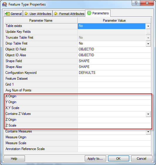

You can try to explicitly set the origin and scale values in the destination feature type parameters tab:
Note that "X,Y Scale" is the inverse of the ArcGIS "XY resolution".
