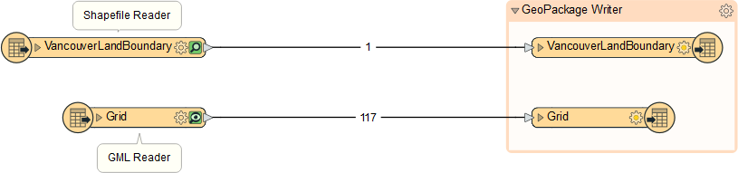

1. Open Starting Workspace
Open the "Begin" workspace provided 2-WorkflowComponentsExercise-Begin.fmw and run it.
Notice that we're reading from two formats of data - GML and shapefile - and writing out to two tables in a GeoPackage database.

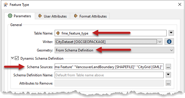

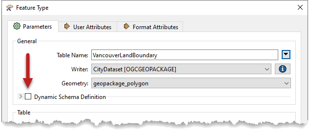

We need to make the writer dynamic, and the readers as well. Let's start with the writer. Open the parameters dialog for the VancouverLandBoundary writer feature type. It will look like this:
Notice how the table name and geometry are set to fixed values. But the key setting is labeled Dynamic Schema Definition. Click that box to add a check mark. The dialog will now change to this:
Notice how the Table Name has changed (it is now dynamic, set according to the original feature type name), that Geometry is now dynamic, and that there is a Schema Sources parameter.

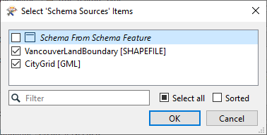

Click the ellipsis [...] button next to the Schema Sources parameter. This is where we choose which source the schema should come from. In this case, it comes from the two readers. It does not come from Schema Features, so uncheck Schema From Schema Feature, and click OK.
Click OK again to return to the canvas.

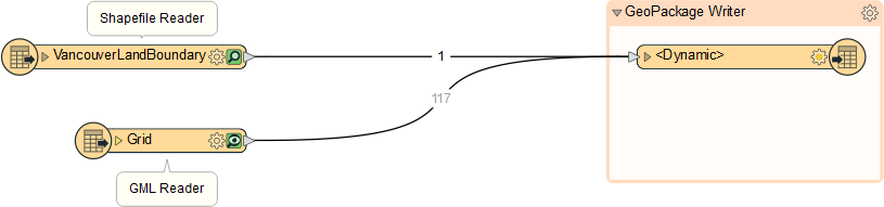

3. Remove Static Writers
Now that we have a <Dynamic> feature type, we don't need any remaining static ones. So, delete the Grid writer feature type and connect the Grid reader feature type to the <Dynamic> writer feature type.
Now, if you run the workspace, the output will be the same as before, except that the schema is being fetched dynamically. If the source schema should change - a process called Schema Drift, which we will cover later - then the output will change to match.

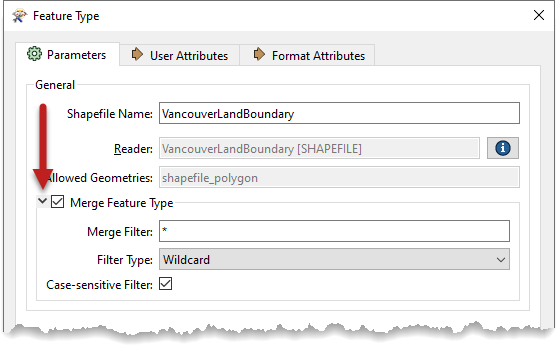

4. Change Readers to be Dynamic
Open the parameters dialog for the VancouverLandBoundary reader feature type. Check the box labeled Merge Feature Type:
Click OK to close this dialog. Repeat the process on the Grid reader feature type.

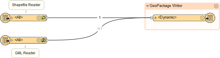

The name of the feature types changes to <ALL>, and so the canvas will now look like this:
Question) Why do we need to repeat the process for both feature types? Why can't we delete one of them in the same way that we did for the writer?

The answer is that we need two readers because the source data is in two different formats. You could replace those readers with a single Generic Format reader if you wanted to reduce it all to a single feature type, but this method gives you easier control of the reader parameters.
