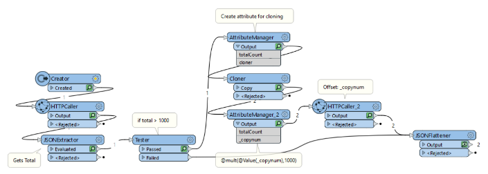

Example 1: Cloner with Offset-Based Pagination
This example uses the FME Server REST API. Since it returns the total count, there is no need to loop. The following example shows how to use a Cloner to get all results from the API
1. Open FME Workbench
Open FME Workbench and click New to create a new workspace.
Add a Creator to the canvas.

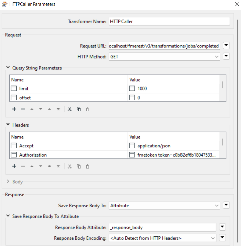

2. Add an HTTPCaller
Add an HTTPCaller to the canvas and connect it to the Creator. Click on the cog wheel to configure the parameters, they should look like this:
  • Request URL: http://localhost/fmerest/v3/transformations/jobs/completed
  • HTTP Method: GET
  • Query String Parameters:
    • limit: 1000
    • offset: 0
  • Headers:
    • Accept: application/json

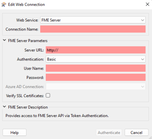

Use a web connection to your server by selecting the checkbox “Use Authentication” and Authentication Method as Web Connection. Add a web connection.
Fill out your credentials for your FME Server and this will provide access to the FME Server API via a Token Authentication.

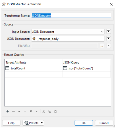

3. Extract the Total
Add a JSONExtractor to the canvas and connect it to the output port of the HTTPCaller. Open the parameters and set the Target Attribute to “totalCount” and the JSON Query to:
json["totalCount"]

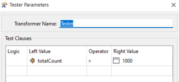

4. Test the totalCount
The response has a maximum limit of 1000, therefore if there are responses less than 1000 we only need one call and no pagination and can parse the JSON right away. If there are more than 1000 responses then we need pagination. Add a Tester to the canvas and connect it to the JSONExtractor. In the parameters, enter in this logic:
  • Left Value: totalCount
  • Operator: >
  • Right Value: 1000
5. Pagination through Cloning
Add an AttributeManager to the canvas and connect it to the “Passed” port of the Tester. Manage the attributes by removing any that are undesirable, keep totalCount, and create a new attribute called “cloner”. Set the value of cloner attribute to:
 @add(@int(@div(@Value(totalCount),1000)),1)
This ensures that the value has no decimals (int) after being divided, and includes the original plus the pagination (add, 1).
Add a Cloner to the canvas. The number of copies will equal the attribute totalCount.
Add another AttributeManager to the canvas and connect it to the Cloner output port. Set the value of _copynum to
@mult(@Value(_copynum), 1000)
which will multiply the value by a thousand. This will be the offset for the HTTPCaller.
6. Final Call
Duplicate the HTTPCaller, and connect it to the last AttributeManager. Parameters stay the same except change the offset to the attribute _copynum.
7. Add a JSONFlattener
Add a JSONFlattener to the canvas and connect the input port to the output port the second HTTPCaller and the failed output port of the Tester. This will parse your data into a list attribute. For more information on lists see the Getting Started with List Attributes article
8. Run your workspace
Run your workspace and it should look like the image below.

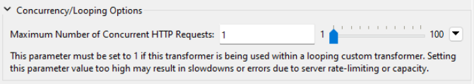

Concurrent Requests should be set to 1.
For more information on using the HTTPCaller and using HTTP Requests, see the HTTP Requests with the HTTPCaller article.

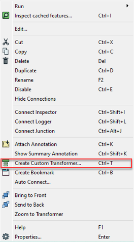

4. Create a Custom Transformer
Right-click on the HTTPCaller or click on the HTTPCaller and press CTRL+T to create a new Custom Transformer with the HTTPCaller inside. Name the transformer what you would like to call it.

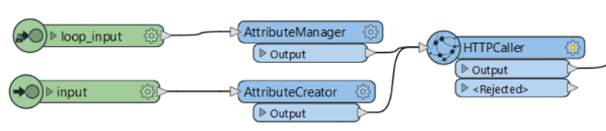

6. Attribute Management
Add an AttributeCreator to the canvas and put this between the input port and the HTTPCaller. Create an attribute called _copynum and set the value as 0. This will be used to count the pagination.
Add an AttributeManager to the canvas and connect the input port to the “loop_input” and connect the input port to the HTTPCaller. Expose the attribute that you created and open the Text Editor to change the value of this attribute. Input this into the Text Editor:
@add(@CurrentAttribute(),1)
You can find math functions in this documentation where it explains what each of them do.
Your workspace should look like this:
