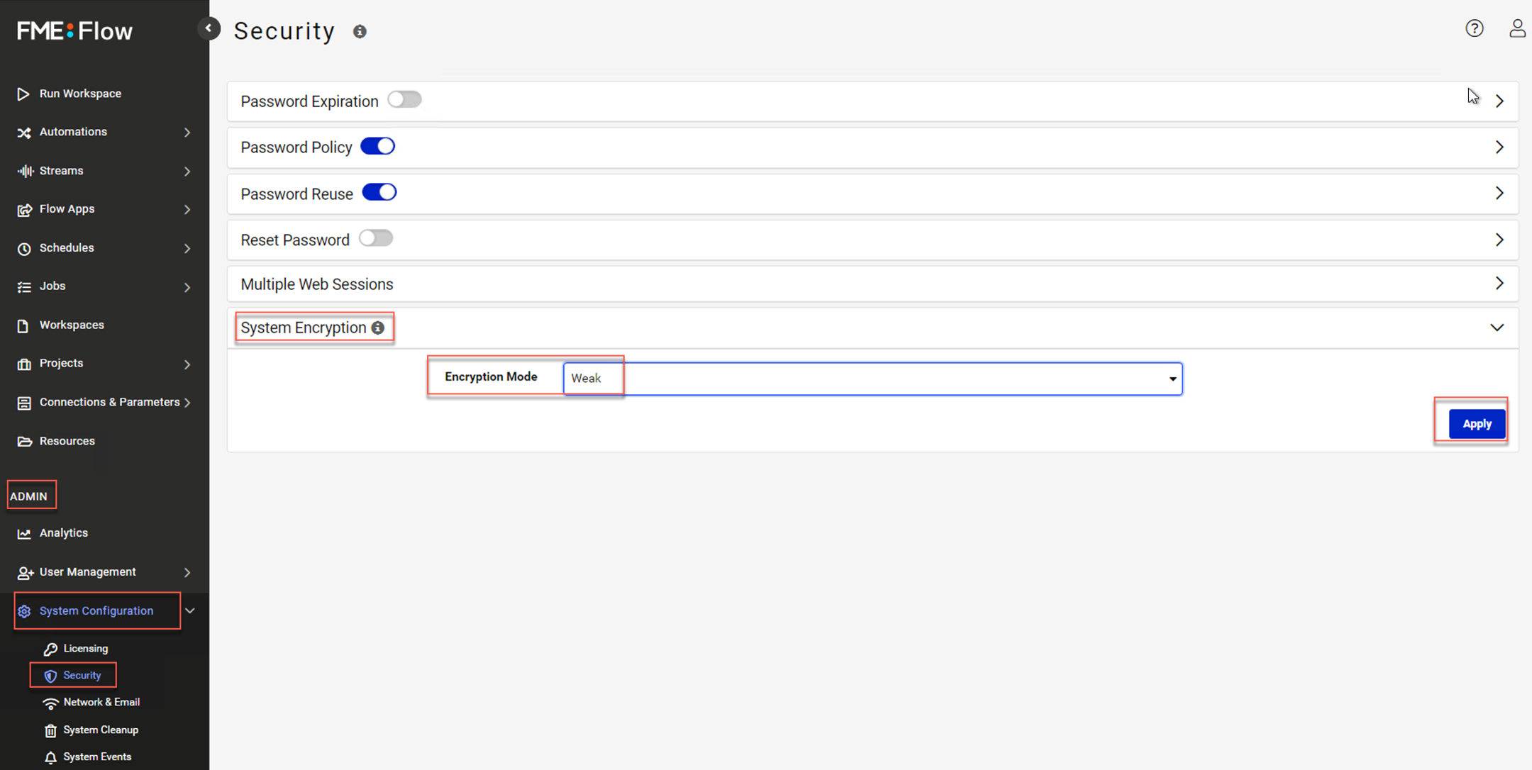

Part 1: Working with “Weak” encrypted FME Flow instance
The default Encryption Mode for the System Encryption setting is “Standard,” which employs a custom encryption key specific to your FME Flow installation.
If you decide to include sensitive data in your project export, that data will always be encrypted. But the security level depends on whether you use the weak encryption key shipped with every FME Flow [Encryption Mode=Weak] or use a custom stronger encryption key specific to your install [Encryption Mode=Standard].
In the case of Standard mode, when importing the project into a new FME installation, you will need to provide the unique encryption key from the source FME Flow instance. However, in this section, we will discontinue the use of custom encryption by opting for "Encryption Mode: Weak" within the Admin > System Configuration > Security > System Encryption settings on both the source and target FME. So, we do not need to provide any key during project import.

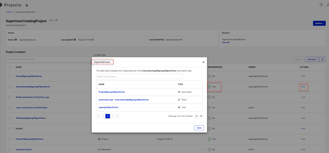

As an FME Superuser
You will be able to add any test FME object types mentioned above and any object irrespective of owner.
If the object has any dependencies [indicated by the green check icon under “Dependencies”], you will be able to view it by clicking the “Actions” ellipsis on the individual object. You do not have to manually add these dependencies to this project. In previous versions, the user would have to manually add all dependencies to the project at the time of export and then manually check that everything is expected on the target FME Flow once the import is complete.

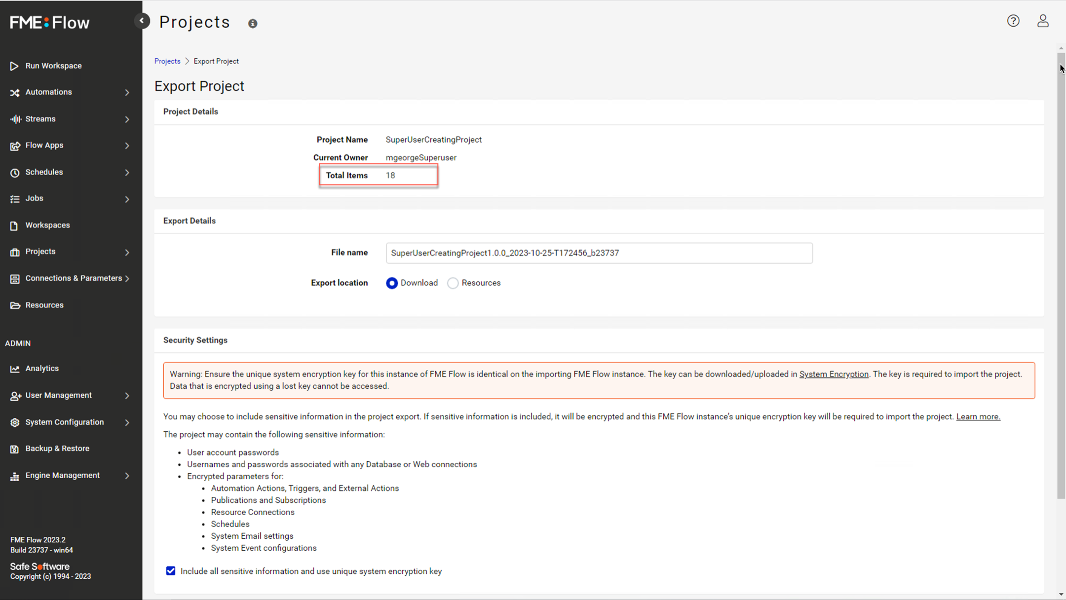

Exporting the project
To export a project, please follow the documentation Exporting and Importing Projects.
As an FME superuser/owner FME Author/non-owner FME Author
You can opt to “​​Include all sensitive information and use unique system encryption key” or not include them. Although the encryption mode is selected as “Weak” in this case, the sensitive information is still included and encrypted but with a weaker encryption key, which is shipped with the FME Flow installer.
All applicable object types will be exported with their current dependencies automatically, although it is not explicitly indicated in the “Total items” field under “Project Details.” During export, all dependencies are also updated by default to ensure you have the most updated version of the objects. In previous versions, there were issues with dependencies not being updated during export, and items required for the workflow to work could be out of date or not included.

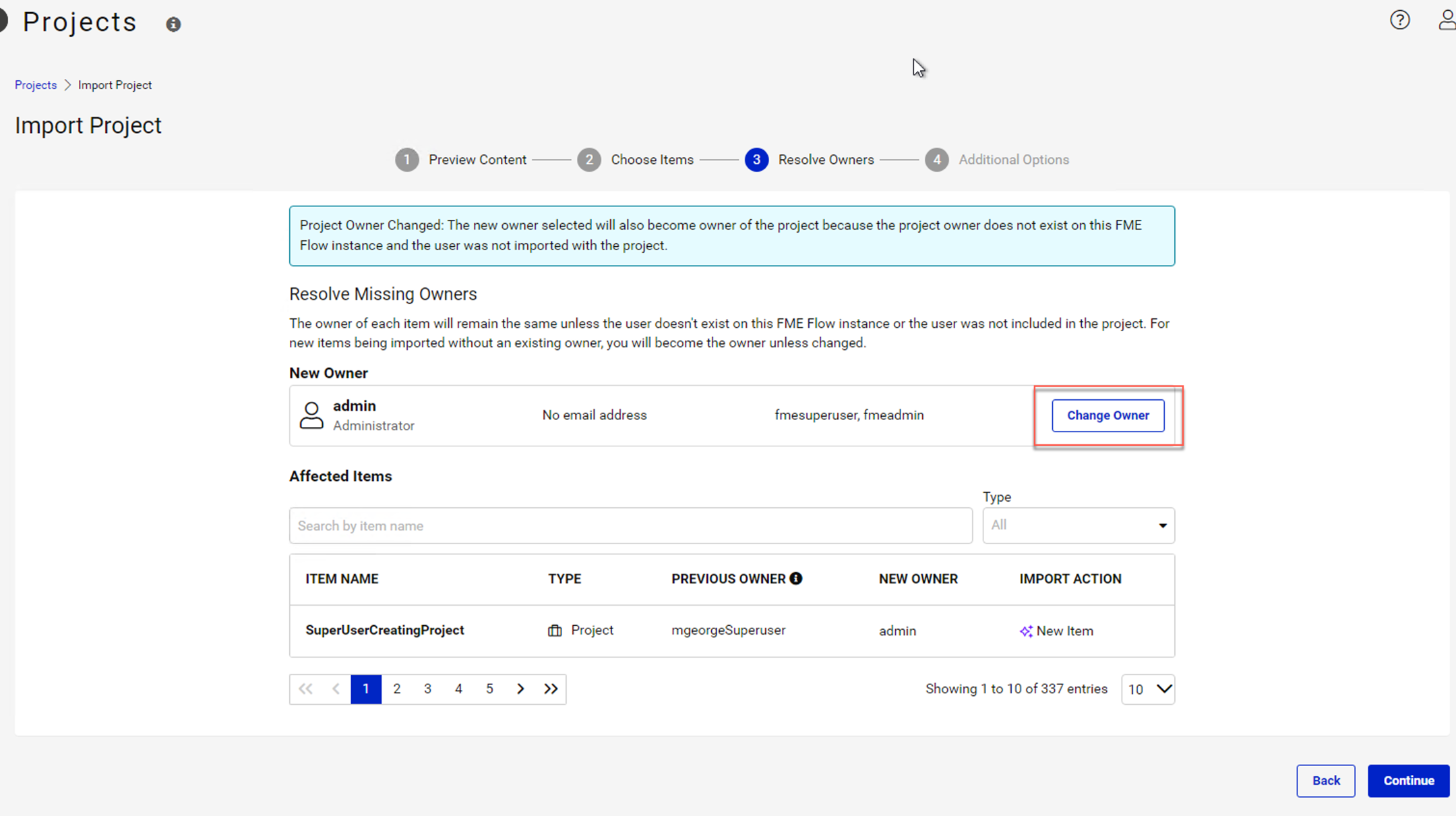

As an FME Superuser who did not export the project and does not exist on the source FME
In this test, the superuser that exported the project does not exist on the target FME. Also, the user was not imported with the project file. A different Superuser on the target FME has imported this project. Therefore, this Superuser importing will be the new owner of the imported project. If you would prefer, you will get an option to change the owner during the import process.
You are also provided with the option to “Allow items to be overwritten if they already exist”. Web and database connections are no longer imported and overwritten by default.
The owner of each imported item will remain the same as the origin FME unless the user doesn't exist on the target FME Flow instance or the user was not included in the project. For new items being imported without an existing owner, the fmesuperuser importing will become the owner unless changed.

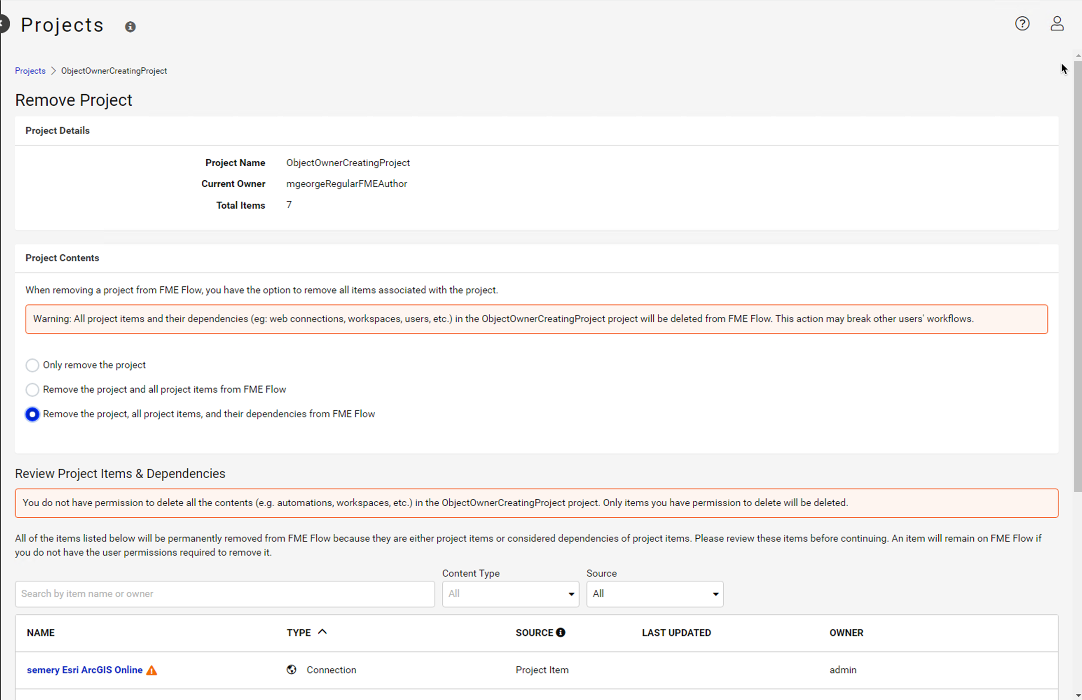

Part 3: Removing a Project
In the new version, more options are provided when removing a project from FME Flow:
  • Only remove the project
  • Remove the project and all project items from FME Flow
  • Remove the project, all project items, and their dependencies from FME Flow
For the latter two options, you can review Project Items & Dependencies before deleting. Only items you have permission to delete will be deleted.
