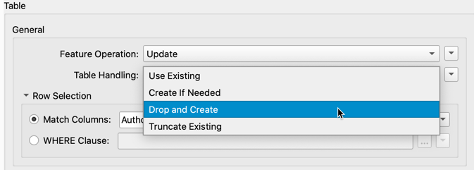

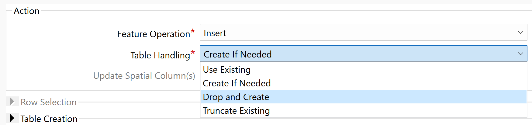

Truncating and Dropping Tables
Related to indexing is the difference between truncating a table and dropping it. FME has settings to do either, but when you truncate a table, the index remains, and subsequent data loading is slower. When you drop a table, all indexes are also dropped; hence, data can be written faster because no indexing is taking place. ​​​​​​​
Tip: Consider using the Drop and Create table option rather than Truncate Existing to improve performance during a bulk data load.
