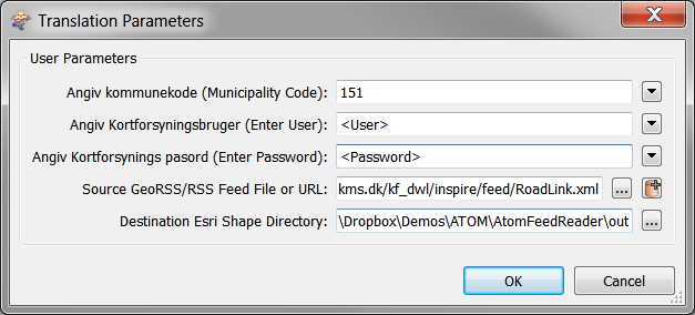

1. The workspace includes 4 published parameters as shown below. The GeoRSS URL is the end point for the RoadTransportNetwork layer ATOM feed.
You will need to create your own user account if you want to run this workspace by going to the Danish Geo Data Agency website here: http://download.kortforsyningen.dk/feeds
