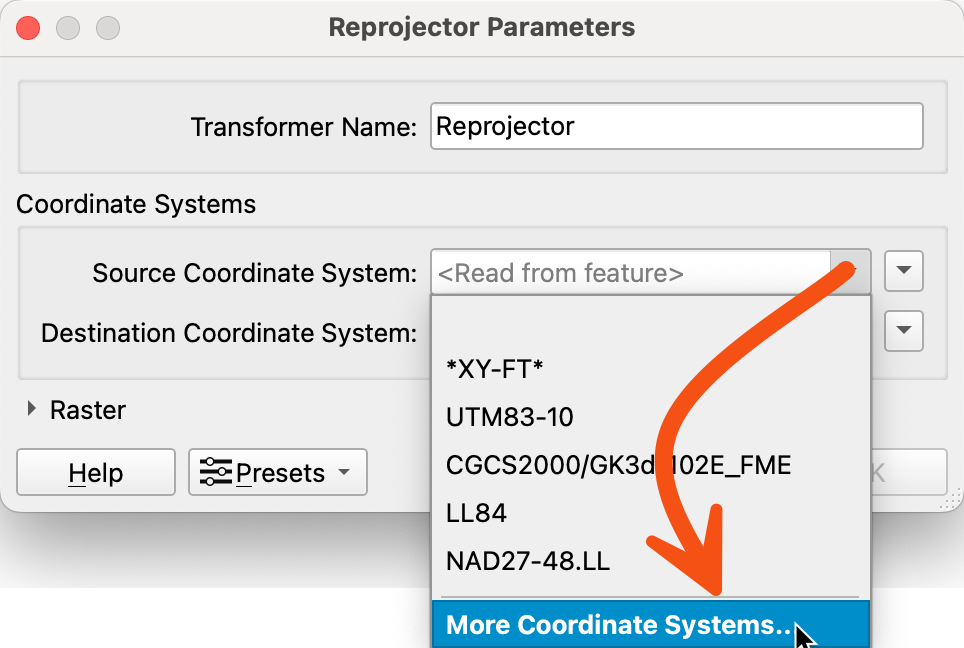

From a transformer or reader where coordinate systems can be accessed, open the Coordinate System Gallery. For example, from the Reprojector transformer, click the drop-down arrow next to Source Coordinate System and click More Coordinate Systems.

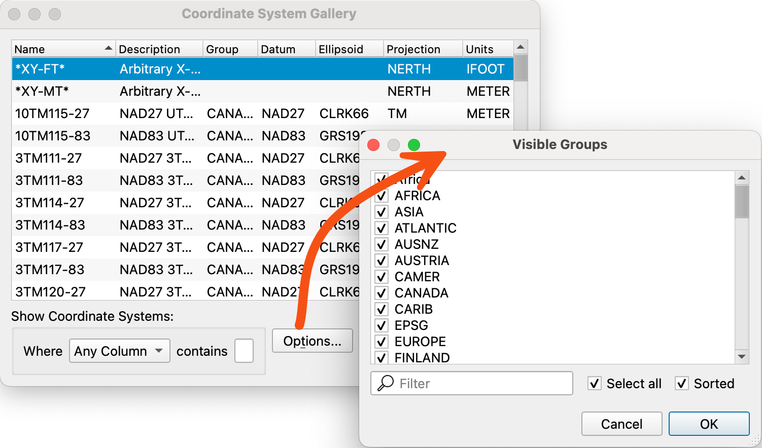

At the bottom of the Coordinate System Gallery dialog, click Options and click Select All in the Visible Groups dialog.
