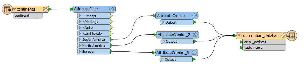

1) Open the 2_create_subscription_database.fmw workspace in FME Workbench.

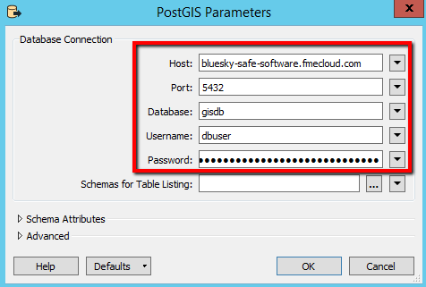

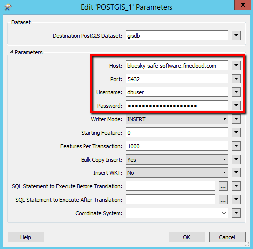

Modify the PostGIS writer’s connection parameters to match your PostGIS database.

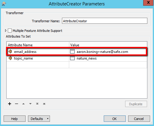

3) Open the AttributeCreator transformers and change the email addresses to your own email address. For testing purposes, use the +keyword notations to make the email addresses look unique in your email client (e.g. fmeserver+transit@gmail.com).

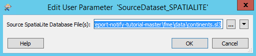

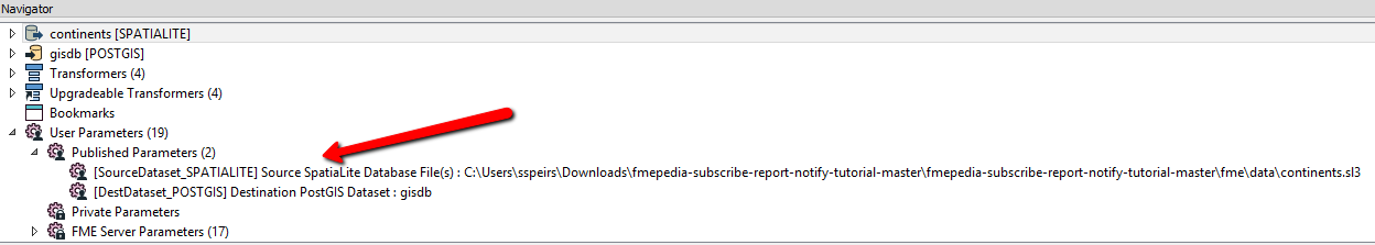

4. In the Navigator panel find User Parameters > Published Parameters > [SourceDataset_SPATIALITE] Source SpatiaLite Database File(s).
5. Double click the path and the Edit User Parameter ‘SourceDataset_SPATIALITE’ dialog opens. Click the ellipsis (...) and search to where you saved the downloads for this tutorial. Browse to fme/data/ and select continents.sl3 and click Open. Click OK on the Edit User Parameter ‘SourceDataset_SPATIALITE’ dialog.
6. Run the workspace to create a table called subscription_database.
This creates a spatial database with three different email addresses subscribed to three different topics in specific geographic regions (in this case different continents). Again, manually editing this database is easy enough for static or low numbers of subscriptions.

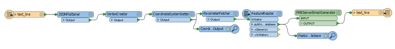

2) Note the VertexCreator and CoordinateSystem transformers that convert the textual representation of the messages location into a native FME geometry.

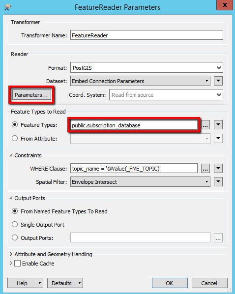

3) Open the FeatureReader transformer and modify the PostGIS reader’s connection parameters to match your PostGIS database. The FeatureReader is like the Joiner, except it also tests spatial relationships. (Make sure to select the corresponding subscription_database associated with your Table Qualifier - i.e. "public" in this example.)

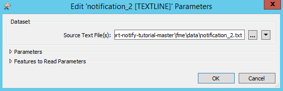

4. Click to edit the text_line reader parameters. In the Edit ‘notification_2 [TEXTLINE]’ Parameters dialog, set the Source Text File(s) to your own downloaded copy of the notification_2.txt (located in fmepedia-subscribe-report-notify-tutorial-master/fme/data/ folder)

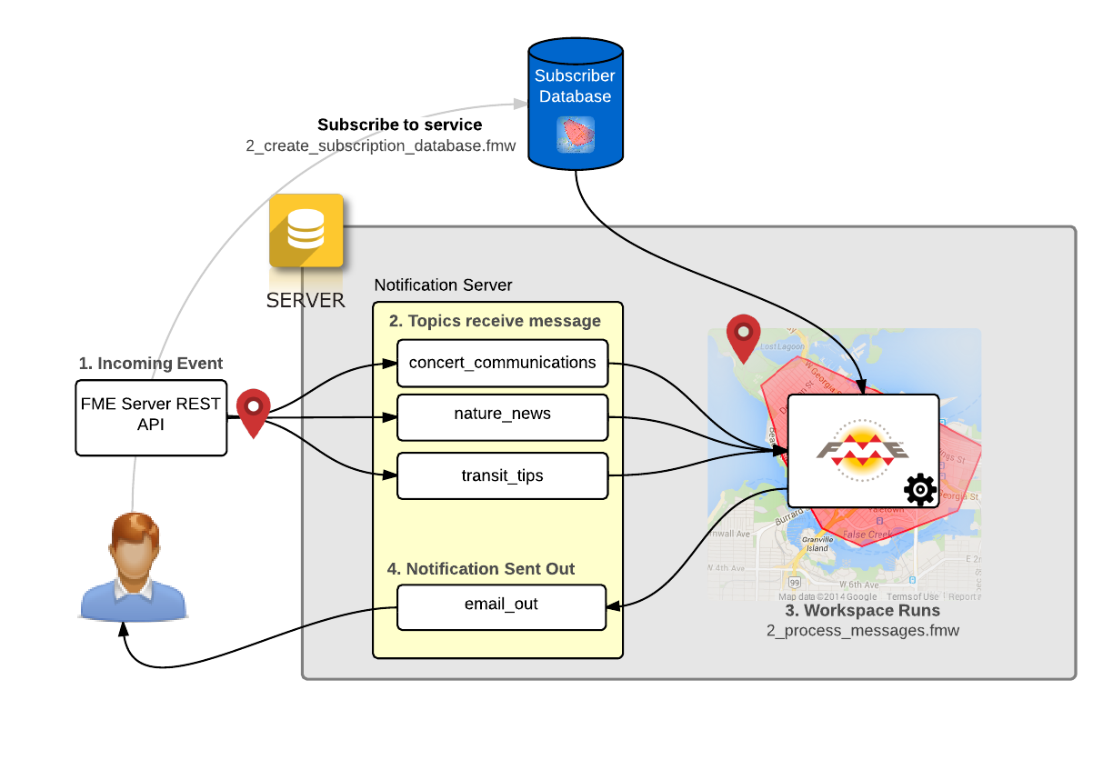

Now you have a configuration that will:
  • Receive messages from the concert_communications, nature_news and transit_tips topics.
  • Check the database to see which email addresses are subscribed to both the topic the message was received from AND the area where the message is located.
  • Send an email notification to the subscribed email addresses.

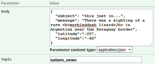

1) Open the FME Server REST API from the FME Server Web User Interface by clicking: Developers> REST API > API> notifications: Notifications Manager > POST /notifications/topics/<topic>/message
2) For the body parameter enter:
"subject": "this just in...",
"message": "There was a sighting of a rare <b>warbleddash lizard</b> in Argentina near the Paraguay border",
"latitude":"-25",
"longitude":"-60"
3) For the topic parameter enter: nature_news
4) Click the Try it out! button.
5) You will prompted to login if you haven’t already (Remember: username and password are the same as your FME Server account). Afterwards click Try it out! again.
6) You should receive an email to the address you specified for the nature_news topic back when you created the database.

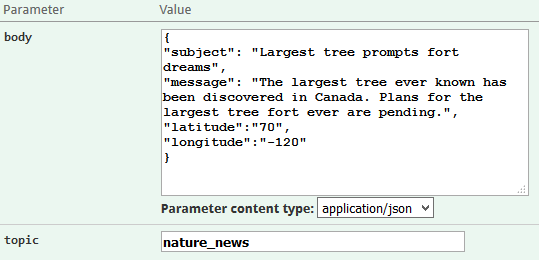

7) Try sending another message to the nature_news topic, this one outside of the subscription area:
"subject": "Largest tree prompts fort dreams",
"message": "The largest tree ever known has been discovered in Canada. Plans for the largest tree fort ever are pending.",
"latitude":"70",
"longitude":"-120"
8) Since there is no subscription to both the nature_news topic AND an area that covers Canada, no notification will be sent.
