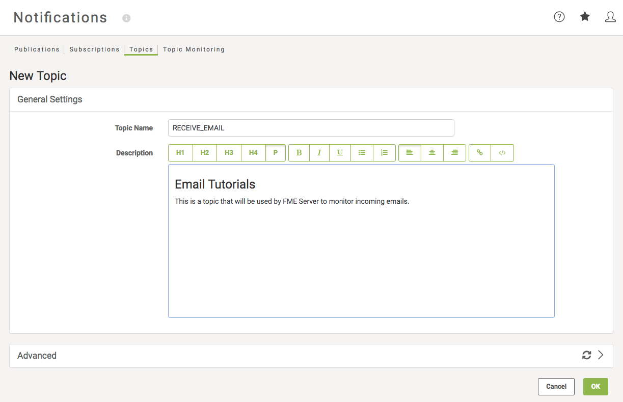

In order to receive emails, FME Server must be set up to publish these incoming notifications to a topic. The first step is to set up a topic. Since a topic is just a named “channel” all this involves is giving the topic a name and description.
- In FME Server, in the menu on the left-hand side under Notifications select Topic, on this page select ‘New’.
Create a New Topic from the Topic Notifications home page
- Set the Topic Name to RECIEVE_EMAIL, then set the Description to:
Email Tutorials
This is a topic that will be used by FME Server to monitor incoming emails
Then click OK to create the Topic.
Complete the topic configuration
The topic will show up in the list of topics.

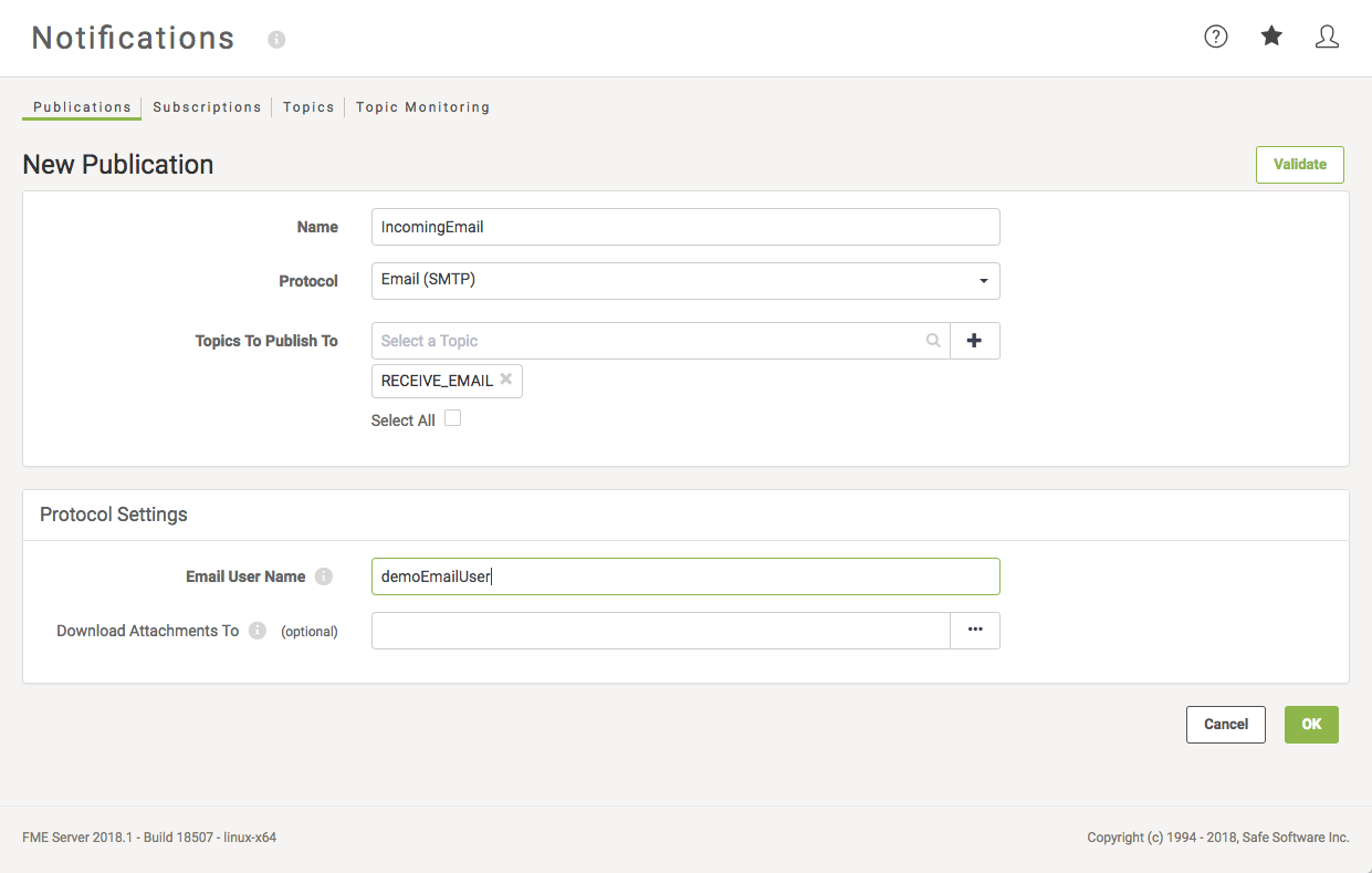

Option 1: SMTP Protocol
This service uses FME’s built-in email server, by specifying a username emails can be sent indirectly to the host, upon which a message will be sent to the registered topic we just created.
Create a new Publication, on the Notifications page go to Publications > New
Set the following parameters:
Publication Name: IncomingEmailDemo
Protocol: Email (SMTP)
Email User Name: demoEmailUser
Topics To Publish To: RECEIVE_EMAIL
Click OK, and you will see your publication in the list.
The email address is created simply by taking the Email User Name parameter followed by your server hostname:
demoEmailUser@myfmeserver.mydomain
Configure new SMTP publication with a new username

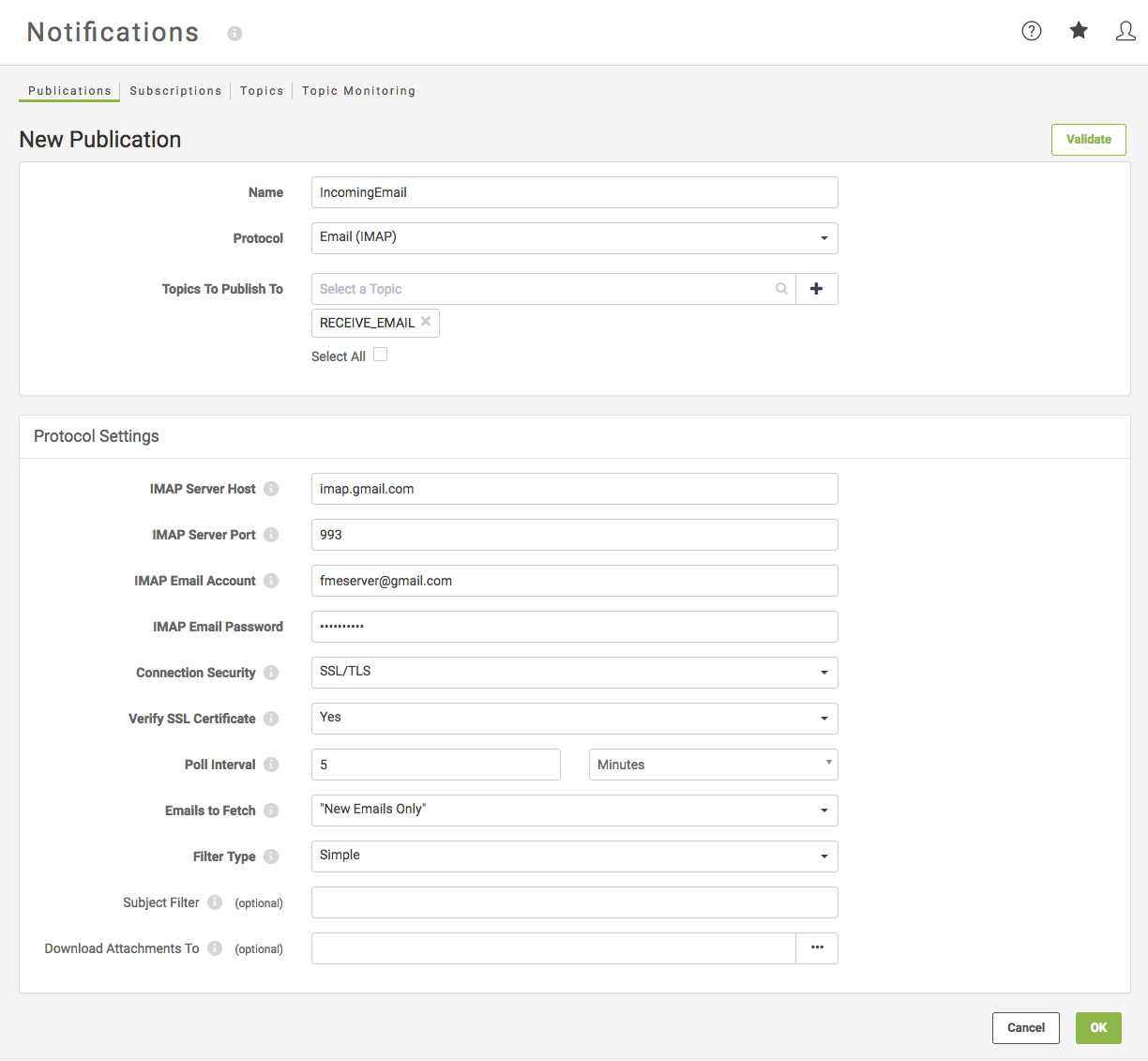

Option 2: IMAP Protocol
The second option requires you to give FME Server IMAP access to watch an account on an external mail server for incoming emails. The following example is set up to use Gmail.
Enter the parameters as follows:
Protocol: Email (IMAP)
The Protocol settings will depend on your account. SSL and TLS with basic authentication are supported for security.
Poll Interval: This is how often you would like FME Server to check the Account for new emails
Emails to fetch: Do you want to retrieve all unread messages or new emails only?
Additional Optional Parameters:
Subject Filter: If entered, only fetches emails where the subject contains said string (see more info below)
Download Attachments To: Select a location to save email attachments. This can be from within the FME Server Resources, or you can specify the UNC path to another directory.
Configure the IMAP Publication

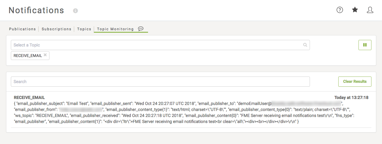

To ensure you have correctly set up the Topic and Notification, you can turn on Topic Monitoring and then send an email to the appropriate email account. If you are using IMAP, this will be your mail server email account specified in the Notification configuration (e.g. fmeserver@gmail.com in the example). If you are using SMTP, this will be demoEmailUser@myFMEServer.mydomain.
- On the Notifications page select the Topic Monitoring tab and then select the topic we created earlier (RECEIVE_EMAIL). Once the topic has been selected monitoring should be started automatically.
- In a new tab, send an email from a different email account than the one used to set up the Publication to the email used to set up the Publication, either demoEmailUser@myFMEServer.mydomain or e.g. fmeserver@gmail.com
Note: Ensure that you change myFMEServer.mydomain to your actual server name and domain.
- Go back to the Topic Monitoring page and check to see if the RECEIVE_EMAIL topic worked correctly. You might have to wait up to 5 minutes depending on the Poll Interval that was set up in the Publication.
Topic Monitoring page on FME Server
Note: You must keep this page open in the web browser else topic monitoring may be interrupted. Open a separate tab to send the email. If you have correctly set up the service a json message will be returned detailing the information related to said email.
