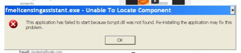

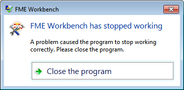

When starting an FME application, an error occurs and the software shuts down. You may see the following error messages:
The message may state that 'bcrypt.dll' cannot be found and you may also notice that other applications on the system fail to start.
