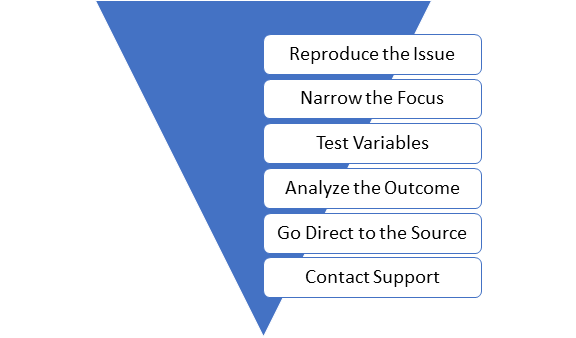

The following diagram displays the process:

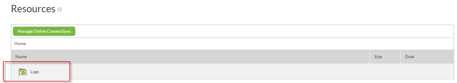

  • Search the system logs for error messages using the Resources interface:

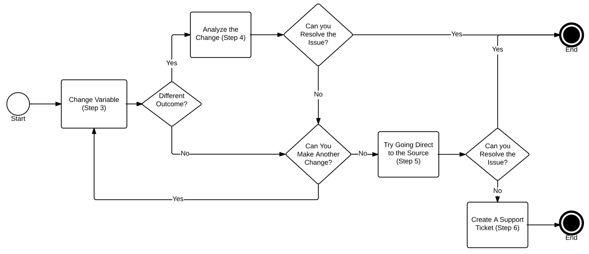

This step is designed to either solve the issue or decide what to do next. Here is a flowchart of the process:
6C-Akh3wxuUMc27IhLmIVq_1MBT4IQoWZRynUQeq_S59TChrTGUtqlhd61ctdfcrtHRjrsedBqUZZDzLbhEY7P14Qoxk99L0lnR1wo1PaZv306BpugMEDzu2Xtha_Y4OK_R6SR0o
When a specific change alters the outcome, it should help you point to a possible root cause for the problem.
