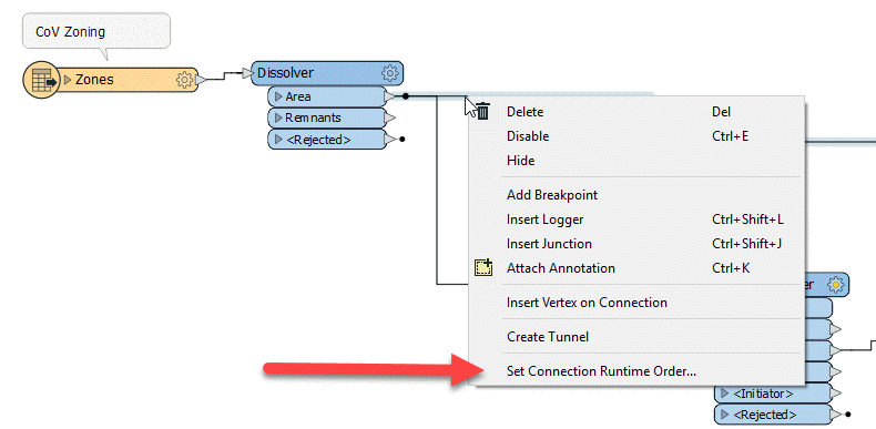

If you have multiple connection links coming out of a single output port of a transformer, you can right-click on a connection and select the "Set Connection Runtime Order..." option to determine the order the connections should fire.

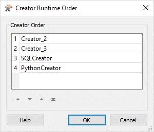

'Creator' transformers (such as Creator, SQLCreator, PythonCreator) have a similar option that controls the order they are triggered:

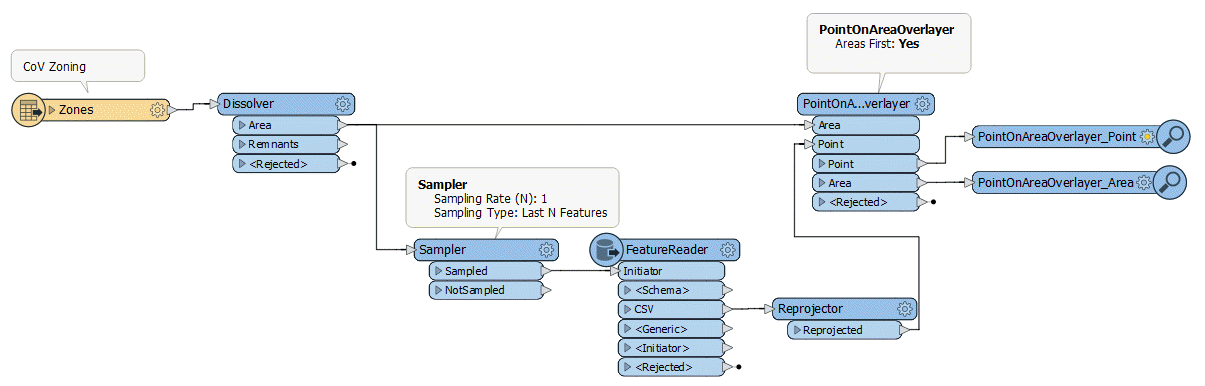

You can also use the Sampler to identify when the last feature has passed, and use this to trigger another transformer that has an Initiator input port, such as FeatureReader or SQLExecutor. Configure the Sampler with:
Sampling Rate (N): 1
Sampling Type: Last N Features
In this workspace, Sampler used in this way allows the PointOnAreaOverlayer to take advantage of Areas First, improving performance
