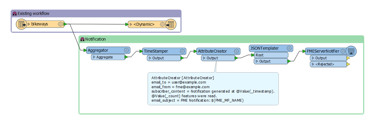

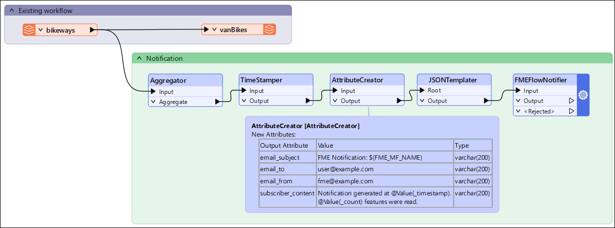

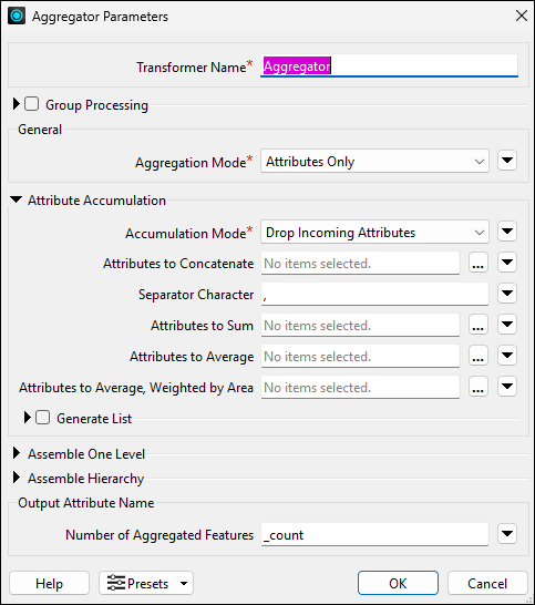

2) Branch off from the main workflow at the point where you’d like to send a notification. Add an Aggregator transformer and connect it to the second stream of data coming from the bikeways feature class. Configure it as follows:
3) Add a TimeStamper.
4) Add an AttributeCreator. Create the following attributes, with the values specified. For the full list of keywords, see the email subscriber documentation.
email_subject: FME Notification: $(FME_MF_DIR)
email_to: user@example.com
email_from: fme@example.com
subscriber_content: Notification generated at @Value(_timestamp). @Value(_count) features were read.

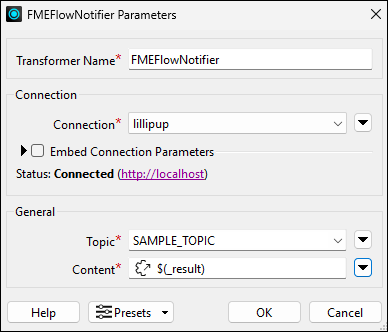

6) Add an FMEServerNotifier, and configure as follows:
Here is the completed workspace:

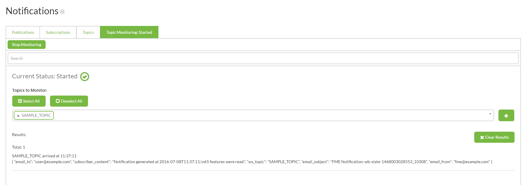

7) Run the workspace. When it is run, it will publish to SAMPLE_TOPIC. You can see the result using Topic Monitoring on the Notification page in the FME Server Web Interface.
