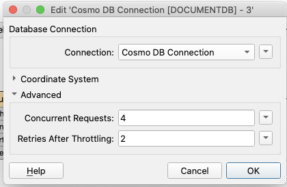

Concurrent Requests Parameter
If you are writing more than 20,000 records, leave the default concurrent requests set to 4; any higher than this, and the API seems to throttle requests, causing FME to error. If you are writing a smaller number of features, you can play around with increasing this number, which essentially parallelizes the requests.
