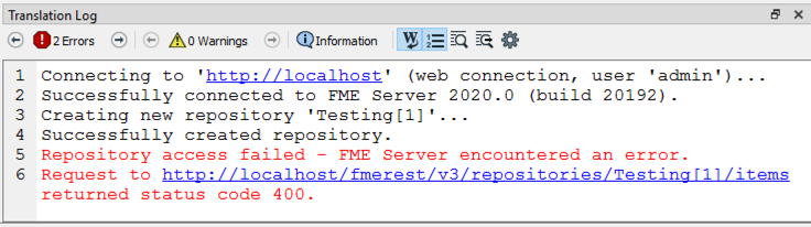

Symptom
In FME Server it is possible to create a repository that contains square brackets [ ], but the repository cannot be accessed or allow any workspaces to be uploaded to it.
This also prevents users from uploading workspaces to the repository through the FME Server Web UI.
