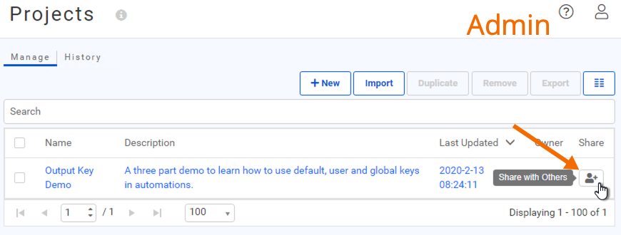

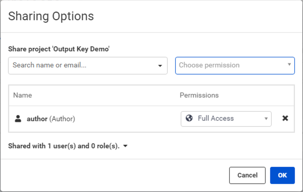

1. Share the Project
Log in as an FME Flow admin and go to Projects. Click Share next to the project and add the appropriate users or roles.

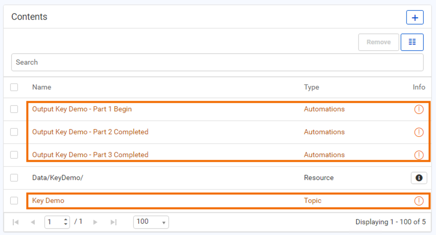

2. Share Project Contents
After sharing the project, manually share the following items as needed:
  • Automations
  • Topics
  • Apps

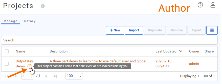

3. Verify Missing Permissions
Ask the user to open the project and check for any red exclamation icons. These indicate items that are still not accessible.
4. Update Remaining Permissions
Based on what the user reports as missing, update sharing settings for those specific items.
