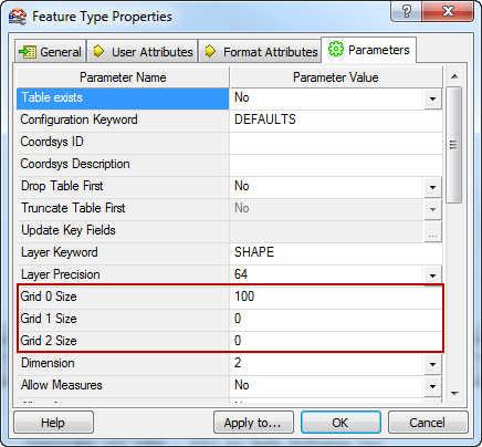

If writing to a new table the parameters grid 0, grid 1, grid 2 on the destination feature type allow you to adjust the grid size:
Otherwise, create or adjust the grid size with ArcSDE commands. The following article describes ArcSDE grid size optimization:
The Role of Grid Size Optimization in ArcSDE Performance Tuning.
