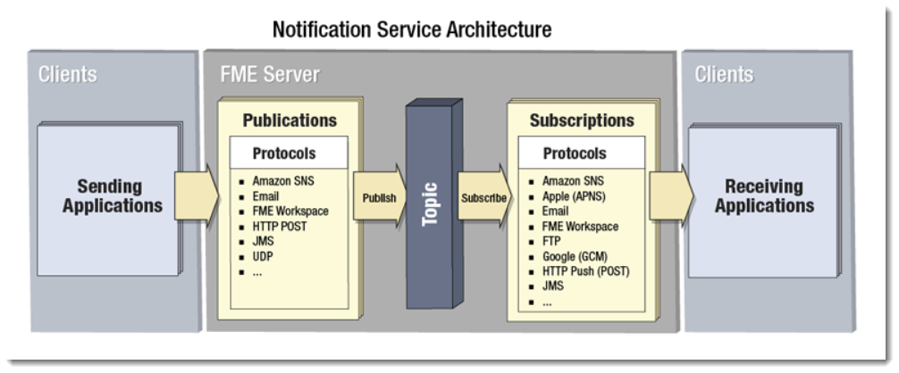

The FME Server Notification Service allows messages to be sent and received by FME Server when events occur. There are several supported protocols, which enable FME Server to communicate with a variety of applications.
The architecture, illustrated in the diagram below, is based on topics, which are channels for messages. Publishers create messages, while subscribers consume them. For example, a workspace sends a message to a topic when a CAD file fails validation. If an email subscriber is set up to receive this message, it will respond by sending an email to a specified address.

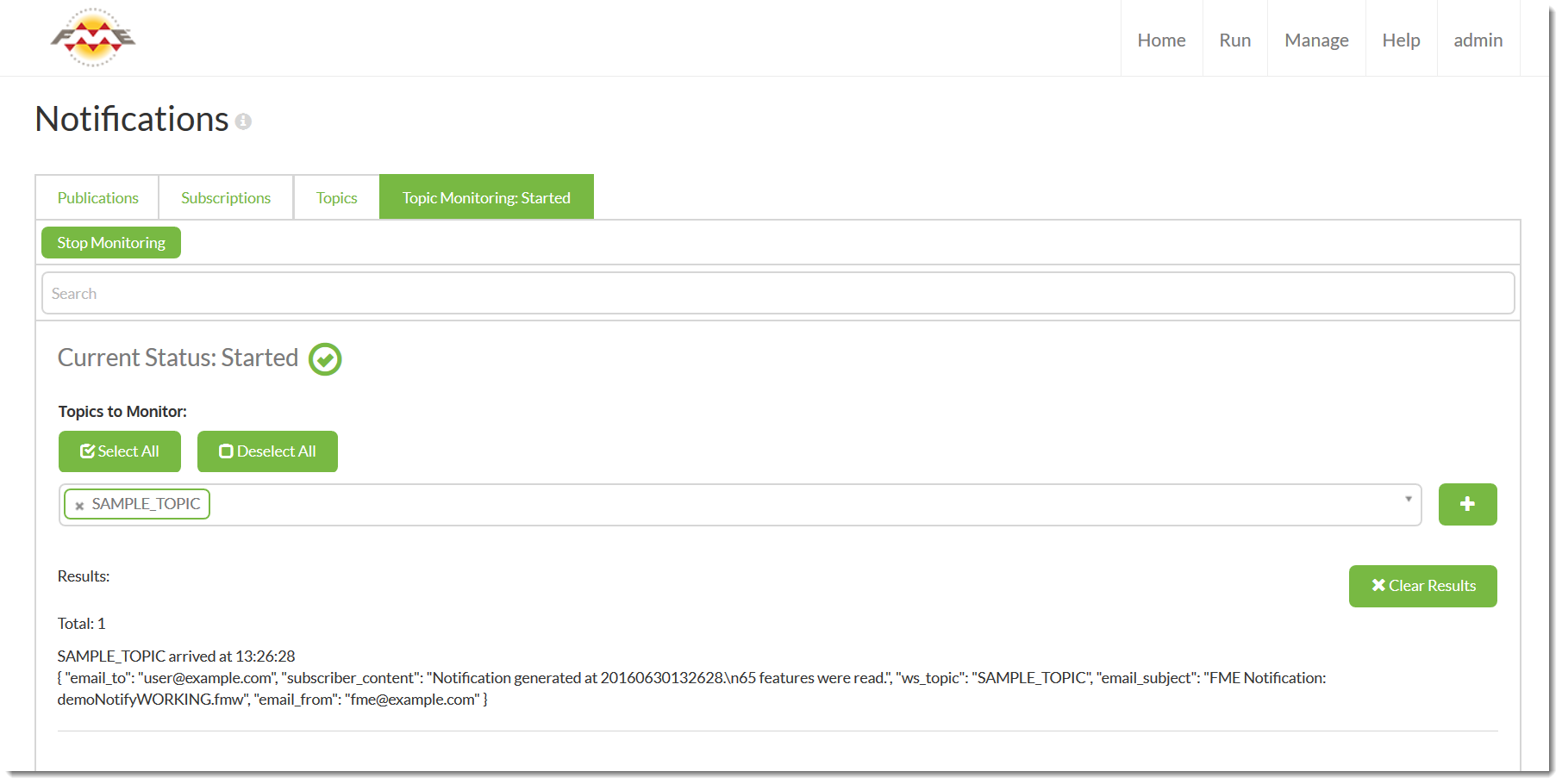

In order to see that notifications are actually being sent, you can use the Topic Monitoring on the Notifications page in FME Server:
