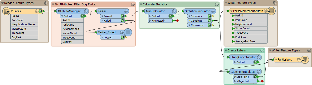

Creating Cached Data
Features are cached when a workspace is run in FME Workbench with the Feature Caching option active. Caches are indicated by green icons, which are animated when the workspace is running and features being cached.
Above, the workspace has been run and the data cached at every step.

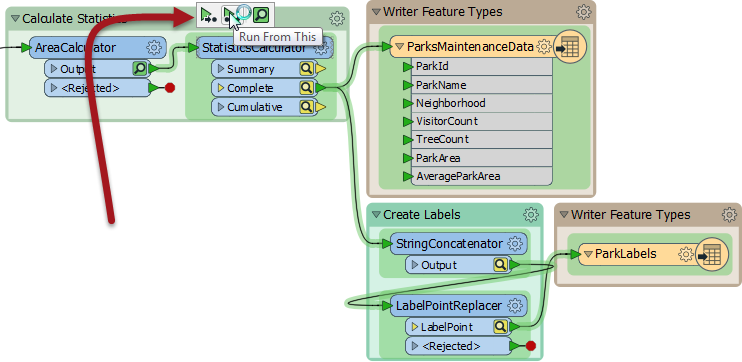

During design and testing of a workspace, it is often not necessary to re-run the entire translation. When features have been cached it is possible to use them as a data source, ignoring prior transformers that have not been affected by edits.
Above, the StatisticsCalculator has been edited in this workspace. The change in icon color shows that subsequent transformers are also affected by the change. To create the correct output, rather than run the entire workspace again, the features cached in the AreaCalculator can be used as a data source. This is achieved by running the workspace from the StatisticsCalculator onwards:
Performance Effects: Because the workspace prior to the edited StatisticsCalculator does not need to be re-run, the overall performance is much faster. The improvement in performance is directly related to the work the skipped transformers carried out. For example, much time can be saved by caching the results of a Geocoder transformer, to avoid making subsequent calls to the same web service.

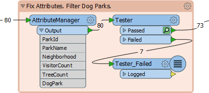

Collapsed Bookmarks

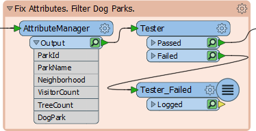

When a workspace is being run, and data is cached, each output port of a feature type or transformer is cached.
Above, for example, every transformer in this expanded bookmark caches its features.

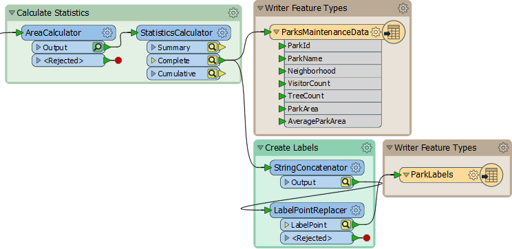

However, during design and testing of a workspace, not all features need to be cached. Sections that have already been tested satisfactorily, will not be edited further and so do not need to be cached. In that scenario, caching of every transformer can be prevented by collapsing the bookmark in which they reside.
Now when the workspace is run, only the output port of the collapsed bookmark is cached. Features are not cached for the transformers within it.
Performance Effects: By collapsing bookmarks to exclude sections of workspace, caching of features is reduced and so can be carried out more quickly and using fewer system resources.

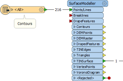

Unconnected Output Ports
Some transformers in FME are designed to create multiple outputs. In general, FME creates output only for connected output ports.

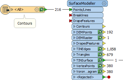

Above, for example, a workspace turns contours into a TIN surface using the SurfaceModeller transformer. Because only the TINSurface output port is connected, only a TIN Surface is created.
However, when Feature Caching is activated, then all output ports are deemed to be connected, and all outputs created.
Above, feature caching has caused all outputs to be generated, even though only TINSurface is connected.
Performance Effects: On the one hand, this is a useful feature that allows the user to inspect different results without having to connect their output port. On the other hand, the process takes longer and uses more system resources; not just because more data is being cached, but because more calculations are taking place to generate all of the different outputs.

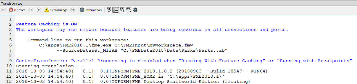

Parallel processing is a technique for using multiple processes to improve performance. This is often achieved using a custom transformer. However, parallel processing in a custom transformer is not permitted when Feature Caching is activated.
Performance Effects: Although Feature Caching can save time using "partial runs", it causes the loss of any performance gains achieved through parallel processing. The workspace author must balance the benefits of each technique and choose which produces the best performance.
