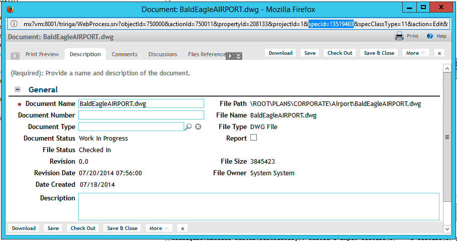

However, in the Tririga interface, the file's File ID/Record ID is not obvious to the user. The method I use to find this ID number is to open the file information window and examine the URL.
The Record ID is shown in the URL as the specID (highlighted above).
